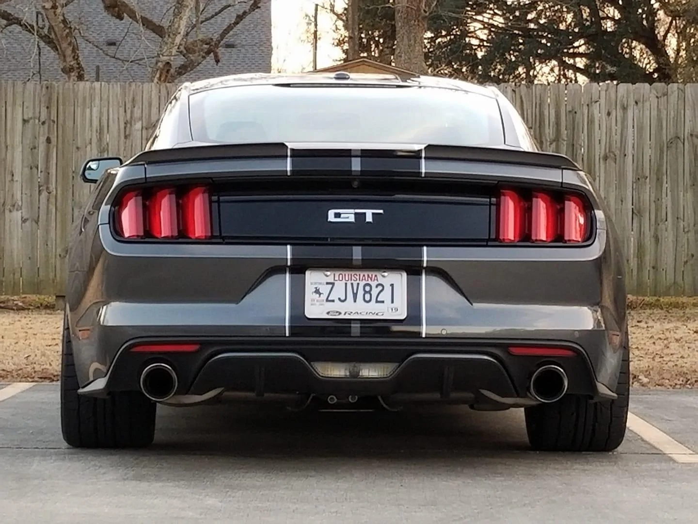

I have 10/11 rims and 285/305 wheels. Never had rock chip issues.

Love that look!
What Rims? And I'm guessing 20"... Looks a little lowered to?
CEHollier
Sep 6, 2015
81
1,570
707
Prairieville, La.
Charles
2015 GT Premium Magnetic
Love that look!
Thank you. BMR SP 763 minimum lowering springs. 19 inch LMR rims. 11/10 305/285

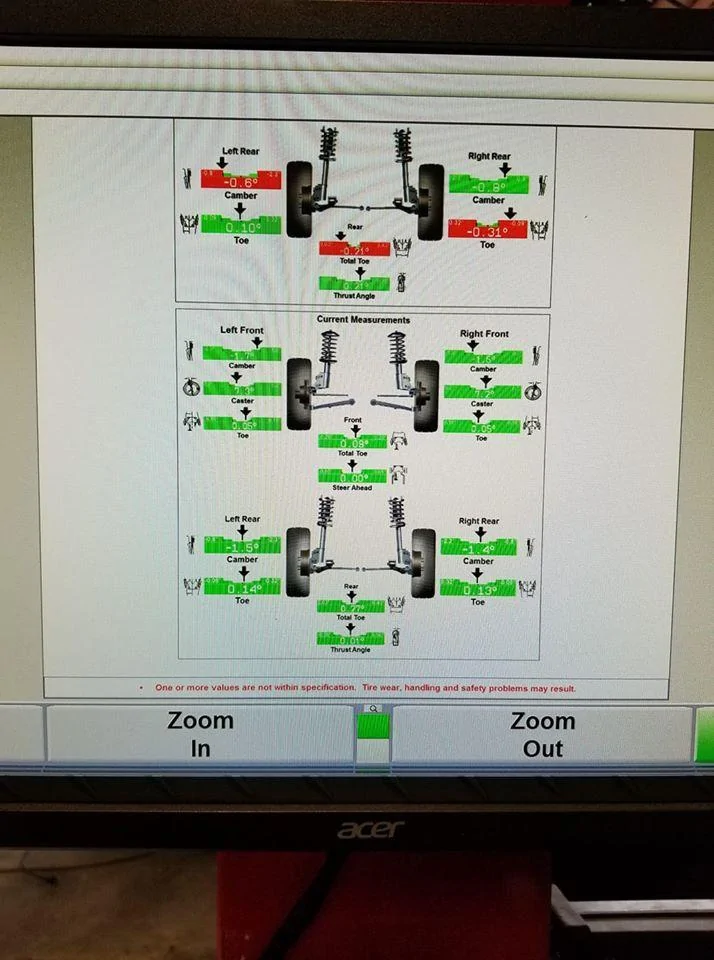

How much camber are you running out back? That can make a big difference.
Yes it can. Around -1.5 works best for me. And is well in spec.
