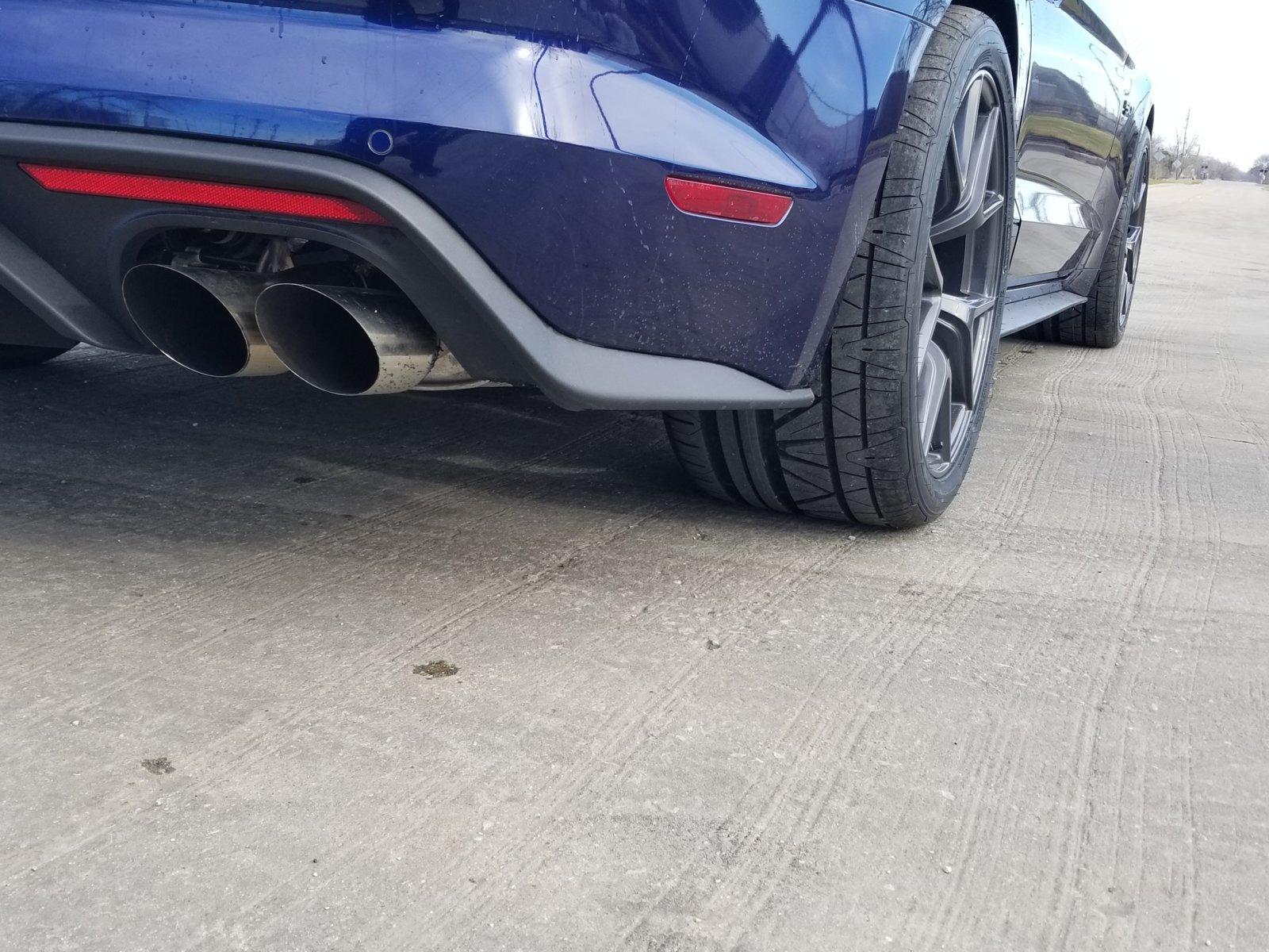

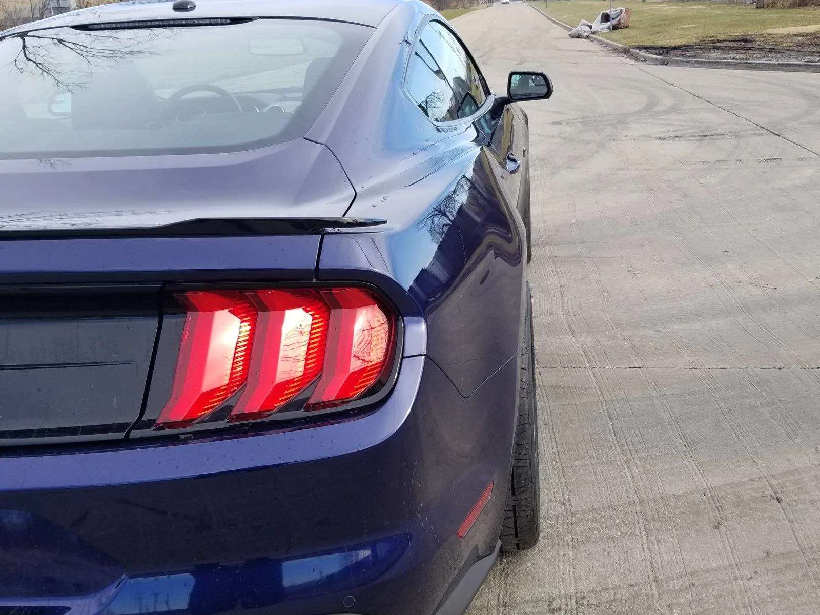

He doesn't want the stone chips from tires kicking up rocks. I'm concerned with that too. This is just water spots/dirt on mine but an example of where the tires throw dirt/stones.
