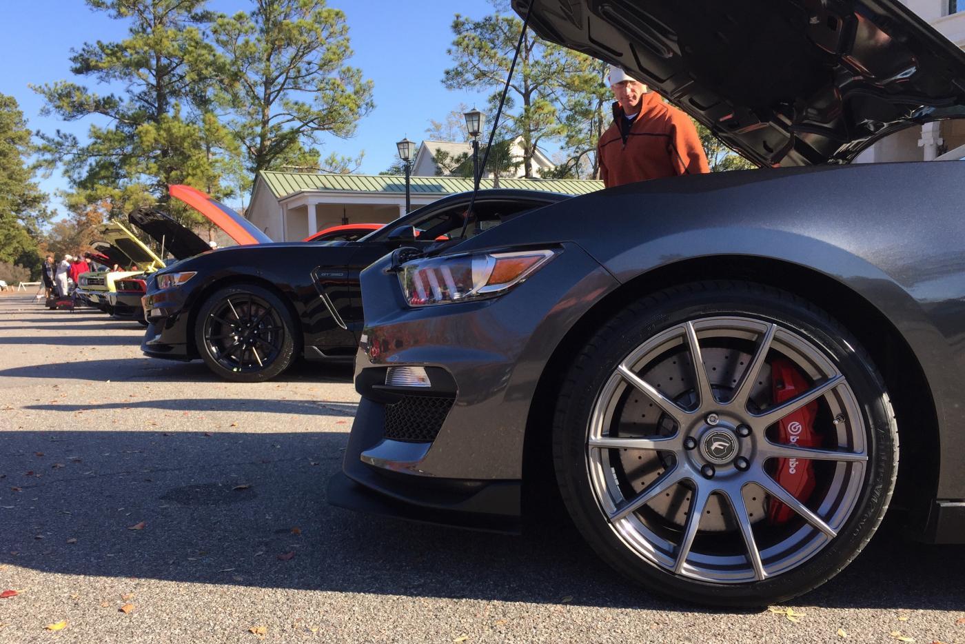

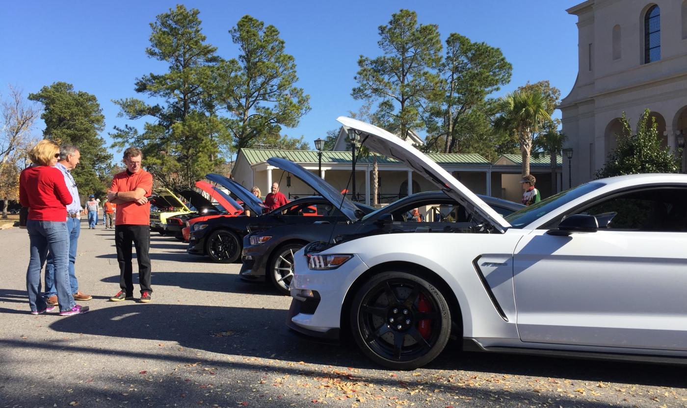

These are the wheels I went with. They are Forgestars and weigh around 25 pounds front, less in rear. I'm only out a little compared to forged wheels and these will do fine for what I want which is a good street tire/wheel combo.
The problem you WILL run into is the lug/stud issues with the R. I am presently working out an open lug/stud arrangement that will solve my issues as I like the open lug look that the Utah FRP school cars have.
I'll have more details when I have that figured out in the upcoming days.
