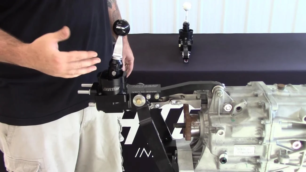

Their linkage is still designed after the stock with the flex/pivot point on it, if I'm not mistaken. It might replace it with a bulkier option, but it's still the same design nonetheless, whereas the MGW has a solid piece with no flex/pivot point on the linkage.
Again, research.
The flex point is for the body mount. If you don't body mount, a bolt goes in the flex joint and it will no longer "flex"
armykyle1 [HACKED ACCOUNT
Mar 20, 2016
74
1,849
625
Gulf Coast
2018 GTPP premium
It is a flexible linkage that can be locked with a couple bolts. The thing that weirds me out a little is their solid mount arms attach to the transmission mount instead of the transmission itself. That mount is connected through rubber and known to have play. I'm sure they are much smarter than I am but it seems a like an odd choice.
It goes to the top of the mount which has no flex. It's literally bolted to the transmission

Even that piece has play. Boomba makes replacements that
That have two different levels of stiffness above the stock piece. I'm sure it is fine I just prefer the absolutely solid point the MGW uses. Either Trans mounted choice will be better than stock or just a handle and bushing.
I guess you don't understand. The bolts go into the transmission. It can not flex. It doesn't mount to the bottom part of the transmission mount. The flex of the transmission mount has nothing to do with the shifter.
