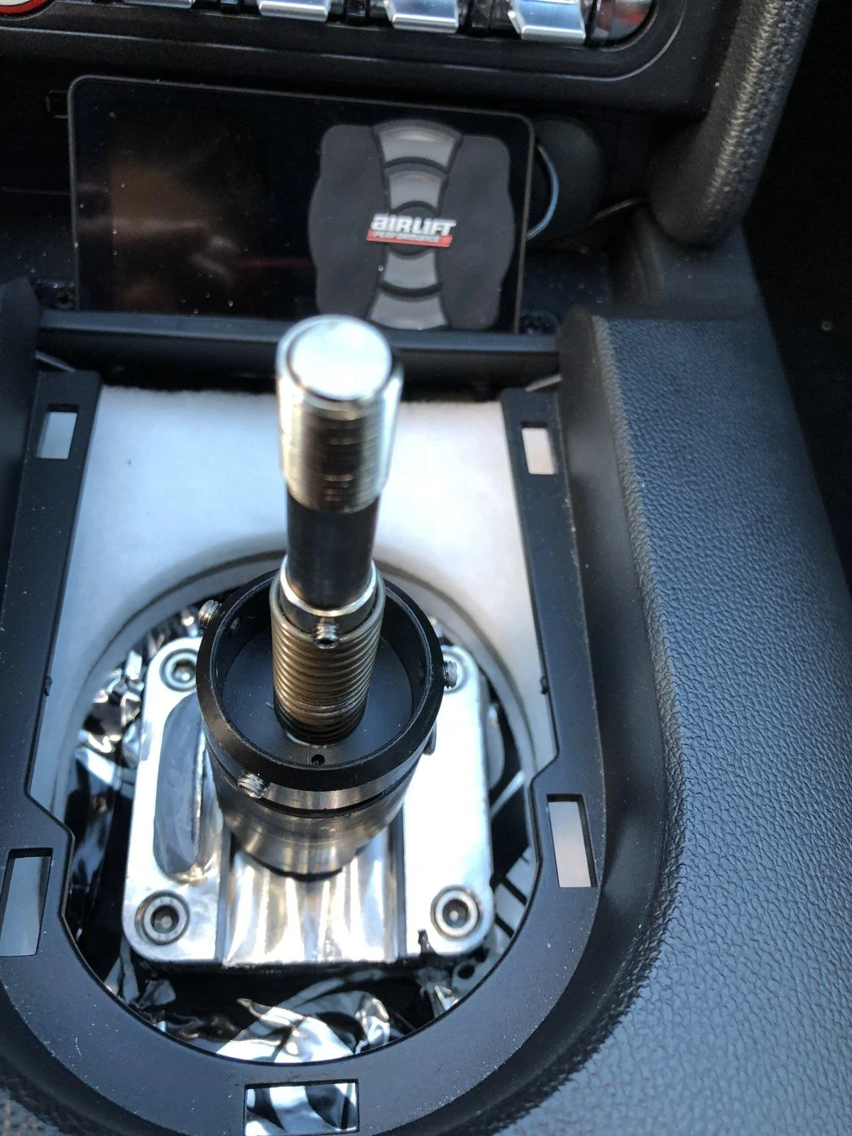

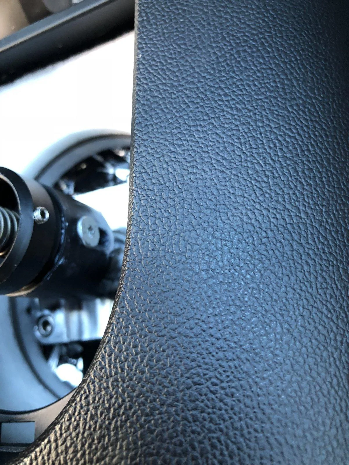

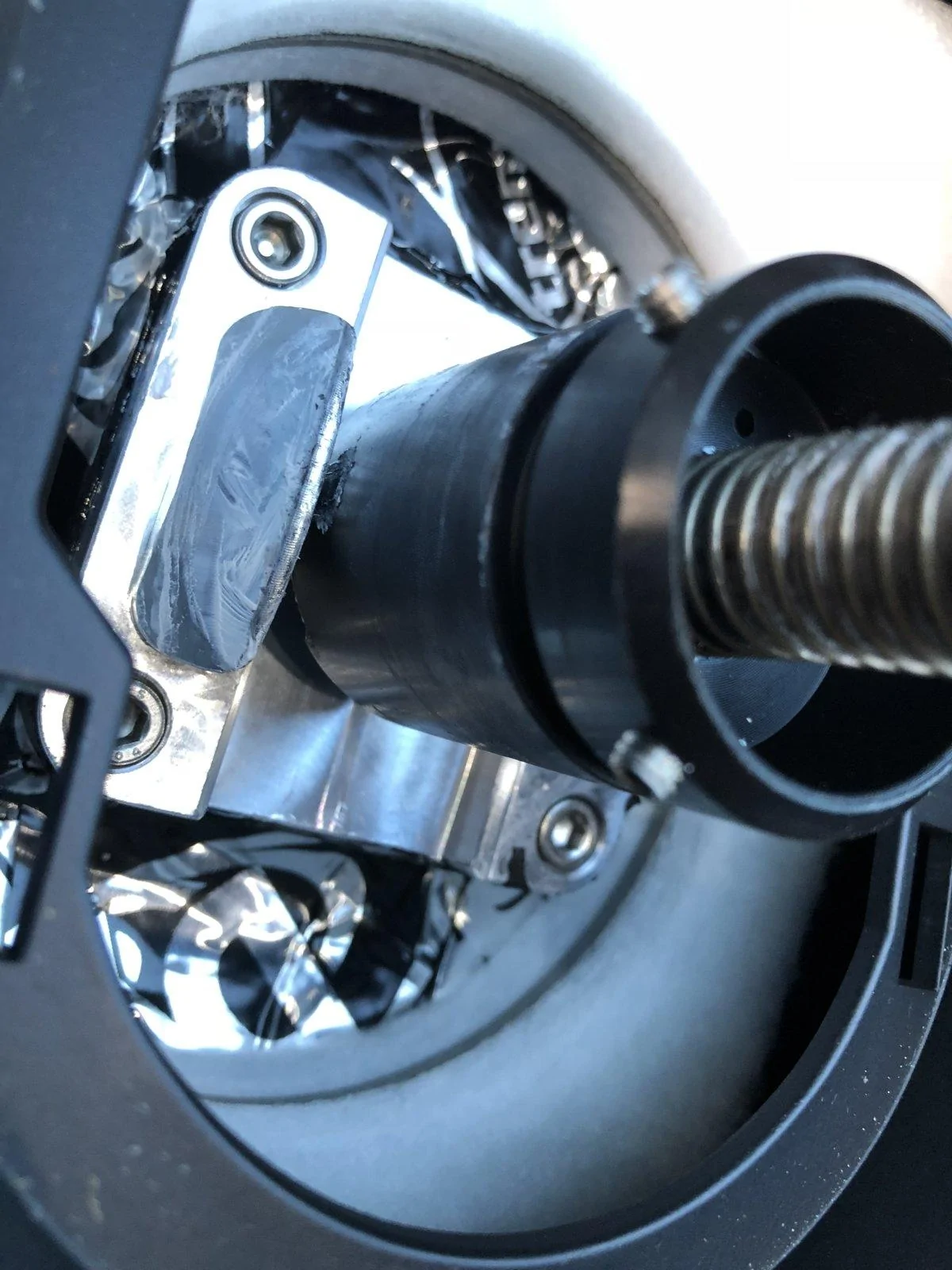

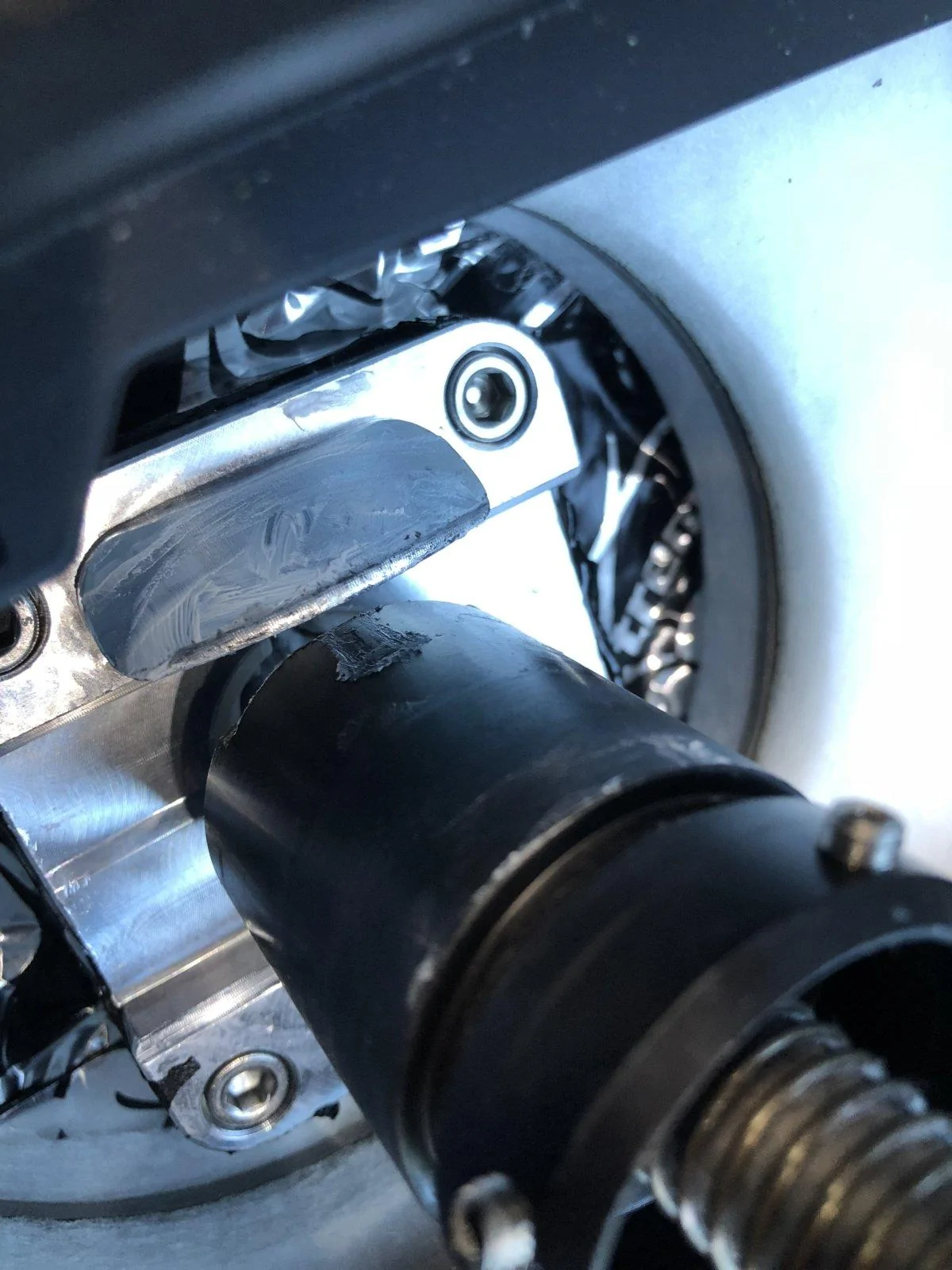

So I just installed the Steeda Tri-ax race shifter in my 2015 pp gt. Everything went pretty smoothly or so I thought. I cannot get the car into first or second gear unless I really force it. Or if I pull up the reverse lockout collar it will go in no problem. I drove it around for a few minutes and as you can see it started to melt the lockout collar. All other gears work fine. Help ! Thank you.

I bought it new online but it was old stock they made a revision to the lockout collar size 3 years ago and I had one of old ones so they replaced the lockout collar the latest revision and that resolved the issue. The shifter is awesome super precise and positive shifts with a nice reduction in throw. I would highly recommend it. I also did the trans mount bushing while I had it apart.
