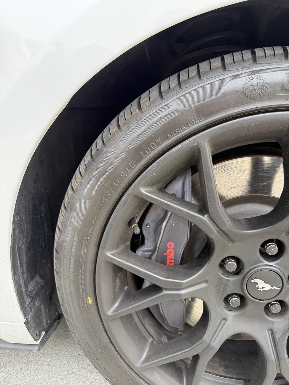

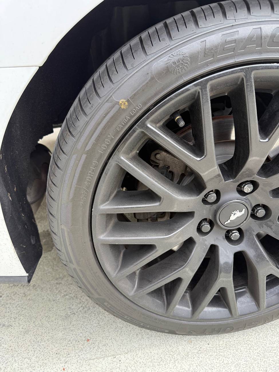

Hey guys, just got my hands on a 2020 mustang gt pp1 w/magnaride a month ago and realized the car has different wheels in the front as to the back. Back are regular pp wheels and the fronts I’m not even sure if they are oem. Been looking into squared set ups and from the research I’ve done here it looks like a good set up would be 19x10 +35 offset. Certain online retailers mention that certain wheels aren’t even compatible with magnaride so def feel as tho I’m limited in options bc I don’t want to run spacers. Definitely prefer 10+ spoke wheels as I don’t really like the old school 5 spoke designs. Any help would be greatly appreciated!

I think they're both stock Ford wheels.
If you have the PP1, the wheels with lots of forks are likely the original wheels. The ones with less forks look like the ebony painted optional wheels.
In original form the PP1 should be staggered with 19x9s (255s) up front and 19x9.5s (275s) back in the rear. I'm guessing prior owner squared the wheels to reduce tire cost. Sold the 19x9.5s and bought the different ebony painted 19x9s.

Your front wheels are the ones used for EcoBoost PP. Your rears are the GT PP…they are different.

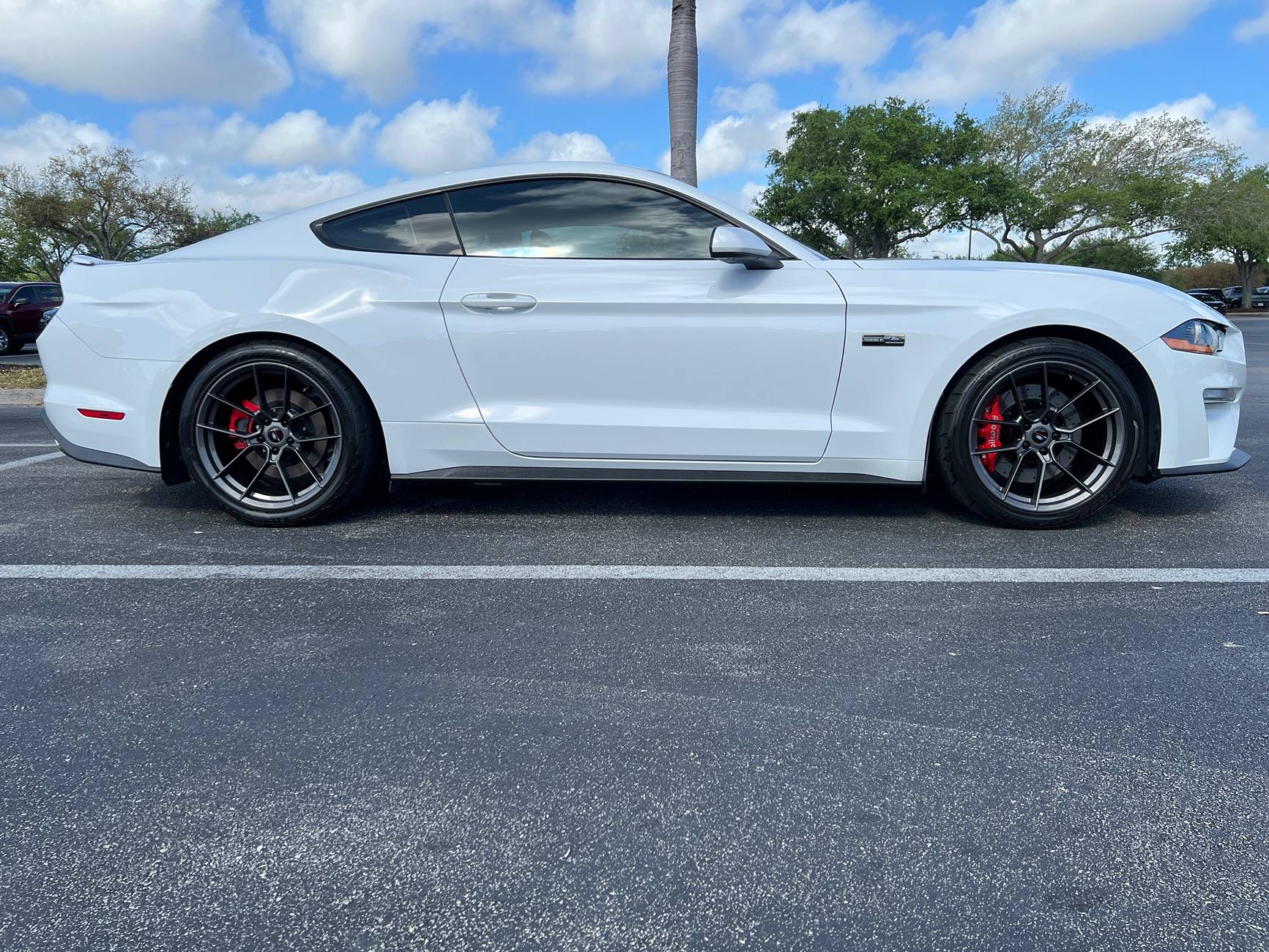

Go over to Late Model Restorations and look at their wheel and tire packages, I purchased a set of staggered 19X10 front and 19x11 rear SVE DHP1 Forged rims in Gloss Graphite with the Firestone Firehawk Indy 500 tires 285/35/R19 front and 325/30/R19 rear. They look great on the car and the tires are awesome.
My front rims are 19x10 with a positive 35mm offset, the rears are 19x11 with a positive 50mm offset.
