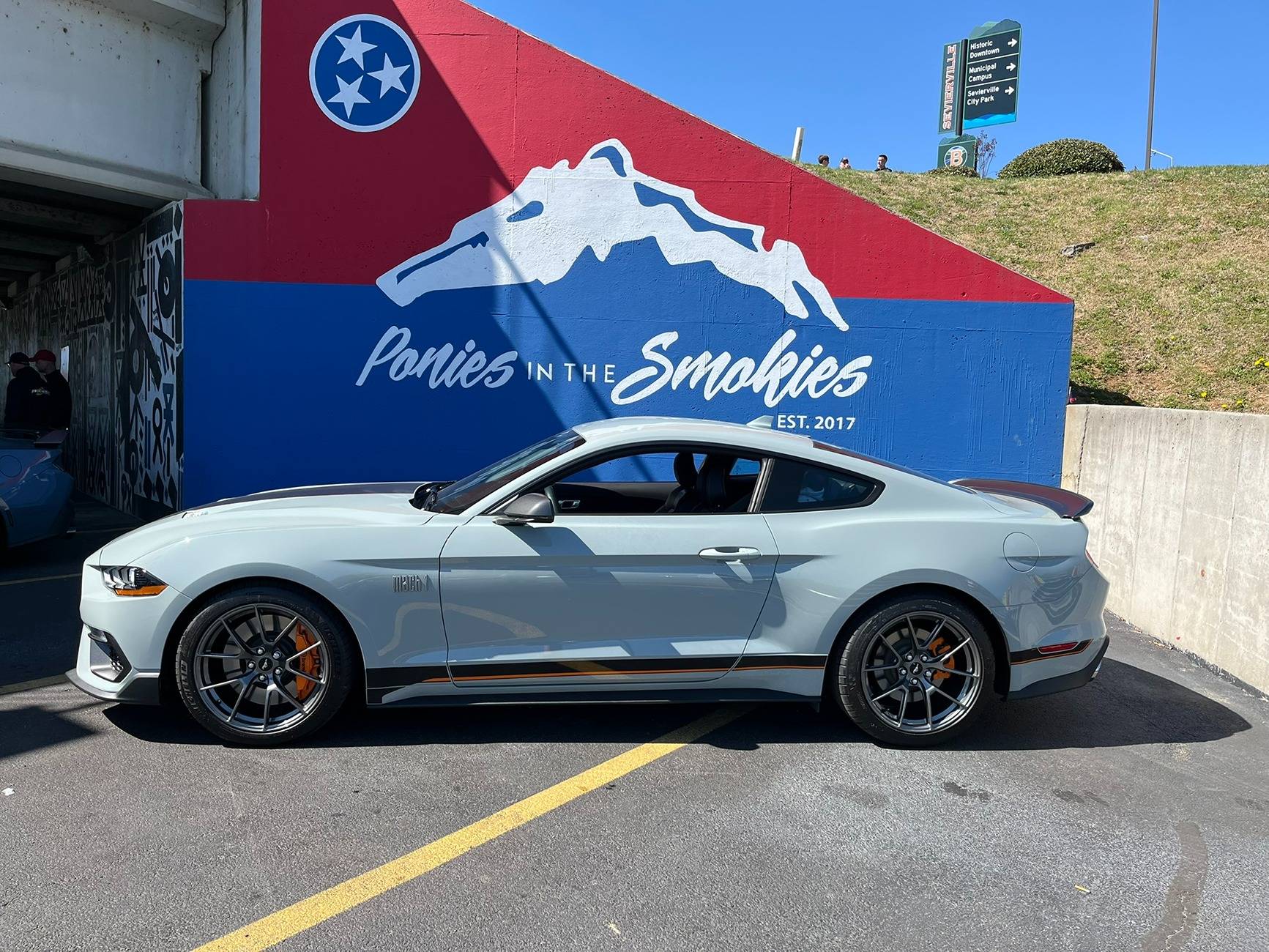

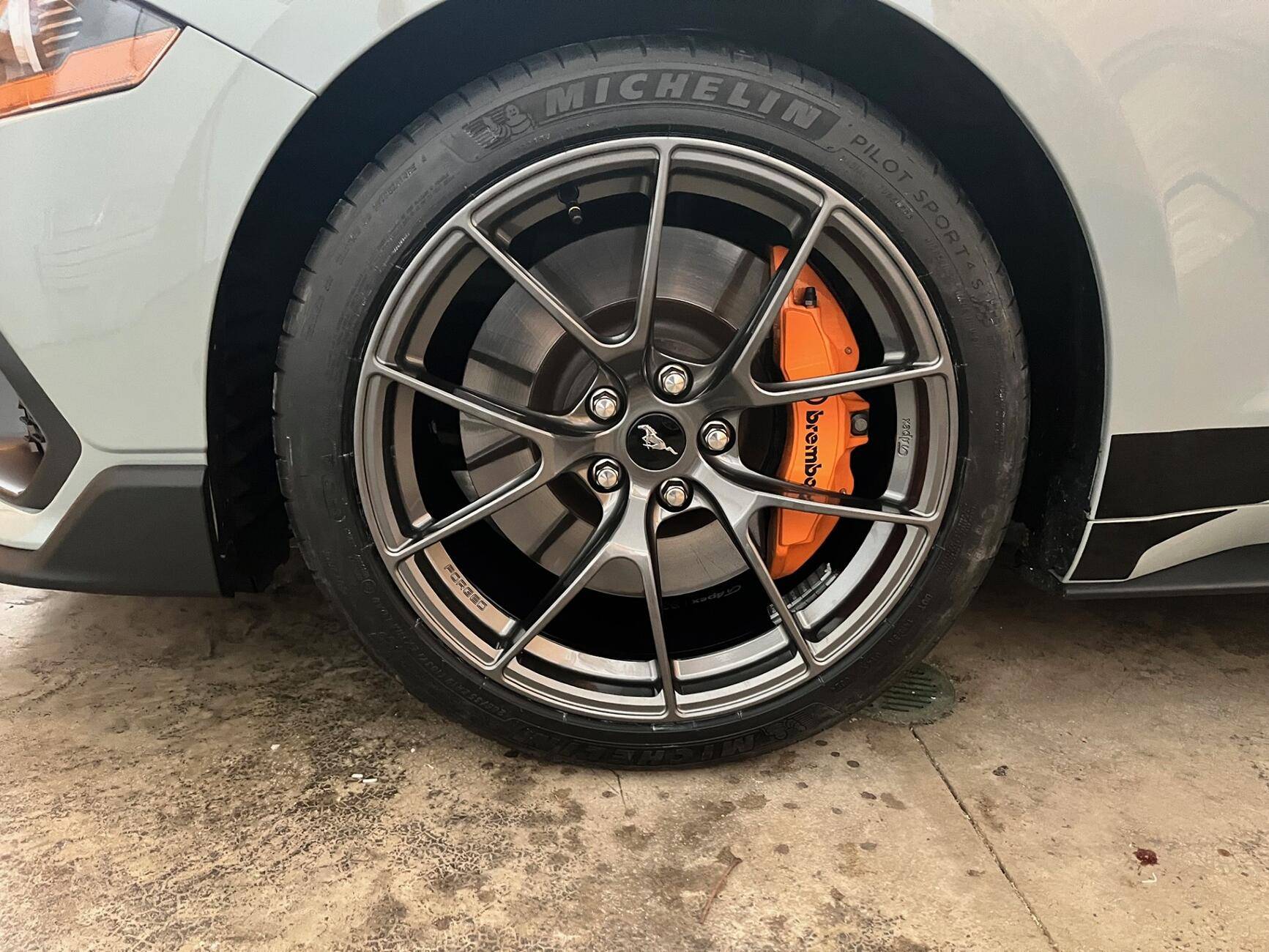

Ohio_Pilot1980
Apr 20, 2024
103
252
Mid Ohio
Nathan
2023 FJG Mach 1 Non-HP, 2018 F150, 2014 SHO
I'm a fan of @Apex Wheels, super nice, well-made and they have different constructions to meet your budget whatever it may be. I have the VS-5RS.
