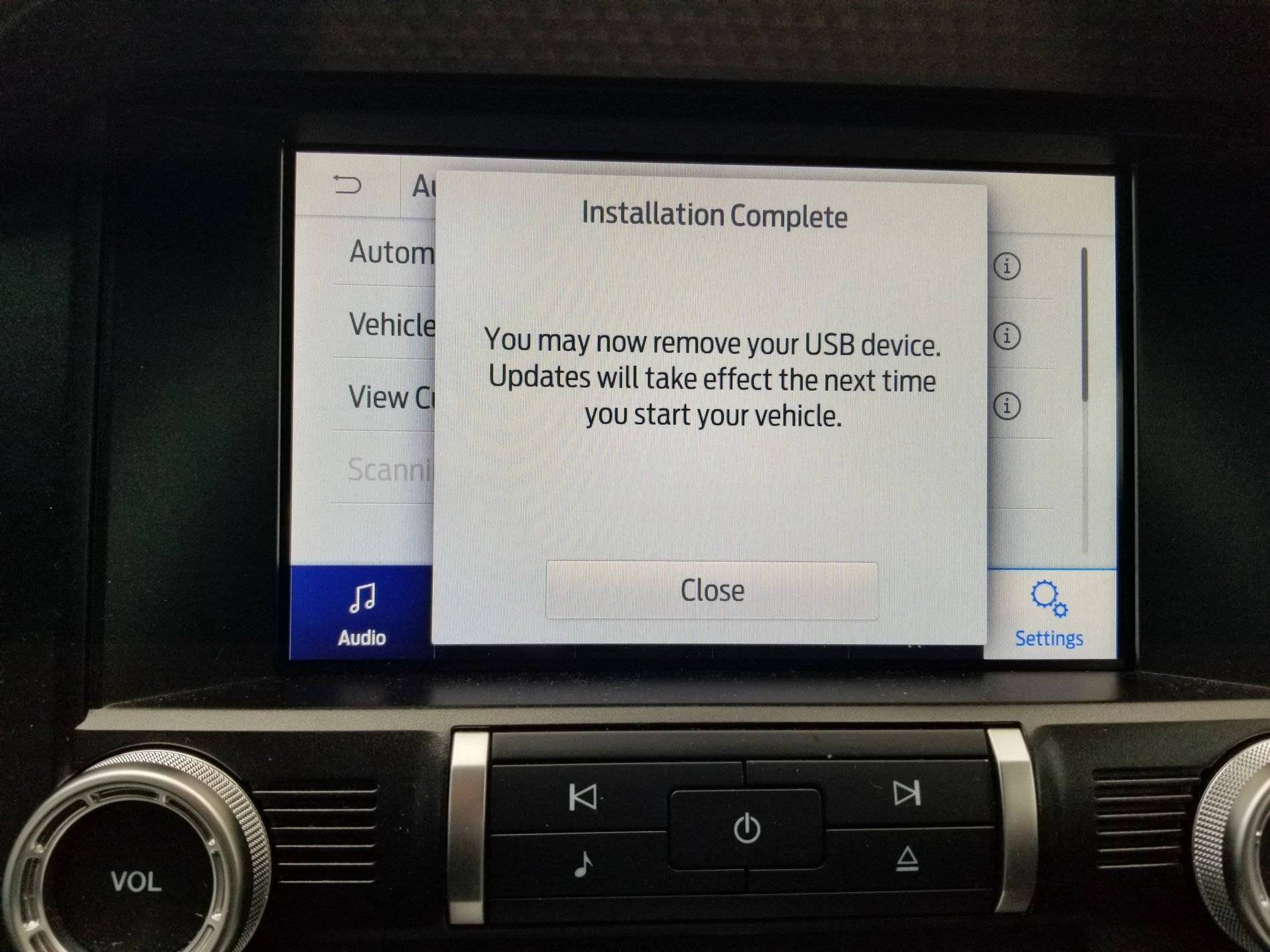

Did you pull out the usb when it told you it was okay to remove? When I installed the maps it told me upgrade successfull many times but the last time I got this prompt. I did notice that while it was updating I tried voice control and it didn't work. Once it told me to remove usb and I restartedthe car then voice control started working

For me it was about 2 hours then I got the you can remove USB message

In the directions they sent me they said it will restart several times and only remove the USB when the message won't go away on its own. After that voice still didn't work until I did a master reset.

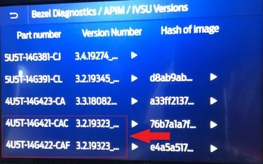

You need to check your IVSU screen....
Those are the files for 1.19 nav and corresponding nav voice on 3.3

FWIW - I have the latest Sync 3 version on my 2016 GT Premium, I ordered the USB for $149, then shortly got the email, that a revised version was on the way, so I waited a few days to get that one. I installed while driving around in a state park, it took 37 minutes until the final "remove the USB" message. Everything works correctly, including voice commands. it shows map version 1 19. Good luck to all!
Here is what I have when I get to that screen (2016 GT)
Version is Build 19205_PRODUCT
Navigation maps Version: NA 1 19
