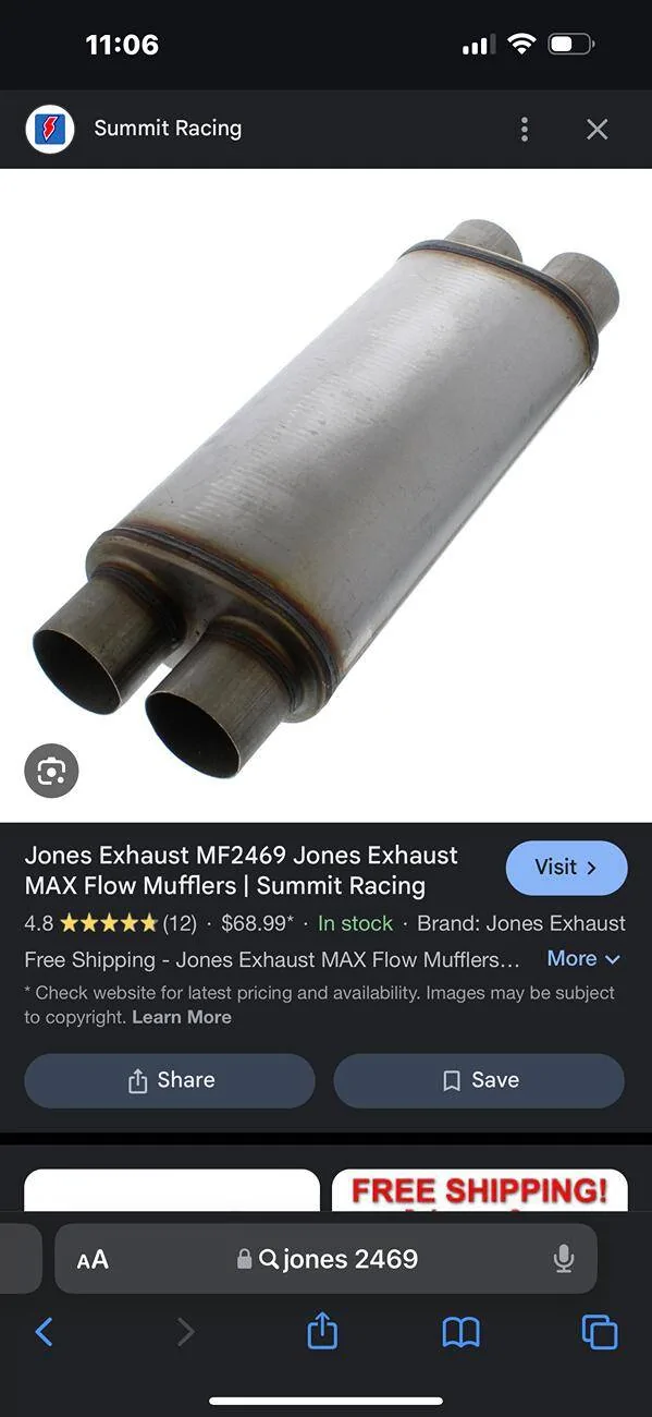

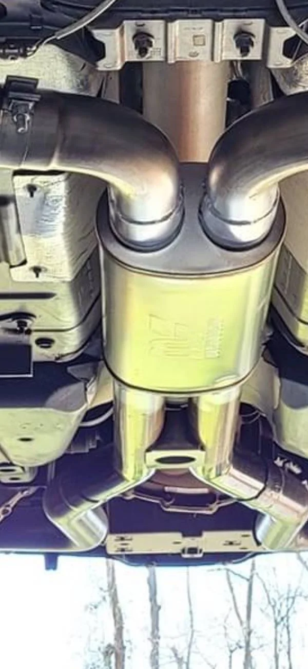

I have O/R longs and I had my stock resonator cut off and the jones max flow true dual 3” X resonator welded in…
Quieter than stock almost, car has such clean crisp tone now… ZERO loud ass sounds
The install pic is from another member, I showed it to the shop as a guide

That is an excellent idea! Would love to hear sound clips.
