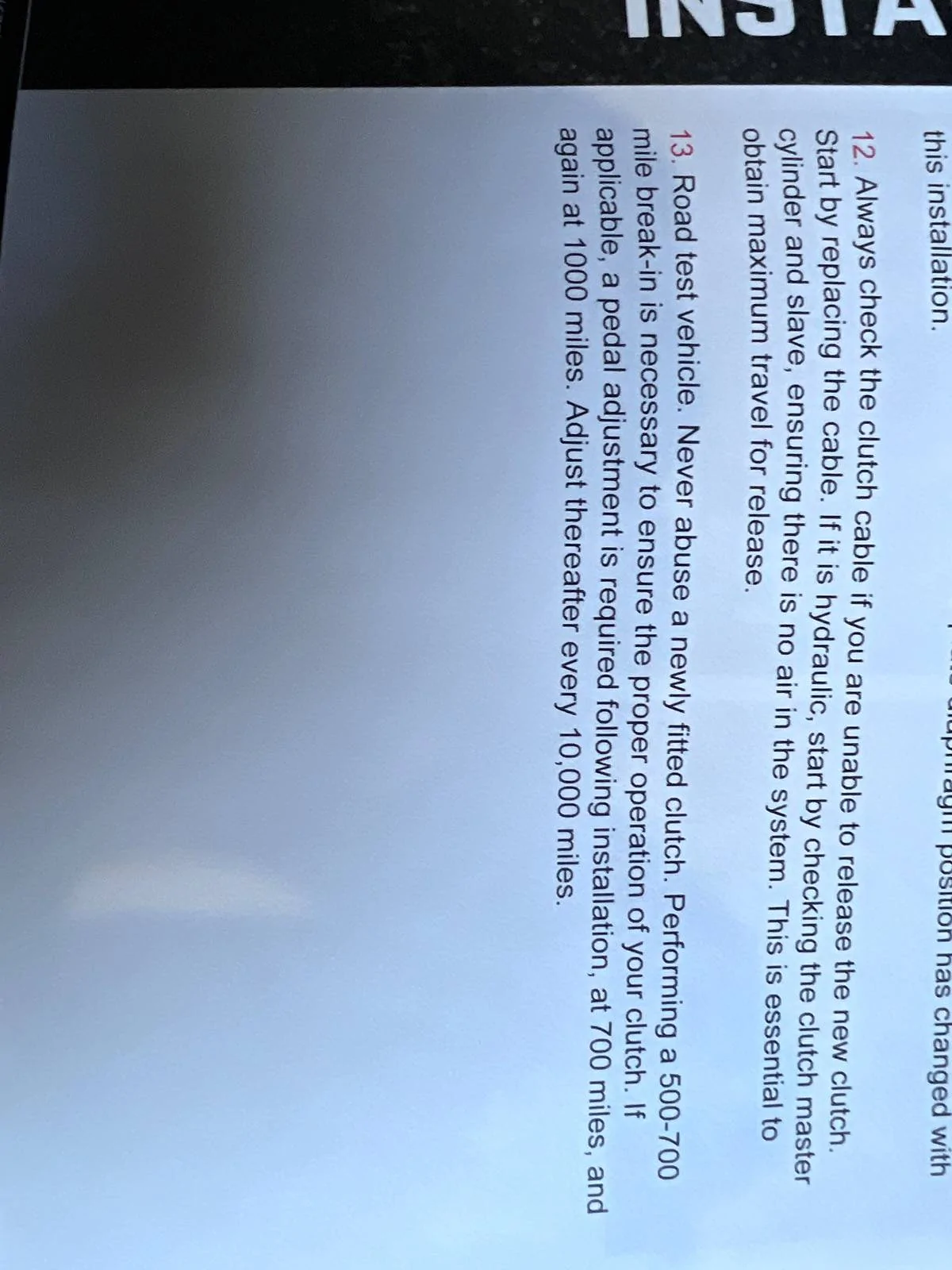

Here’s the recommendations for a vengeance clutch I am currently putting on my GT. I plan on doing more than this though.
MHW100
MHW100
Oct 1, 2022
67
Nanaimo
Matthew
2017 GT350 gen 2
Thank you. That seems to be the consensus for aftermarket clutch’s I’ve see as well. I double checked with the Ford tech I know fairly well and he checked their data and found no such similar warnings.
