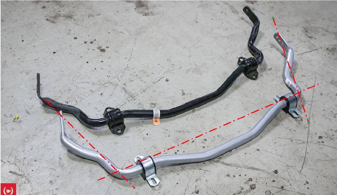

Well here is a chart with the different bar diameters
https://www.mustang6g.com/forums/threads/sway-bar-size-compilation.80809/#post-1817592
somewhere in the forum exists a stiffness calculator. Being that sway bar is part of a system, the performance gain/loss would depend on other components such as springs.
There is an approximate formula for estimating sta-bar stiffness from the bar's basic dimensions here - Sway Bar Rate Calculator | GTSparkplugs . It's based on Fred Puhn's formula, which typically over-estimates the stiffness by 5% or so, partly because it ignores a number of smaller effects (like the distance between the supports being different from dimension B).
You'd have to approximate your actual bar to the calculator's inputs like this, measuring to the hole pair you're going to check. The effect of the bends being of a radius isn't clear without a full 3-D finite element analysis (that might well provide unexpected results).
I think for most adjustable bars, there's about an inch between the holes.
