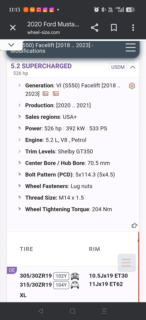

Since I am having the rears re done..I was thinking of going 19x11 and keeping the 315 40 tires ( the eagle F1 is a nice tire) it's the offset I don't want to mess up..any recommendations or calculator..

wheel-size.com use their sizing calculator and play around with the wheel/tire combo you want to try. Plug in you original specs for an accurate comparable...

Ok so.here is my stupid question.if the gt350nisnrunning a 19x10.5 et30 which is what I based mine on but a 305 30 19 tire why does mine look so bad.i know my tire is wrong on it now but the poke. I see it's the fronts .
Yes its a Front wheel. They have different spacings. Look at the rear specs. Your 30 is 32mm more outboard than a ET62 on the shelby
