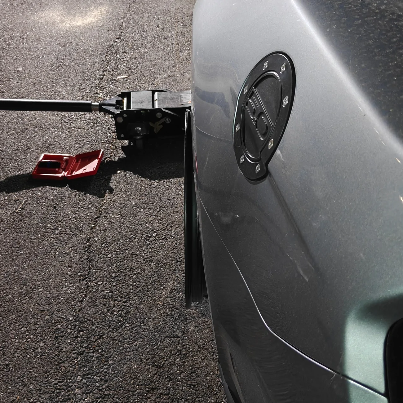

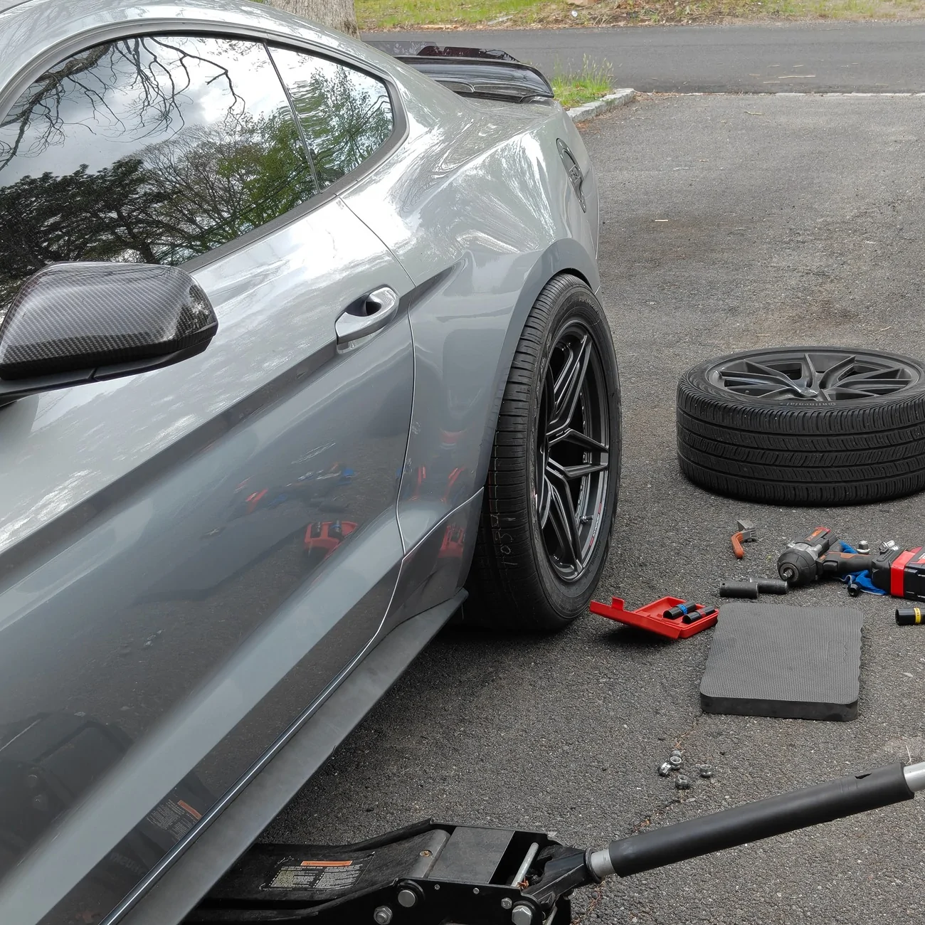

So I ordered have custom offsets and I adjusted the rims at the last minute and did 10 and 1/2 rears with a plus 30 offset in front are nine and a half with the 24 offset when I was putting them on I noticed the poke from the rears I haven't touched the front yet any ideas on how to fix this or should I just sell them and start over.
Rear tires are Eagle F1 315x40x19

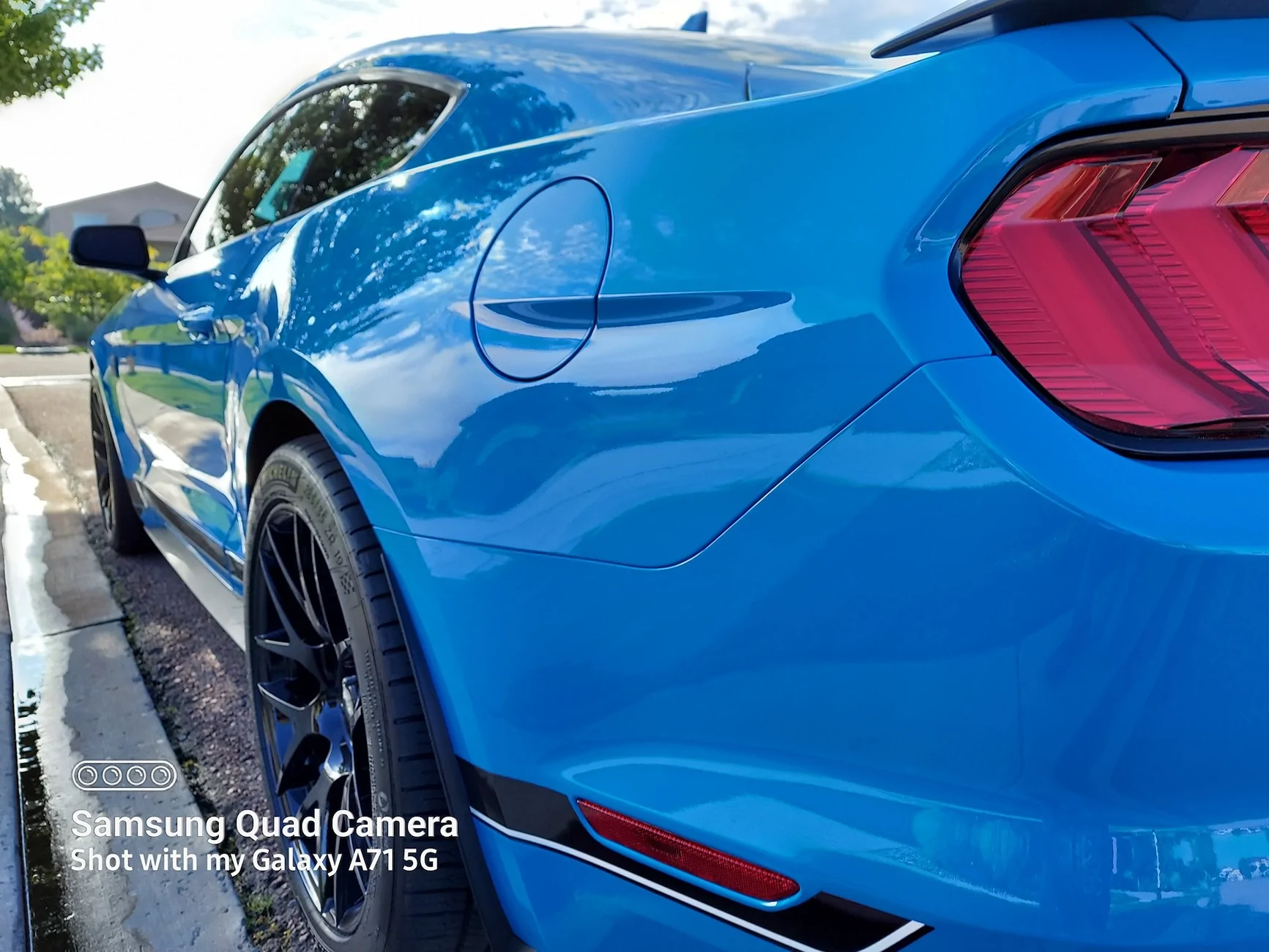

I'm using a 19x10, +35 rim in the front and rear of my Mach. Attached is a photo.

Needs more positive offset in the back.
if you had too much you could remove some with a spacer but you can't fix that without getting a new wheel

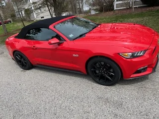

I just added 275/40/19 all around... Fills out the wells, ride is great, perfect fit...
