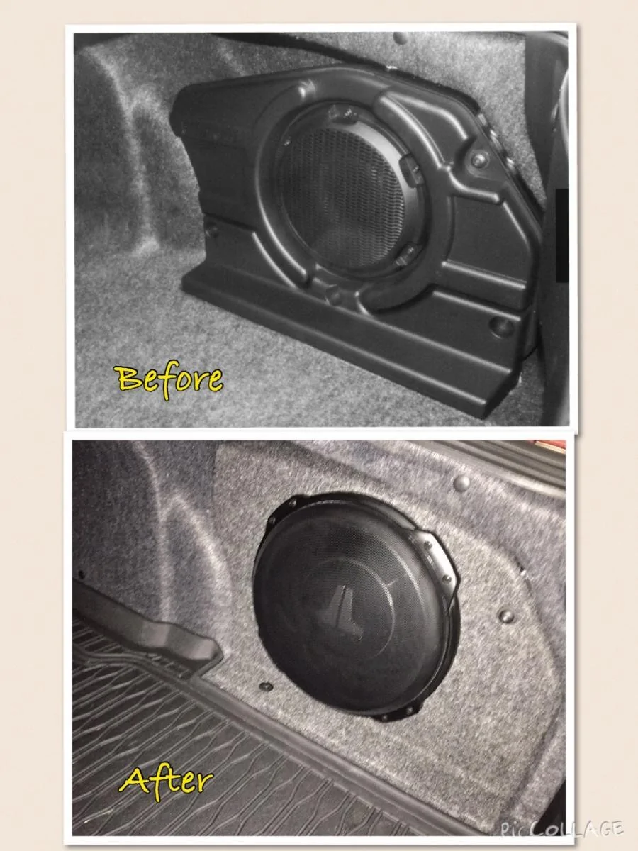

Check out the stero build and pictures of Klumpikat that she posted last week. Sorry I cannot point you to the specific post.

Thank you for the link. Very clean mounting. :thumbsup:
I see you have the 401A so I expect my wiring will be a tad different if you used the wires from your stock sub.
I've decided against using a line out converter, opting instead to run the wires from the factory amp input harness since I expect I'll be re-wiring the factory speaker locations in the future.
Ah, I noticed after the fact you have 400A, so yes, I would imagine it would be a bit extra work. I paid someone to do mine; I don't know the first thing about this stuff, but you are already halfway there. ;)
I am very interested in seeing the results of your installation of the subs behind the rear seats. :cool:
