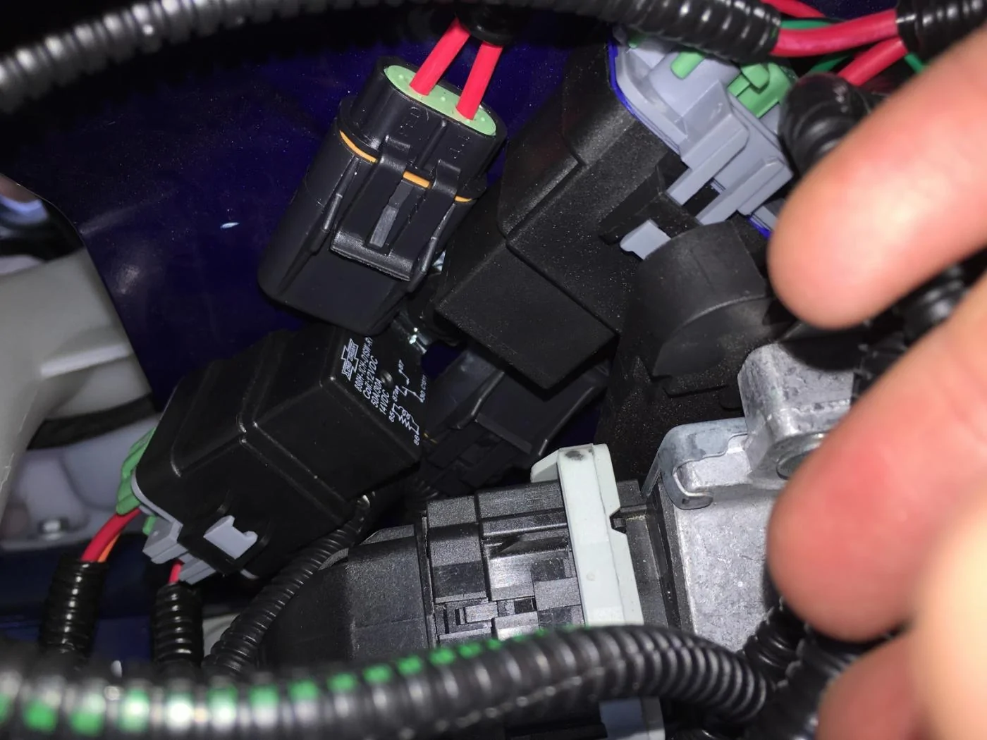

Here is a picture. There are 2 relays and 2 fuse holders mounted there per the install manual.

You need to follow the trigger wire. All kits with intercooler pumps and fans need fuses and relays.

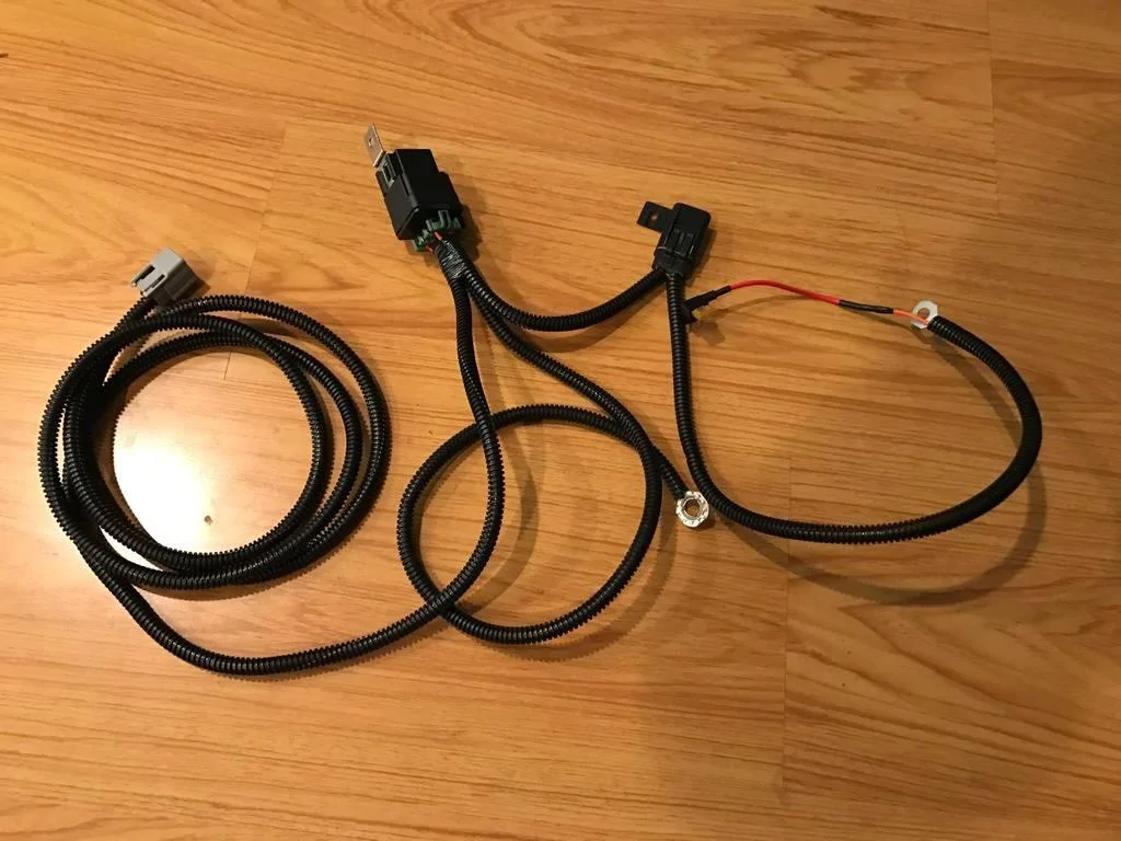

So for those of us with the Competition Kit, are we to tape off all (4) connectors at the back of the block since we will not tap into the IMRC circuit?

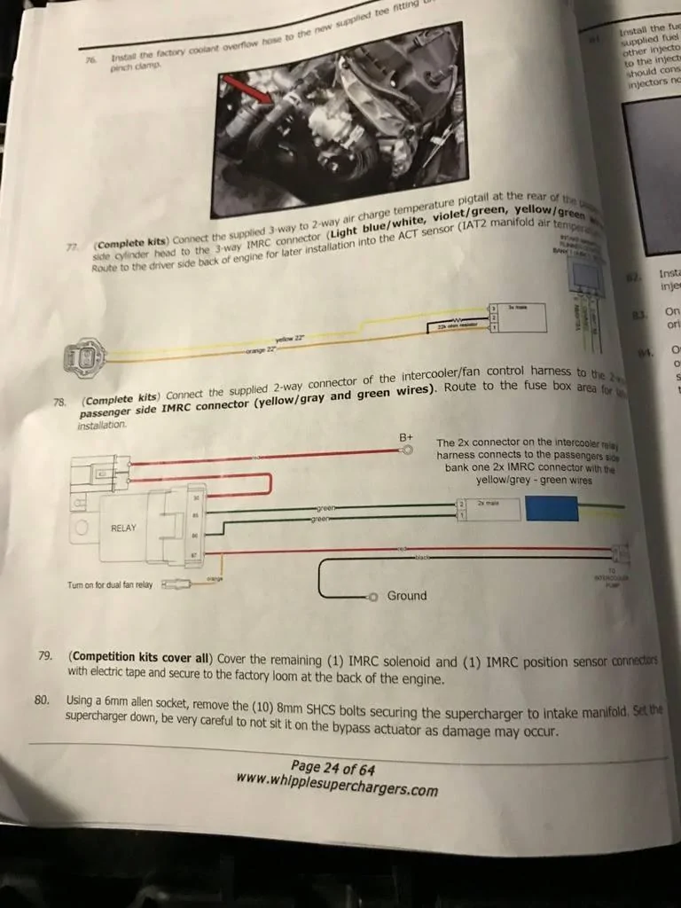

Also, can you please confirm the proper connections for the harness included in the Competition kit (pictured below). To me it looks like we have the fuse tap to replace fuse 44, and the eyelet connected to that is ground. I believe the other eyelet with the crush washers are also ground. I believe I mount the relay and fuse, and connect the final gray connector to the Intercooler Pump.
Here are the instructions as well:

You use the fuse tap as you mentioned, the eyelet in the same loom only 6" away goes to the positive stud (I used the one closest the battery, there are 3) under the fuse box cover and the second eyelet is grounded with an existing ground wire on the shock tower.
Yes, tape off all 4 plugs that used to connect to the factory intake.
