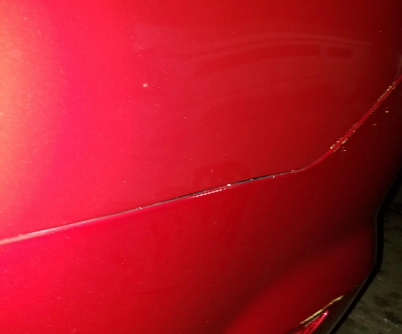

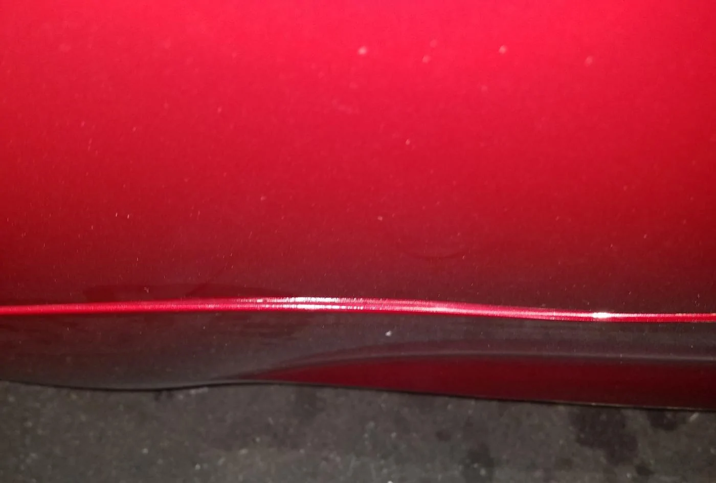

here are some close up photos of the damage, I think the paint transfer will come off easy. Do you guys notice how the bumper now sticks out about 1/8 inch or so? Can that be fixed relatively easily? or cheaply at a shop?

Press on the bumper cover along the seam - it should snap/click back into the bracket under it. You may need to use a little force on the cover, not a lot, just enough to pop it back into place.
Is the sheet metal above the seam dented inward? It's hard to tell from the pics.

There are no dents in the sheet metal. Just a light brushing of paint on the side and the bumper offset. Will be attempting to fix it in a couple hours

I took your advice and the bumper popped right back into place. If you look hard enough in the perfect light there is a tiny gap but not enough for me to care.
Was also able to get the yellow paint off the car. Only thing left to do now is buff out the tiny scratches.
All in all the home repair worked out perfectly. Thanks for all the help!

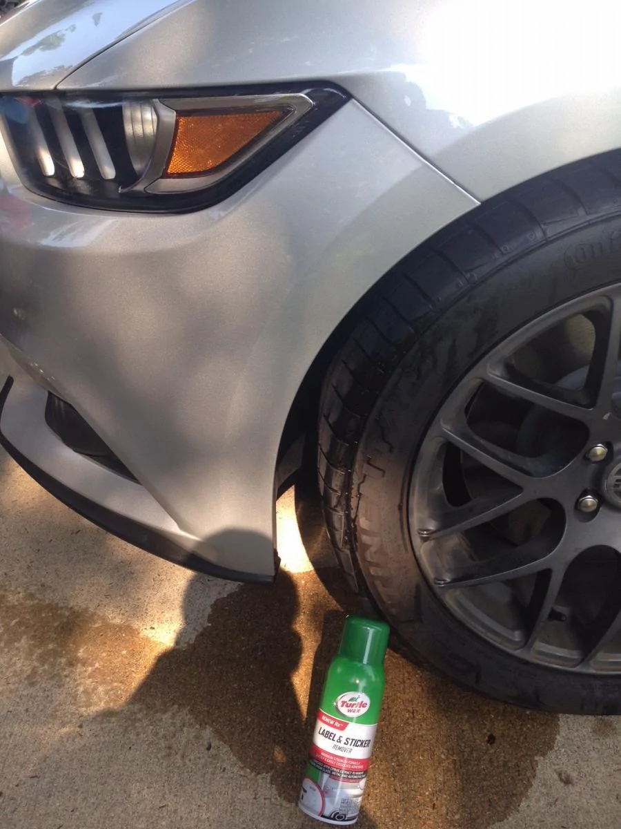

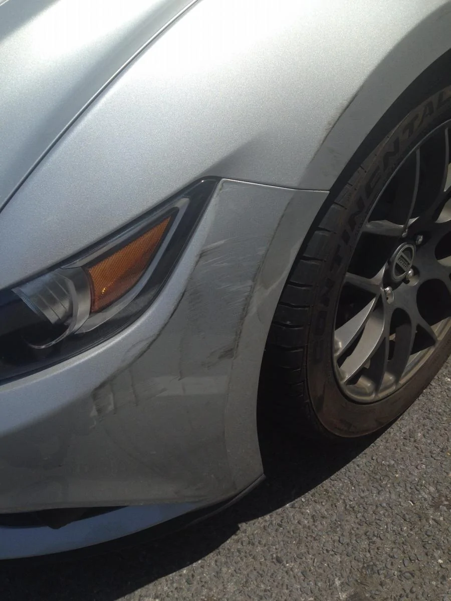

[MENTION=25323]Coolmanfoo[/MENTION] There's a green Turtle Wax spray can at the autoparts store that will take that off. Someone's large truck left a nice large black tire print on my ingot front bumper under the headlight and I was able to get it off easily. Just spray it on and wait a minute then rub it off. It also helped remove the two sided tape residue behind my stock plastichrome 5.0 emblems.

Found some pics from when I used it. Edit, it was a Turtle Wax spray:
