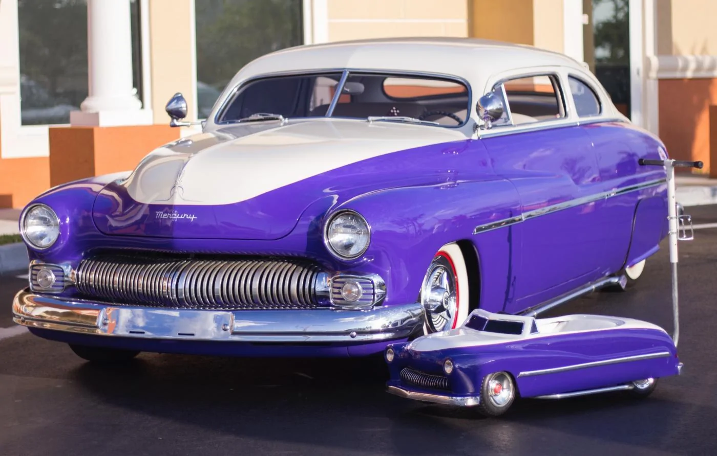

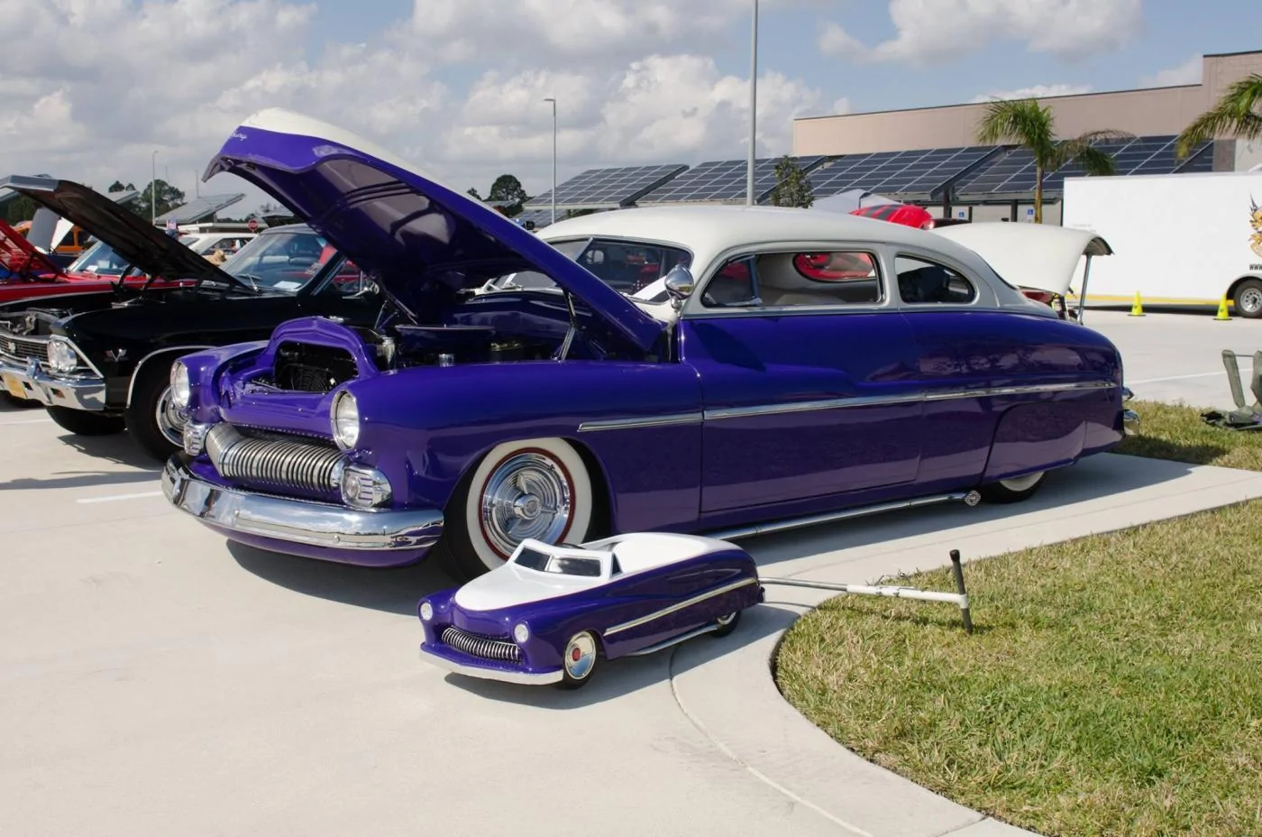

It is absolutely accurate. You will never be able to fix the etching left behind from bird poop once it has been left on the paint that long..25 years in the collision repair industry working on high end new cars. Don't need pics. You can wetland and polish as much as you want. It is etched! My custom garage kept,never driven in rain,hand rubbed only, covered in wax, show car got crapped on at a show. Was on the paint maybe for hours. Etched!
Once again, only fix is to sand and repaint. :mad:
Great advice...and your Mercury is awesome looking!!!
