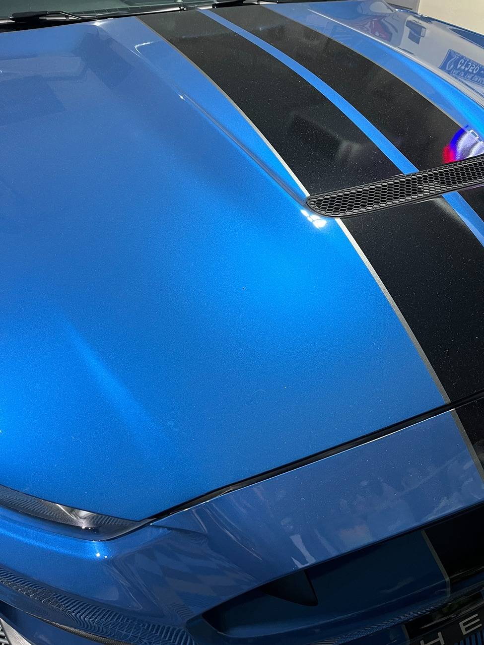

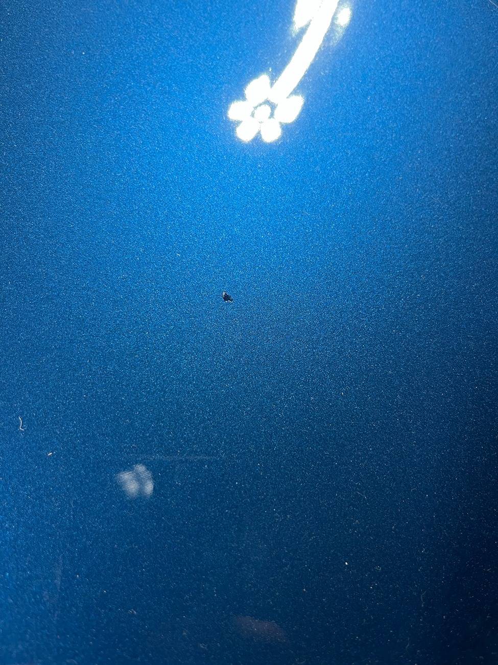

I had a very large rock chip on my hood and had my detailer touch it up with Dr. Color Chip. I was not happy with the results, it almost looked black. After a discussion with him i realized that the deeper the chip the more difficult to match the paint without getting a shading effect. Dr Color Chip will get you 90% of the way there and make it undetectable at the 2-3 ft range.
Could you post a picture to see what you are seeing ? What color is your car?
Lorne34
Project Hidalgo
Jun 8, 2016
71
3,977
4,511
Wisconsin
Lorne
2019 GT350
On Hood, from a distance, and a close up..
