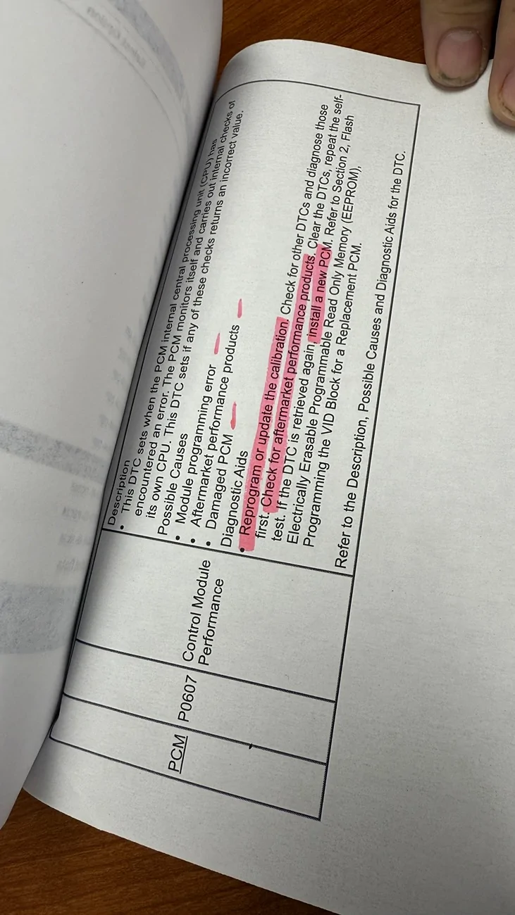

Hey guys, I'm new to this forum. I have 2019 Mustang GT pp2, roush supercharger phase 1 with a custom tune. I barely use this car, it has a little under 9K miles total. My battery completely died and when I replaced it with a new one, check engine late came on. (P0607) I tried clearing it and took it to downtown Sacramento ford to reset the battery but the engine light keeps on coming back.

Seems like a checksum from a map or similar internal change that was detected at a power on check. What did you find?
