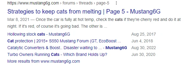

Very easy to look up. Go to Google, type: insite:mustang6g.com cats
Literally the first result:
seely

Right on sorry my forum search skills are crappy.
Yeah I'll read these threads to see other's symptoms.
Tbh I was thinking of lifting it up tonight. Just don't think i'll see anything but lets see what these threads say.
