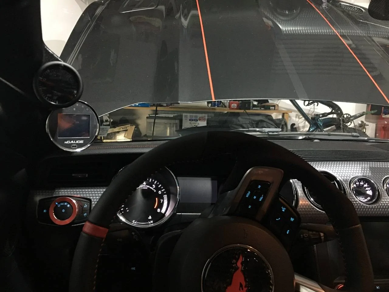

i went with a mechanical on the pillar combined with the ngauge for all other pids.

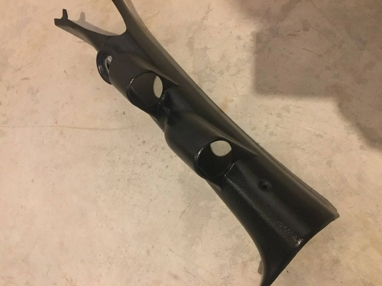

The autometer gauge pod has a spot built in for the tweeter and you can get single, double or triple pods

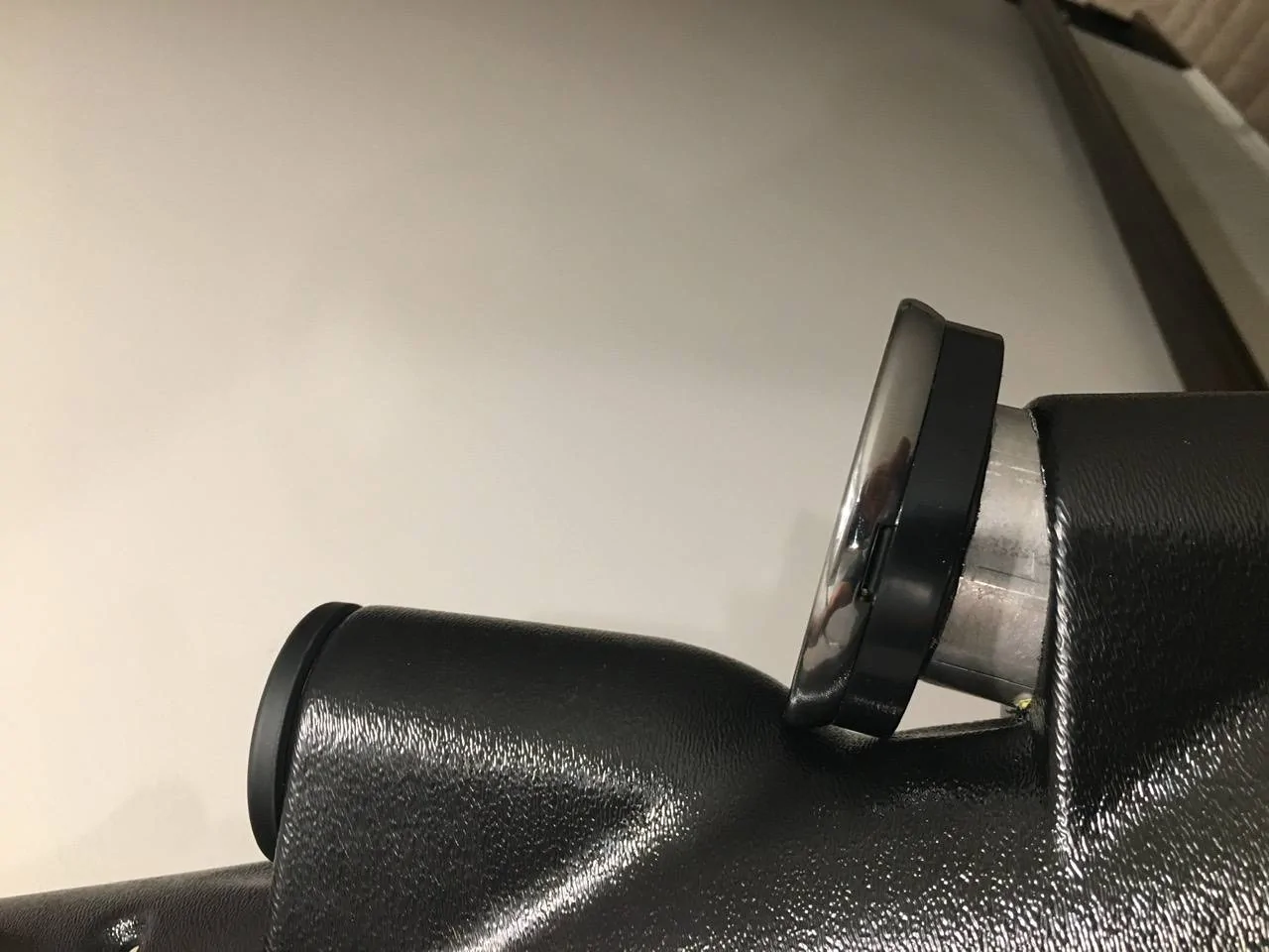

to mount the ngauge i had to make an extension out of 2” ID exhaust coupler and a dremel.
you pickup the boost reference off an unused npt port on the plenum near firewall.

I forgot to mention the finish on the autometer mount is not the same as factory. It is more textured and black. But since it is a full replacement and attention is at the gaugesI personally do not notice unless i explicitly look back and forth.

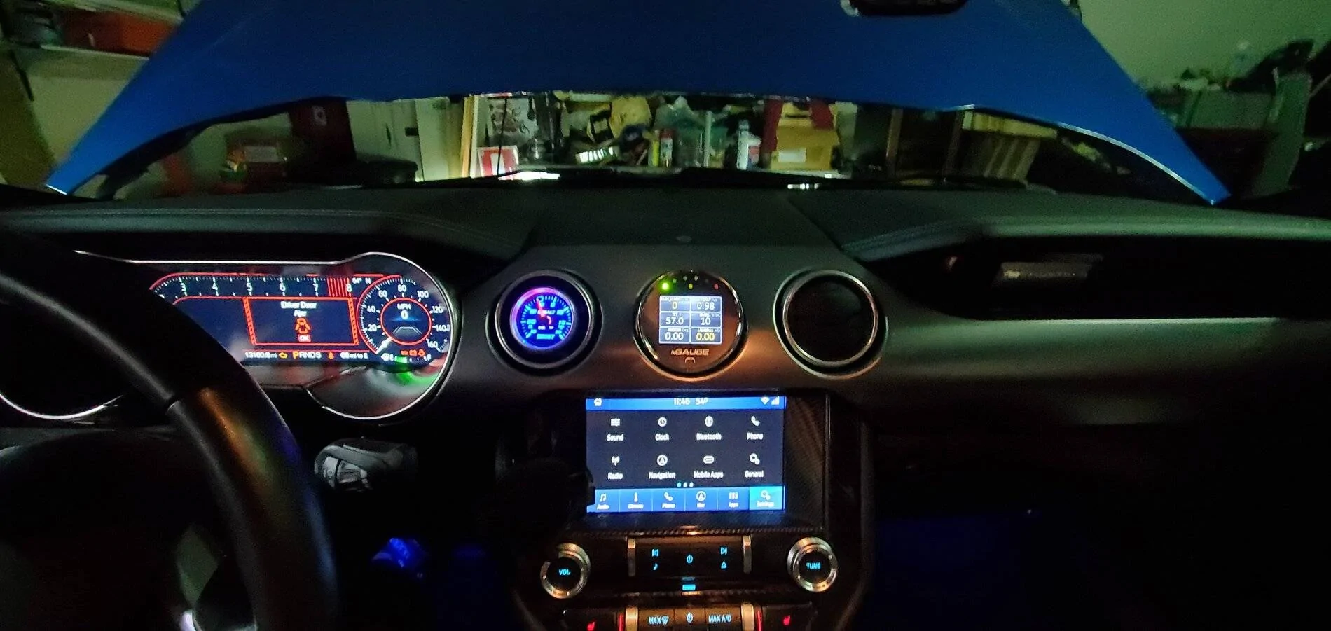

I went with auto meter cobalt mechanical boost gauge. I placed it in my vent next to my NGauge. I worked ahead since I'm still waiting on my whipple.
