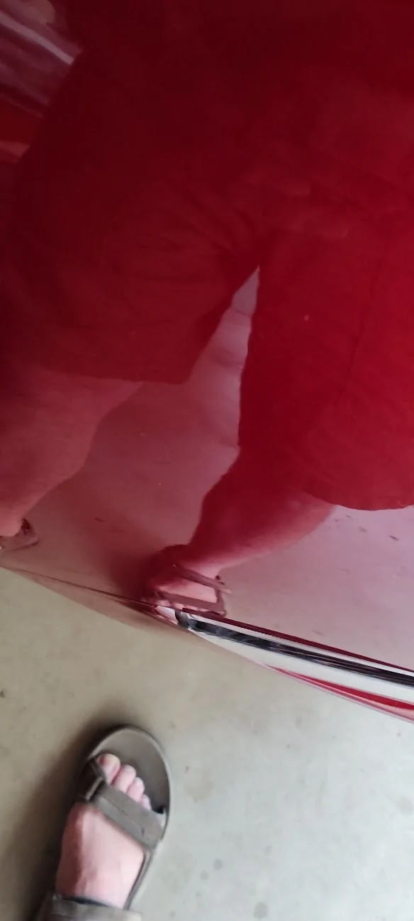

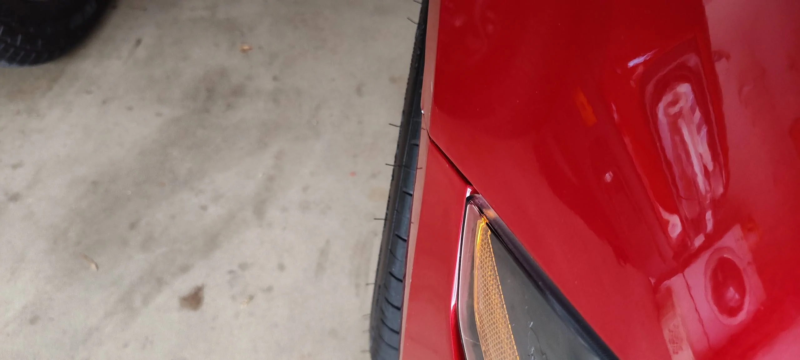

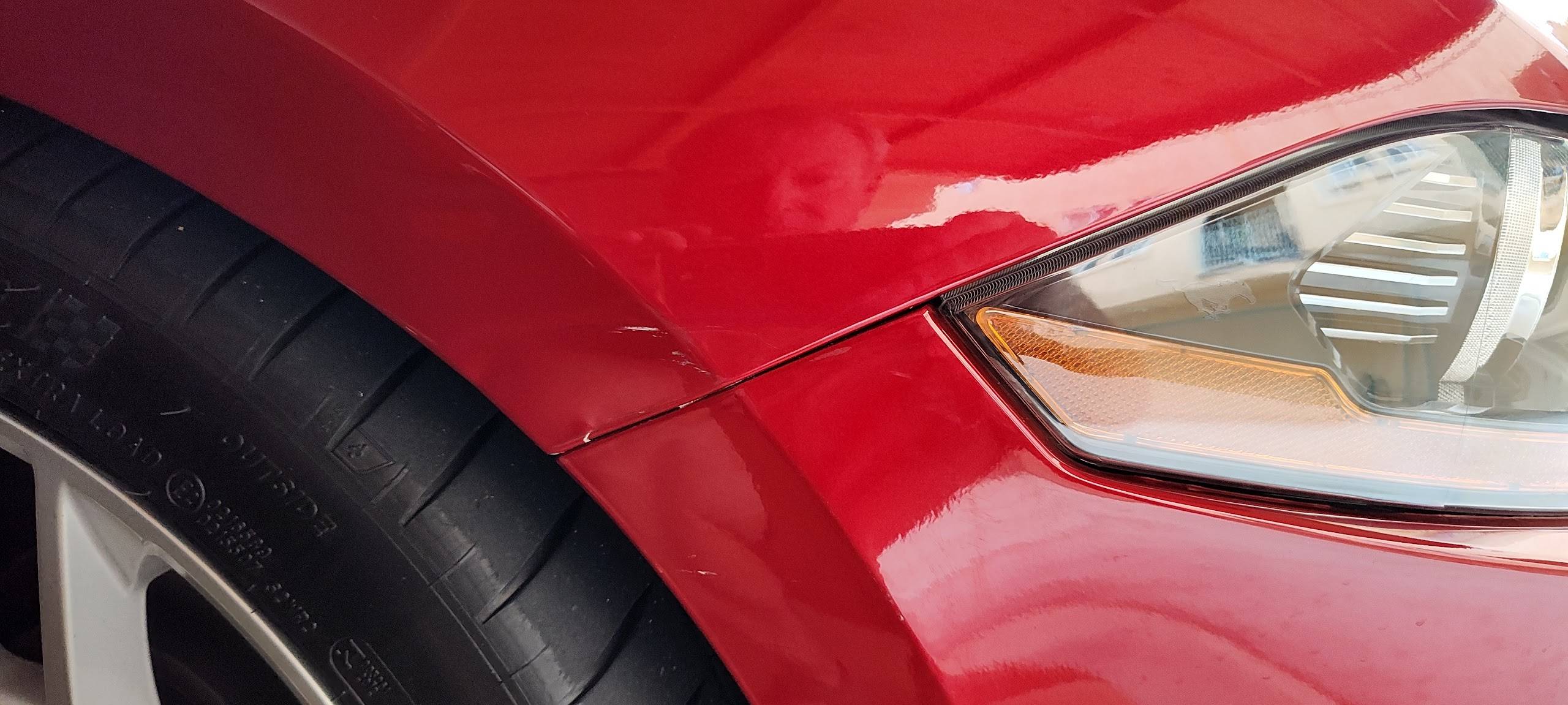

A homeless guy with a POS Nissan, no insurance, no license, and no registration clipped my Mustang at the gas station today. It isn't bad but it is going to need to be fixed. I can't believe this. Called the police they can't do anything, this crazy ass city (Los Angeles) protects everybody but the tax paying citizens. Here is a few pics. The headlight sticks out a tad now as the bracing underneath the fender probably got bent a little. How much do you think to repair? I don't want to get insurance invovled.

Look for a reputable PDR (Paintless Dent Repair) shop and see if they can get the indentation out of the fender. Some really good shops can get that dent out to the point you couldn't tell it ever happened, but it depends on the factory fender lines/crease and expertise of the PDR specialist. The front fenders are aluminum.
The scuff there - try buffing it out with a good compound/polish. 95% or better of that mark may disappear. Any scrape of the paint layer, get Dr. Colorchip kit (hit up @Bikeman315 - he did a repair on his prior Ruby Red S550 and he said it came out very well).
Now for the headlight and bumper cover - grasp the bumper cover and front fender at the edge of the wheel well where both meet; give a slight tug toward you. It should conform and pop back into place. I don't think your headlight assembly is damaged, doesn't appear to be from the images. It just looks like the fender is pressed inward which is pulling the bumper cover in as well, skewing the body lines of where the headlight is making it appear visually skewed (but may not be).
If all else fails and you want to keep repair costs to a minimum and avoid a body shop visit/down time - go online and source out the same color used front fender (eBay, LKQ, local salvage yard, etc.) and swap out the fender - not hard to do at all.
