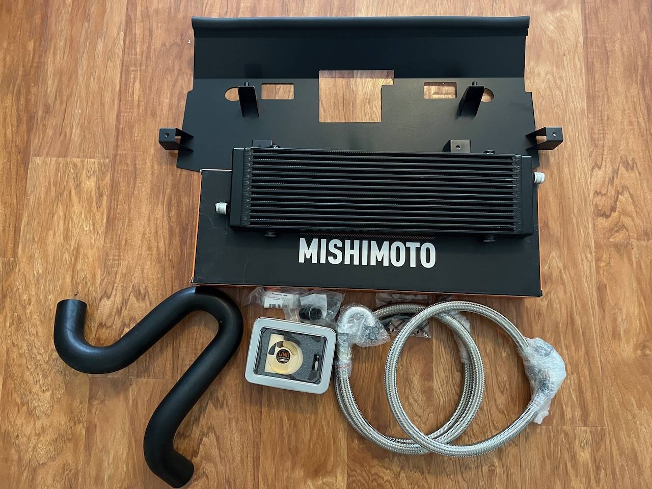

I installed the Mishimoto Oil Cooler Kit a little over a month ago.
As I was inspecting my car for my next track day (this Saturday!), I noticed that the one-piece lower radiator hose from the kit has come into contact with the alternator pully/belt and has left a small notch in the radiator hose. I'm assuming the contact only happens during certain driving conditions as it doesn't come into contact at rest (there is space between the hose and belt/pully at rest).
To resolve the clearance issue, I've loosened up the upper hose clamp and "clocked" the upper part of the hose clockwise a little to increase the clearance.

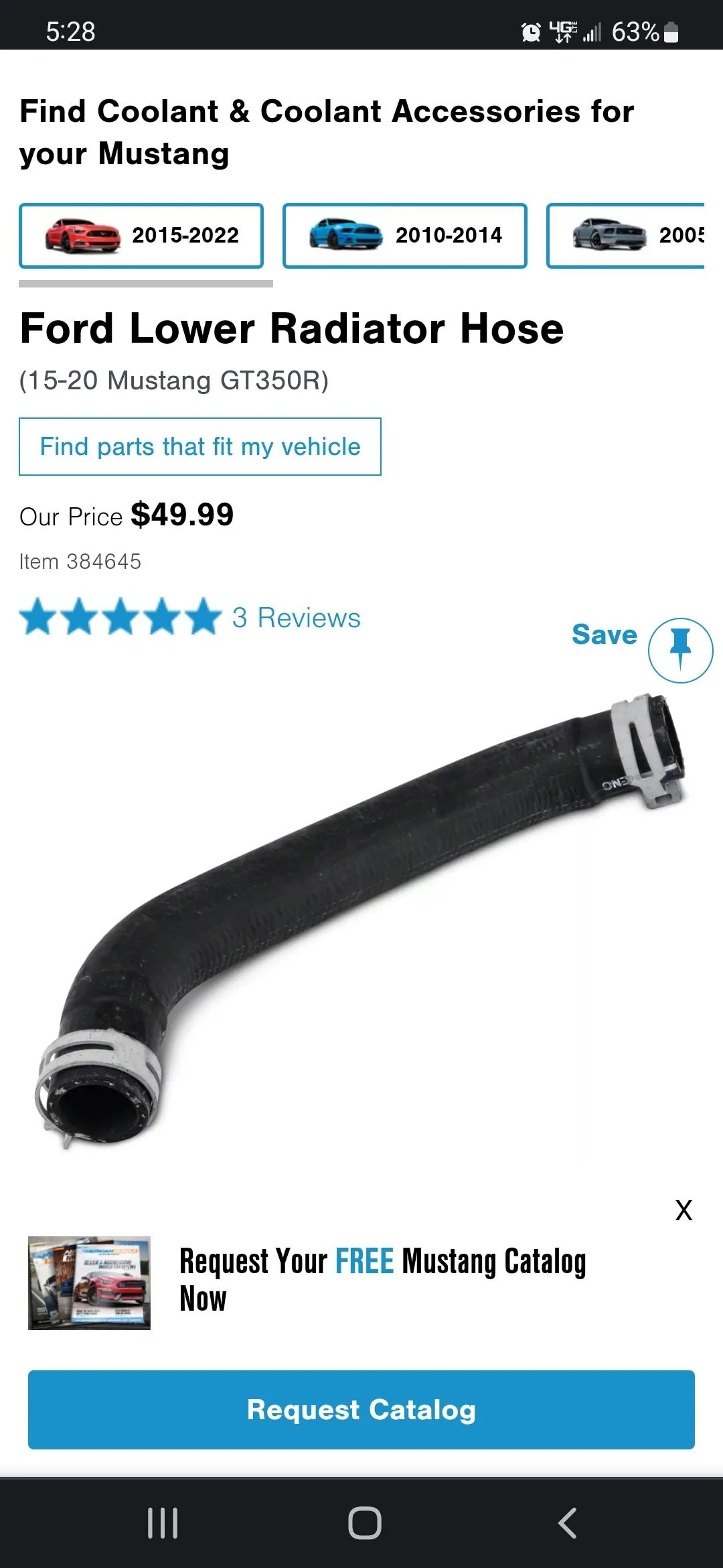

oe hose for a gt350 is what you need

Perfect! Thank you, sir!!

Thanks for all the suggestions everyone. I went with the Motorcraft KM5357 GT350 hose suggested by @mech94. It's out of stock on a lot of sites as well as my local Ford dealers (they stated the part is on backorder).​
But, it turns out RockAuto had it in stock and I received it yesterday.​
I really like that it's a Ford part and has the factory hose clamps instead of the worm-drive clamps that came with the Mishimoto kit. Installed it today and it fits perfectly.​
