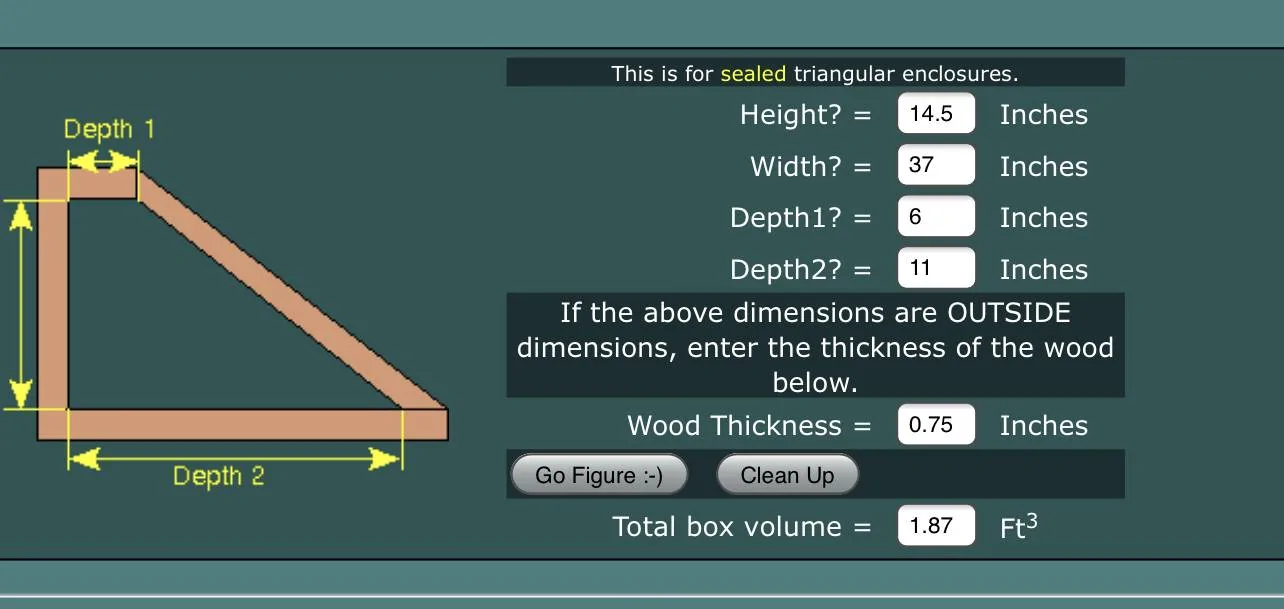

I need the depth measurement for a speaker box. To install from the trunk the lower measure max is 11”. I don’t have a square to get the upper measurement to get the angle of the backseat back rest. Does anyone have this measurement?

I just measured my Zenclosure Type 2 front-fire box. External measurements were 7” top depth, 14 7/8” height, and 12 1/2” bottom depth. This includes the carpeting, which is probably 1/8” thick.

Thank you!!! Got the measurements. This is what it will take for the required airspace.
