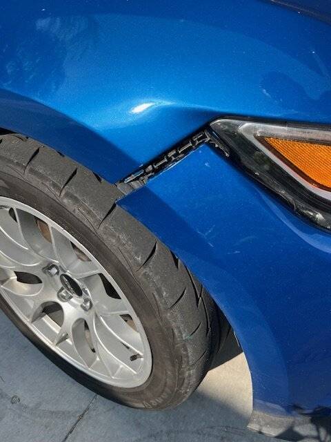

My front bumper got torn away from the fender. The plastic tabs and 7mm bolt mount were destroyed, so there's no way to reconnect them together OEM style. I remember someone once posted here about a bracket that they either made or bought that can attach and reinforce the bumper/fender together, and tried a
few search words but cannot find it. Can anyone help or direct me to some fix for this damage?

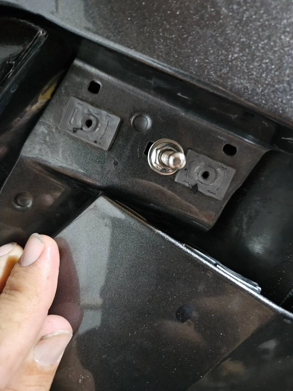

I used this push lock pin. Works great, trying yo recall where I got them from. See the black dot.
