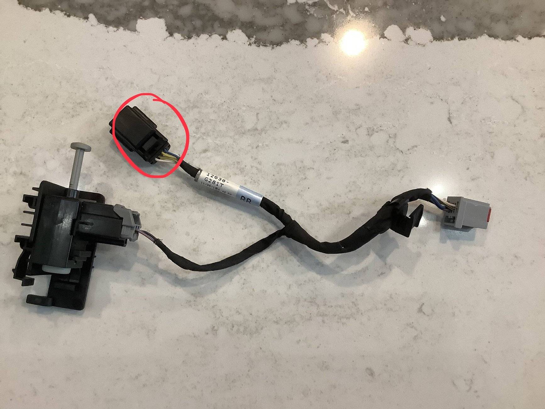

Read here and look at this pic for reference:
For those who will be installing a WOT Box on a 2019 Bullitt (and presumably 6 speed GT), the instructions on N2MB’s website are correct, with the exception of where to connect the green WOT Box wire for the clutch signal. I suggest tapping into the harness inside the car like I did to simplify things, as the clutch switch harness can be easily removed from the car, so you can do your soldering on a workbench and tape everything back up nicely. Unfortunately, I didn’t take any pics of the harness afterward, but I do have pics of what it looks like removed from the car for reference. You will want to connect the green WOT Box wire to the solid yellow wire (CPP1).
You’ll want to connect the green wire to the yellow wire (to the left of blue wire) circled in red on the clutch switch harness.
