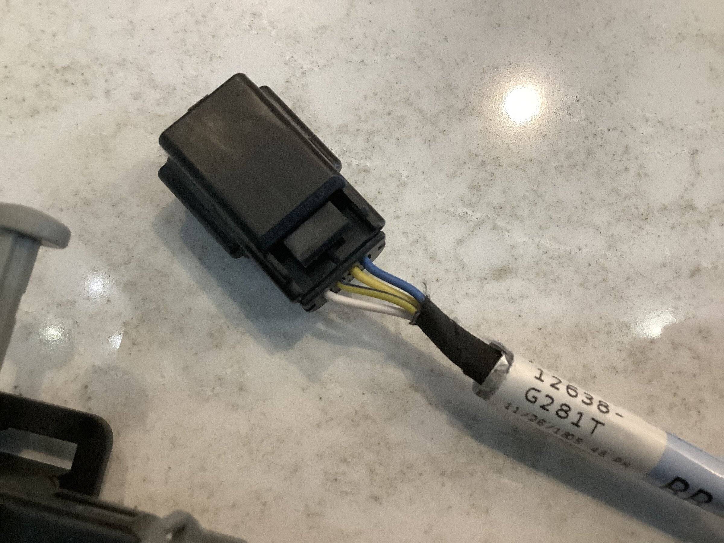

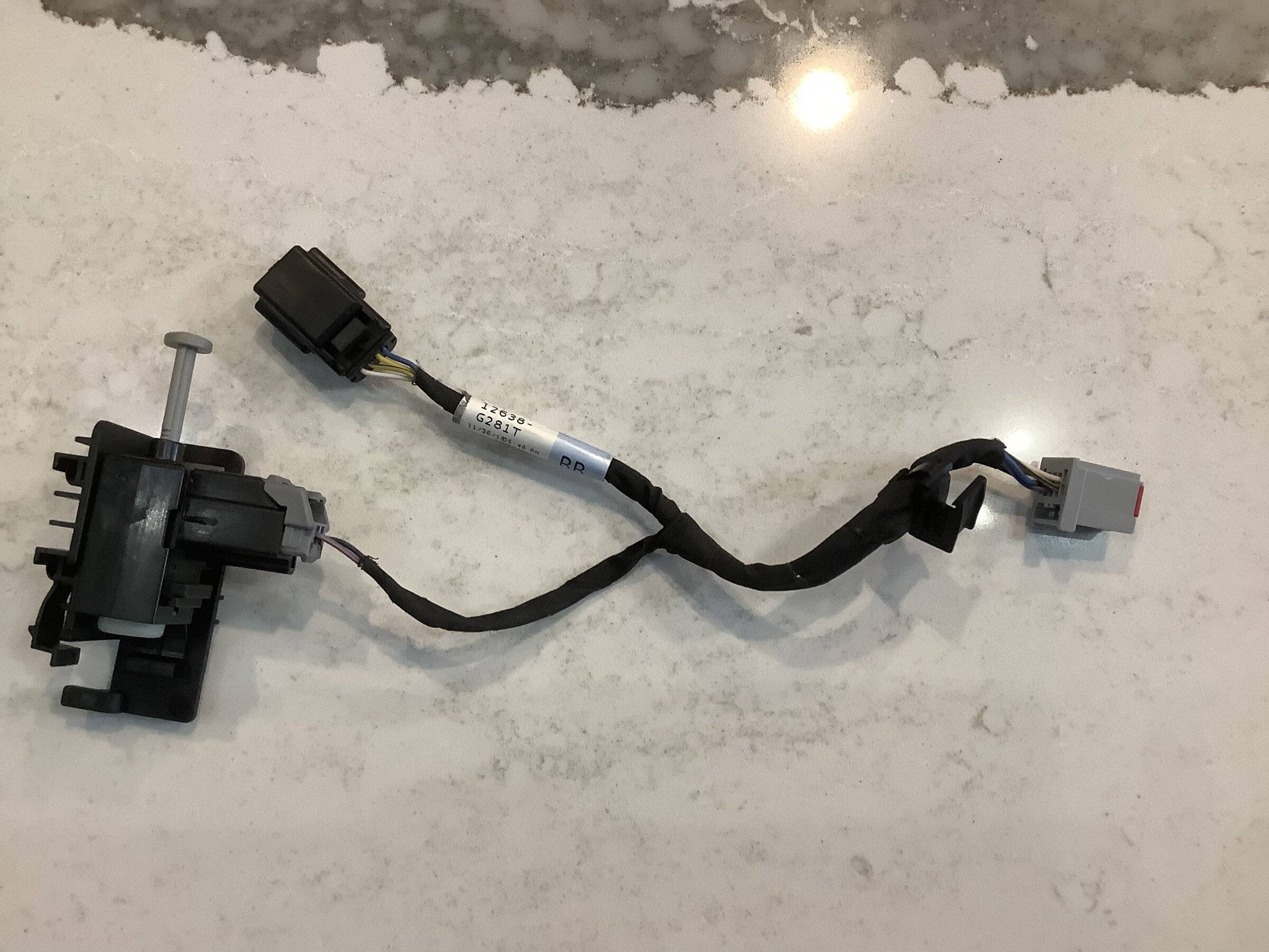

We’ll, after about 6 days of research and working on this install, I am happy to report that “It is FINISHED!“ I learned a lot during those 6 days. I kept thinking of what the late Evel Knievel once said: “A man will fall many times in life, but he is never a failure until he refuses to get back up.” I had to see this through, for a few reasons:
1. Because I wanted No Lift Shifting, in hopes that it would help my MT82-D4 live a longer and healthier life (and Ford didn’t put it on the 18+ cars, as advertised).
2. I had put a lot of effort into the install to make it nice and clean (and I had literally cut a total of 3 wires in two of the three ECM connector wiring harnesses, plus one clutch switch wire).
In the end, it came down to some help from N2MB. I can’t say enough about the great tech support that they gave me last night, we worked together off and on until almost midnight, locating the Clutch Pedal Position wire (CPP1), troubleshooting and finally, Debugging and making a PIDControl clutch voltage change to 1.8V in the WOT Box software.
Now for other news (because it never stops right)? N2MB told me the wonderful news last night, that I will need their nitrous add-on to run nitrous with the WOT Box 2step and NLS. Time to order one up and get that installed.
For those who will be installing a WOT Box on a 2019 Bullitt (and presumably 6 speed GT), the instructions on N2MB’s website are correct, with the exception of where to connect the green WOT Box wire for the clutch signal. I suggest tapping into the harness inside the car like I did to simplify things, as the clutch switch harness can be easily removed from the car, so you can do your soldering on a workbench and tape everything back up nicely. Unfortunately, I didn’t take any pics of the harness afterward, but I do have pics of what it looks like removed from the car for reference. You will want to connect the green WOT Box wire to the solid yellow wire (CPP1).

Here’s the link to the instructions.
Note: The green wire (N2MB clutch switch wire) connects to the solid yellow wire (CPP1) in the factory clutch switch wiring harness shown in this pic.
