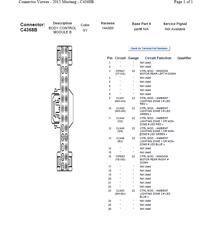

If you swap the module and purchase all of the oem equipment then full OEM MyColor will be possible. From what I can tell from the wiring diagrams, they should all connect directly to this module.

Here is the second connector pinout! What I am not sure of is where or if there is a zone 2 ambient lighting.... The other troubling thing is that there is no service pigtail available.... That might make things difficult if you want full OEM MyColor.
