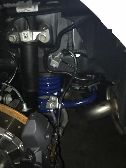

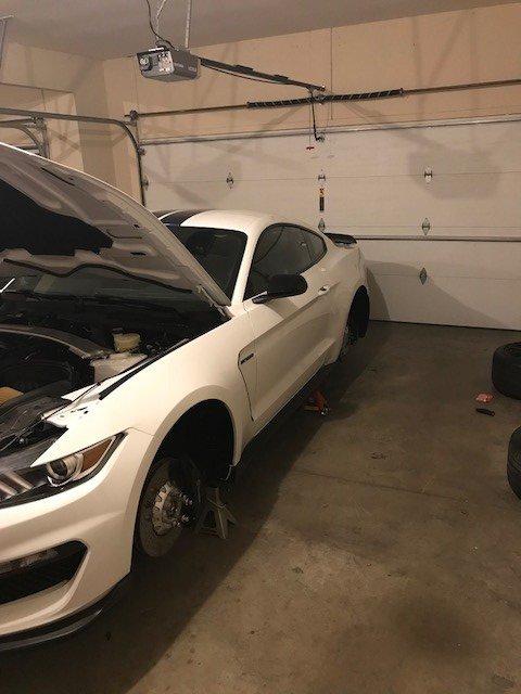

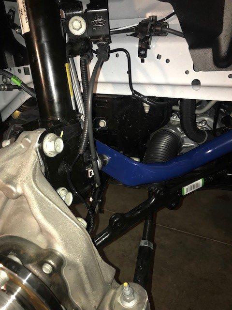

Quick update:
Installed the rear ford performance springs and sway bar last Sunday and got a good start on the fronts.
Installing the passenger rear was a pain...it was for some reason more difficult to wiggle out than the driver side. In the process I stripped one of the 6mm allen bolts on the passenger side upper link. Fortunately it was the one that bolts to the sway bar so I was able to take the sway bar completely out so I could work on it on the bench. I got it off and need to order new ones, they are cheap at 10 dollars.
Hope to get the fronts done shortly, little hesitant to attack the front sway bar...even as easy as it "looks" on the how to videos I know the bolts never came off as easy they do on the videos.

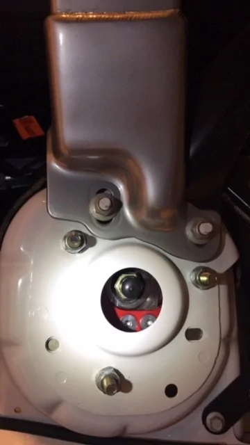

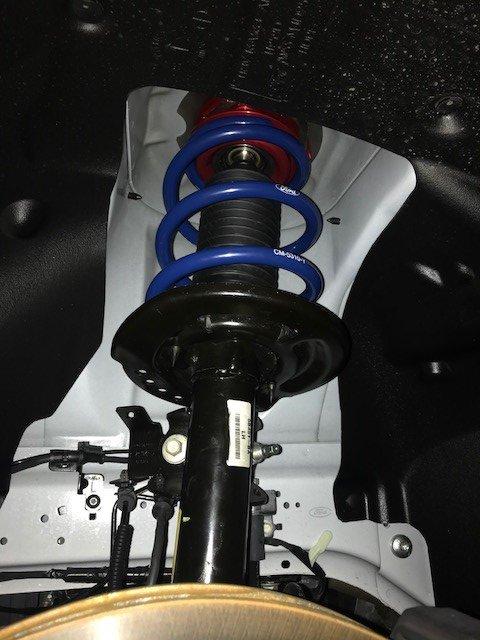

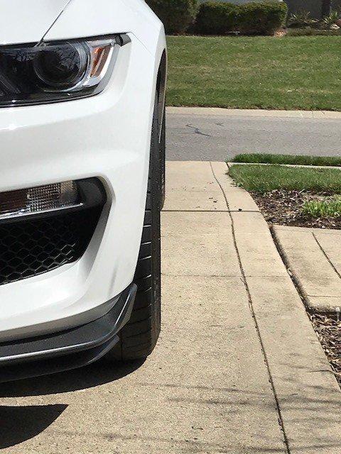

Quick update:
Ford performance package installed along with vorhslag camber plates. I set the pointer on the camber plates to the "middle" which I know means nothing until I get alignment.
I took it for a test drive last Friday and put a couple highway miles on it after the initial test drive (I'm no mechanic but fairly mechanical). After torquing everything per spec I witness marked everything to watch for movement.

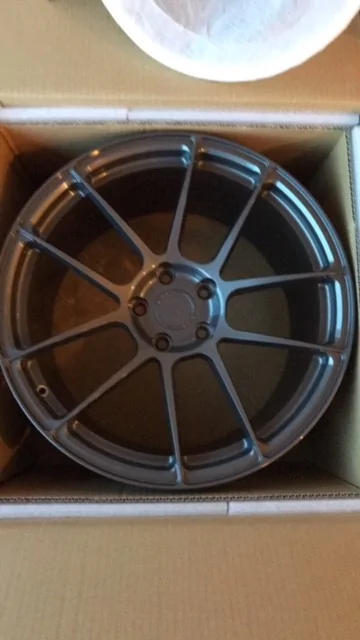

I bought a set of SV502 19x11 (square) of Signaure wheels in gunmetal gray from [MENTION=20243]50 Deep[/MENTION] , same wheel ford performance school is using on the R they are building. They arrived last week as well and I was planning just to run r hubs with 25mm spacers but the r hubs are on back order so I suppose I will just run the ARP studs. I plan to do a comparison between them and forgeline GS1R (which I have on order from [MENTION=27078]Paul@PKAUTODESIGN[/MENTION] in the exact same specs. I really didn't need two sets of wheels (3 if you count the stock) but figured what the hell.
Lastly I installed a set of caliperflexion caliper studs, Tob [MENTION=19066]Epiphany[/MENTION] was really great to chat with on the phone.
I didn't get a chance to install the ZL1 tow hook as I didn't have the right tool to reach the 7mm bolt under the fender that attaches to the bumper, I need a right angle attachment of some sort.
I also I have a set of BMR low profile jacking rails on order from Jegs...they are taking forever to ship....:frusty:
This is addicting!

Sorry, to revive an old thread. Could you please measure the distance from the ground to the bottom of the splitter in front of the tires? I'd like to install the FP springs but I have to use 3" tall race ramps in order to get the car on my 2-post lift. Don't feel like having to use additional puzzle pieces to get the car on the lift.
Thank you!
