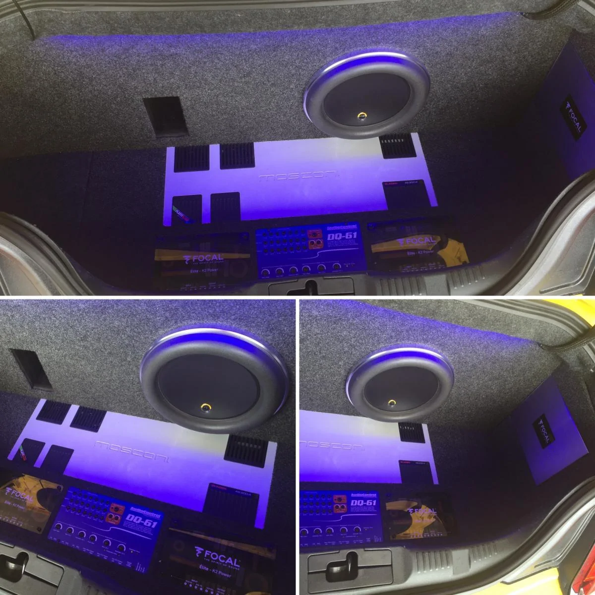

My trunk has been finished!!! Looking good!!
toplessfun
Photographer / IS Guy
Jan 6, 2015
236
93
Mississauga, Ontario
www.yankiyuksel.com
Yanki
2015 Mustang GT Convertible
We installed the Mosconi 200.4, focal fc900.1 amps in the trunk, along with the DQ-61 as well as the focal elite series cross overs for the left and right front stage. For the sub, we went with the JL audio 10" W7.
This thing sounds incredible.
The following went into the front stage
Focal ES 165 KX3 three component speakers.
The rears are
Focal 165 AC coaxial kit.

I've been looking hard at the DQ 61, what is your opinion on the unit?
toplessfun
toplessfun
Jan 6, 2015
236
93
www.yankiyuksel.com
Yanki
The DQ-61 is quite a beast. What it provides more than anything is a way to boost the initial signal coming from the head unit. I believe the voltage is rather low coming from the head unit, but it is a clean flat signal.
For me, it also has a feature that I love. It has a technology called accuBASS. What this does is basically gives you back the bass falloff you get with factory head units at high volumes. You can tune it back so that it is steady all the way through the volume range.
It also provides you with a separate EQ for your fronts, rears as well as the sub.
I have used it to fine tune the audio levels for all the speakers and I'm more than happy with it.
If I had an endless budget, I would have looked at a different option with an active crossover system as opposed to the passive ones that come with the Focal Speakers.
Hope that helps.
P.S. It also has the ability to turn off all the processing done by the DQ-61 via the remote control knob. This gives you a clear image of what that DQ-61 is actually doing for you.
