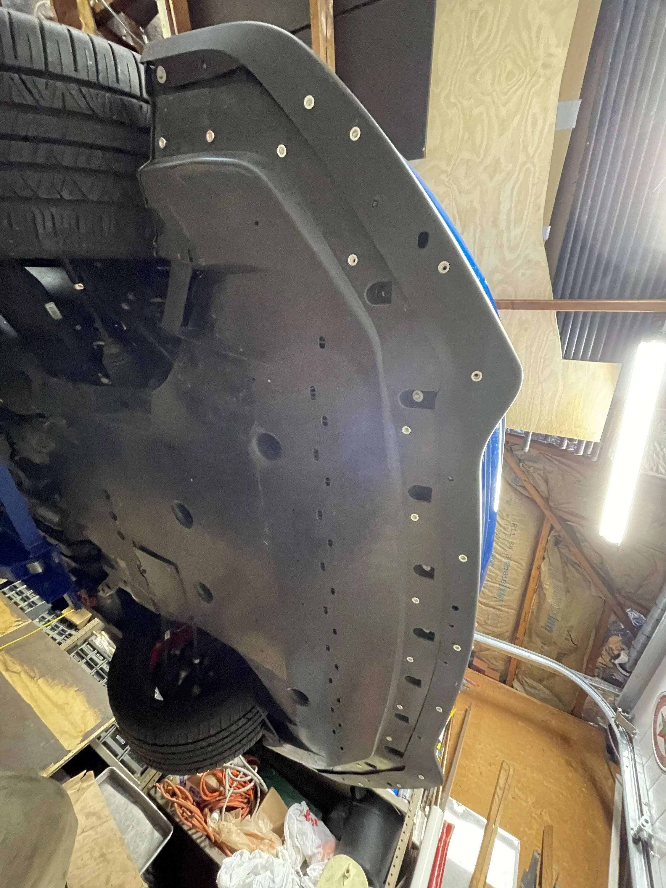

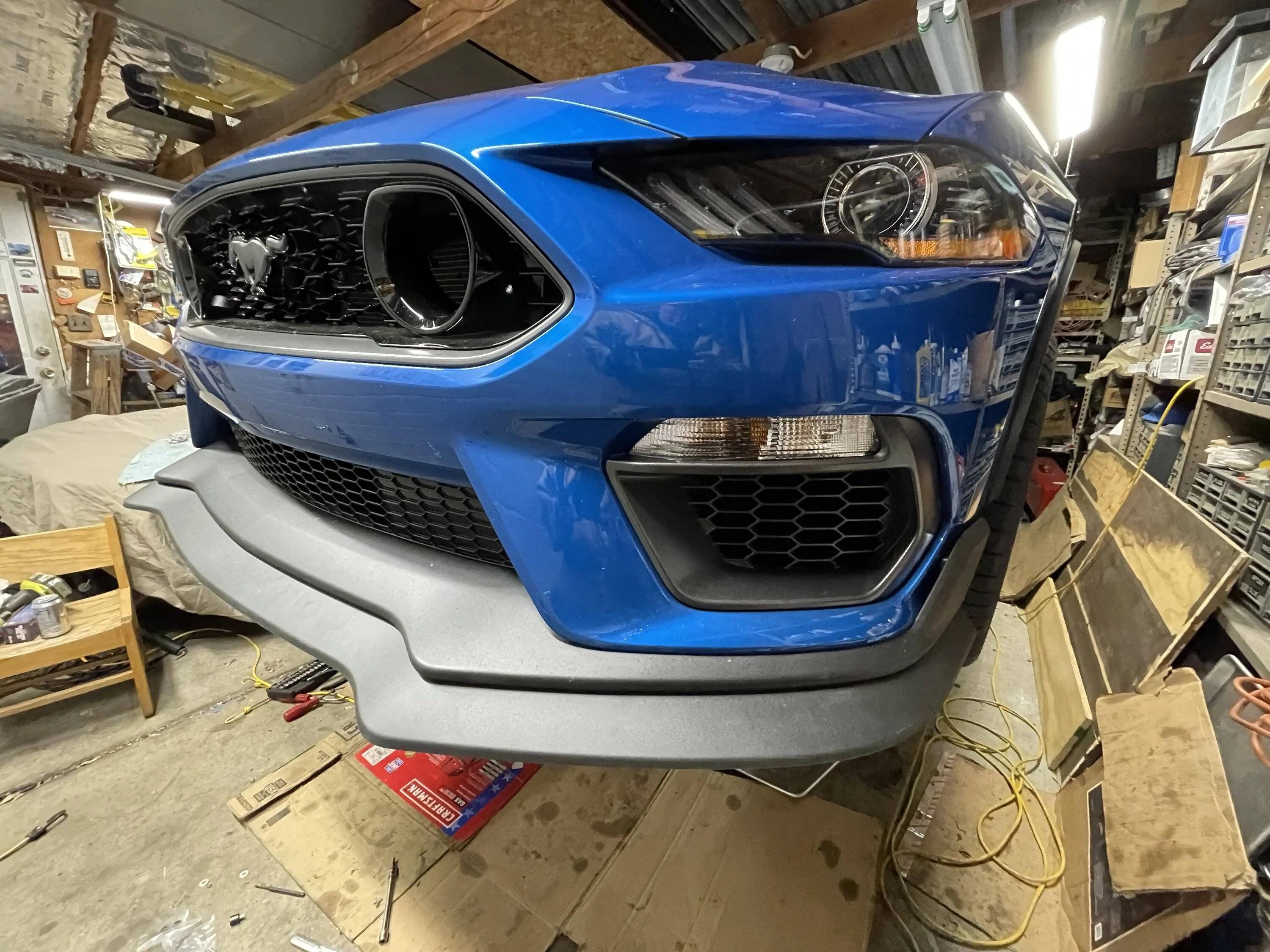

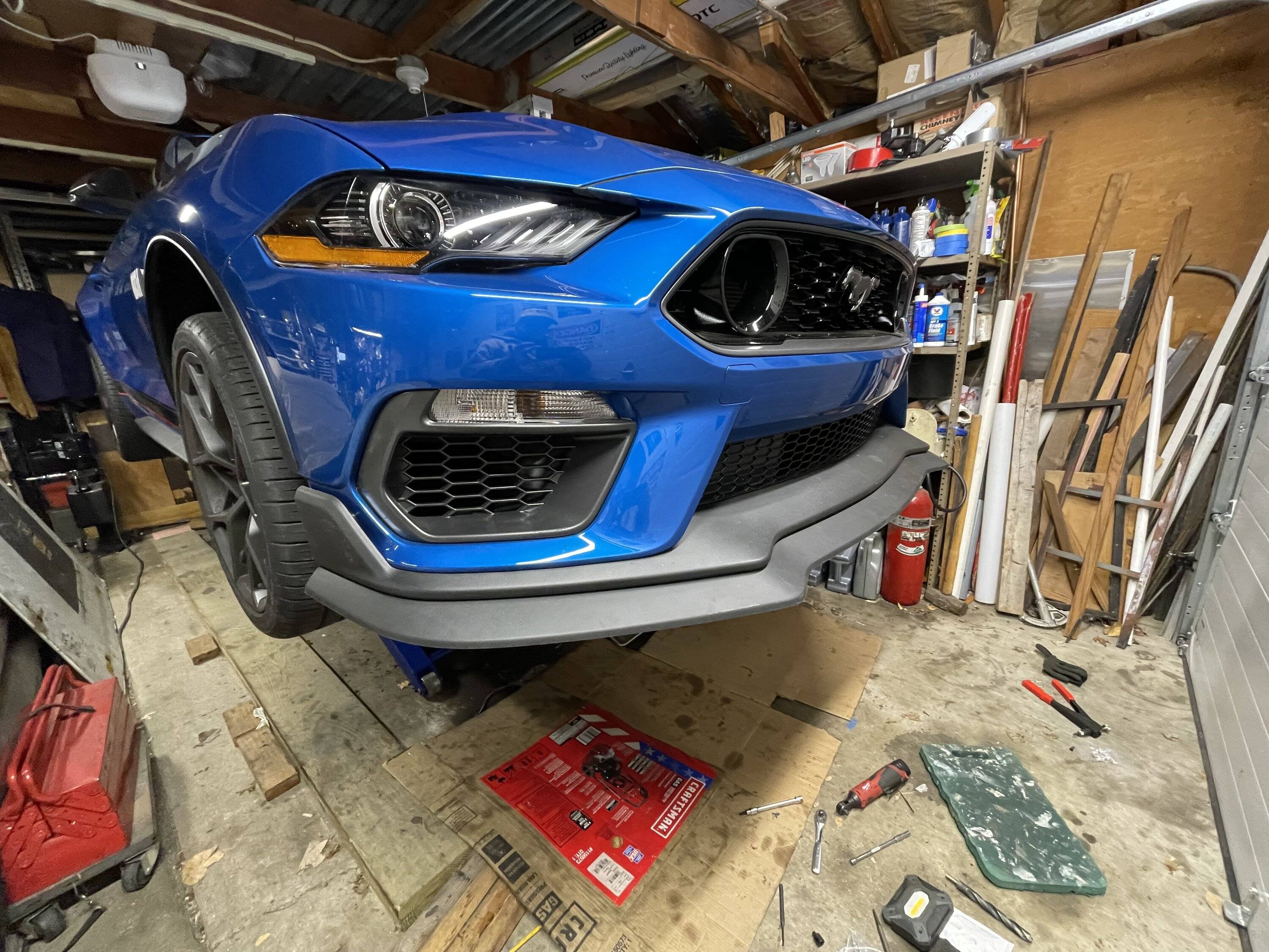

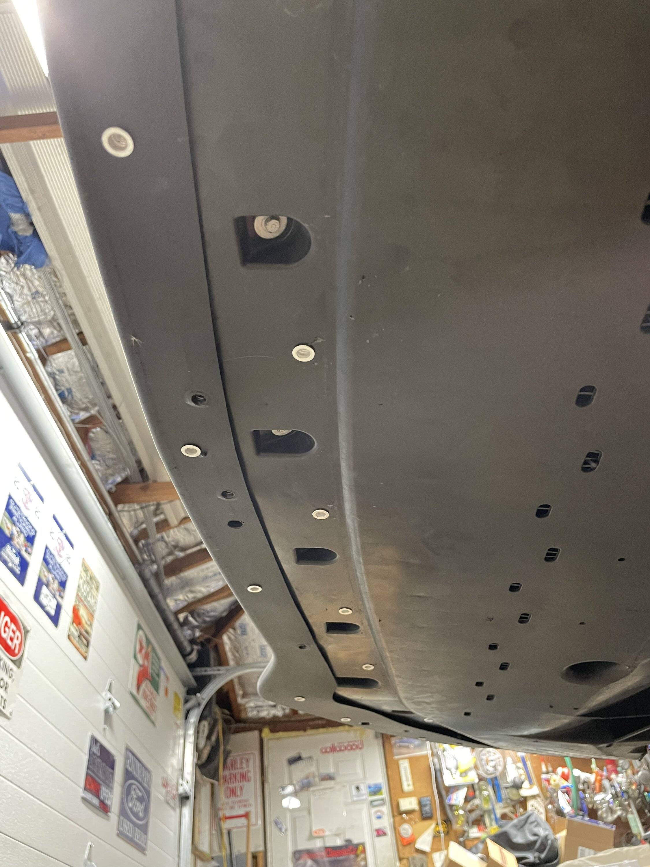

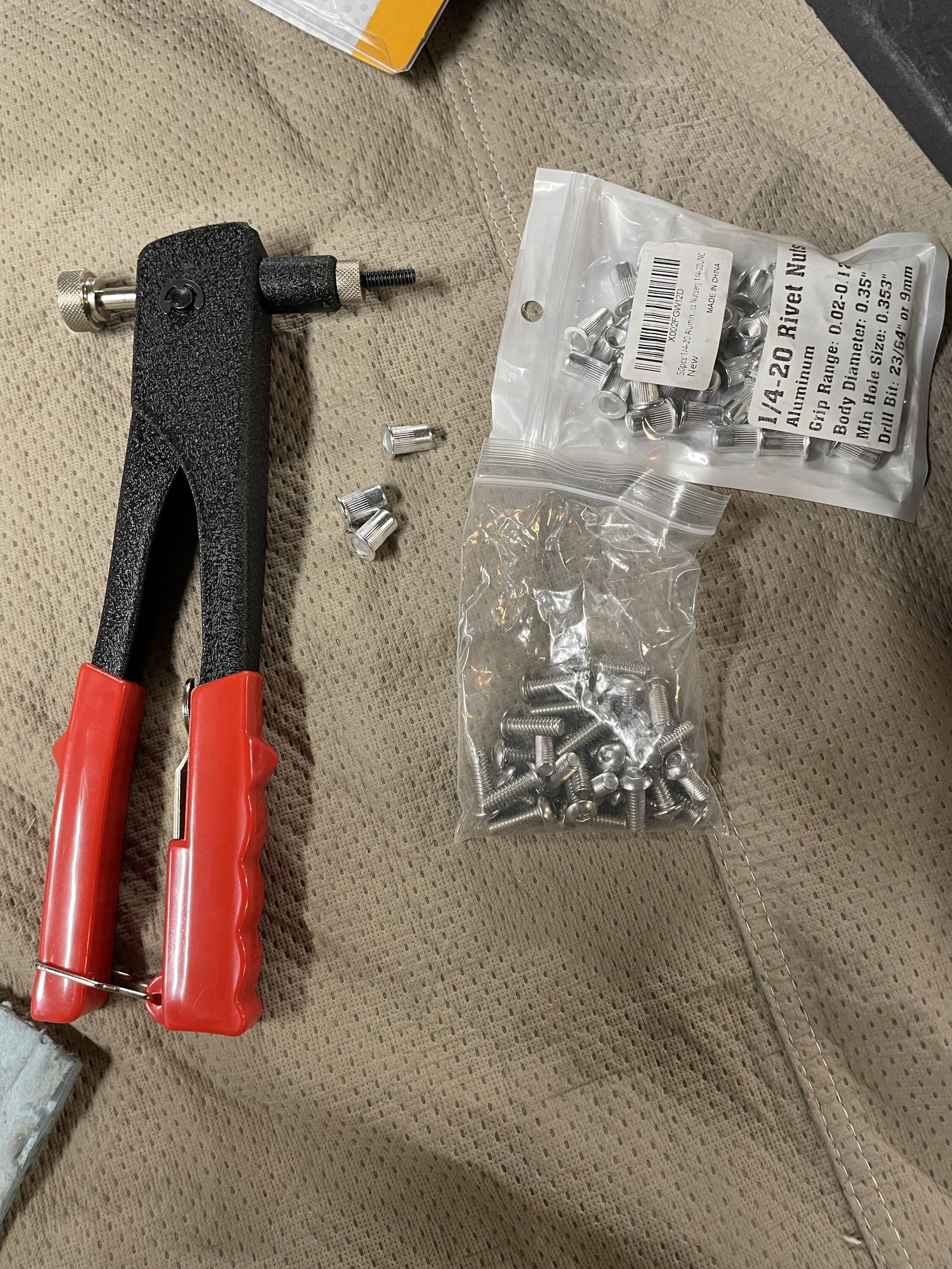

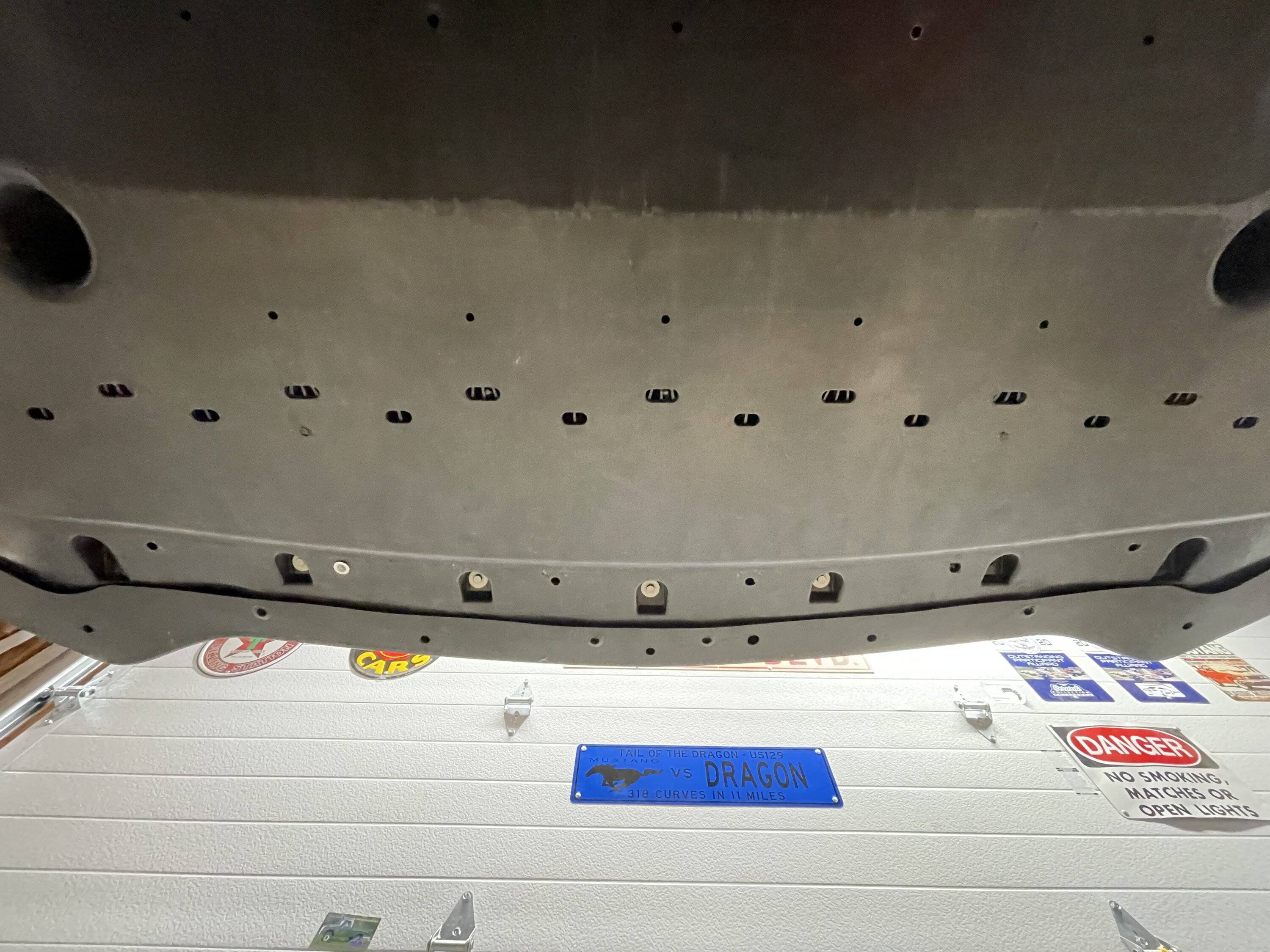

Just replace all the plastic push pins on front splitter. Put threaded rivets in and put 1/4 x 20 bolts stainless steel. I have two front splitters and I have a new one and I use when it’s scraped up a little so I like to switch them back-and-forth.

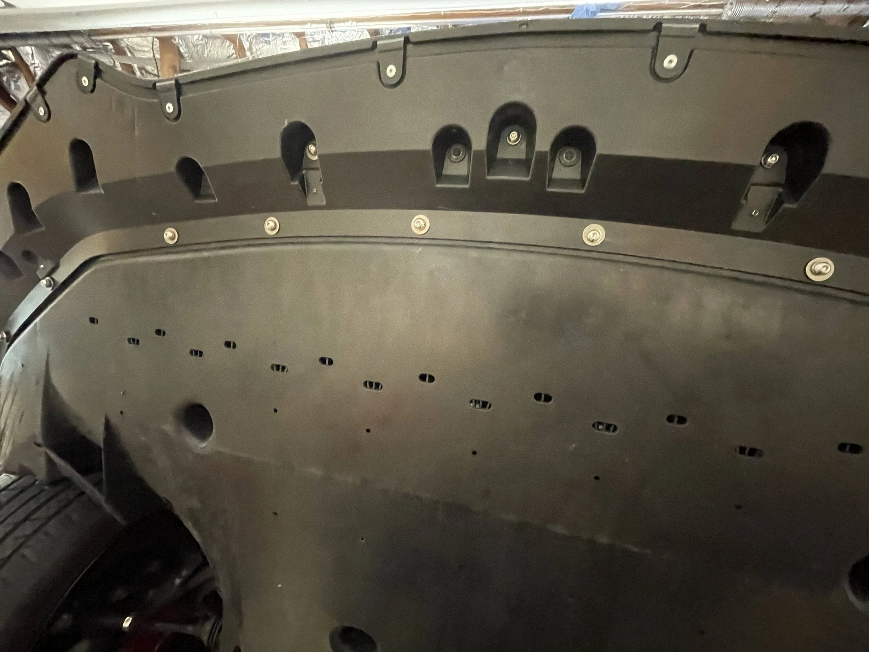

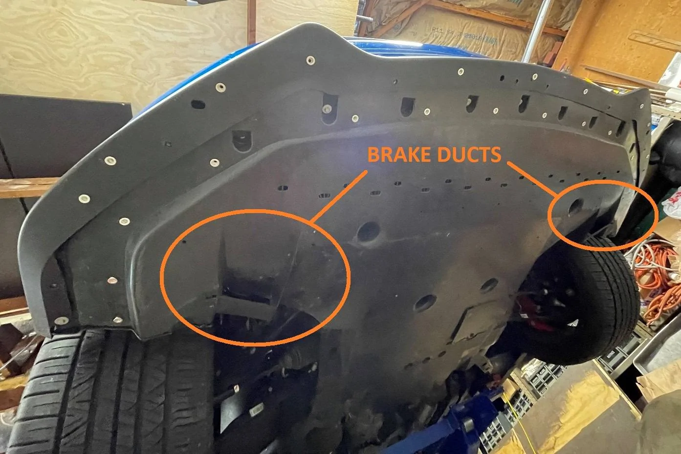

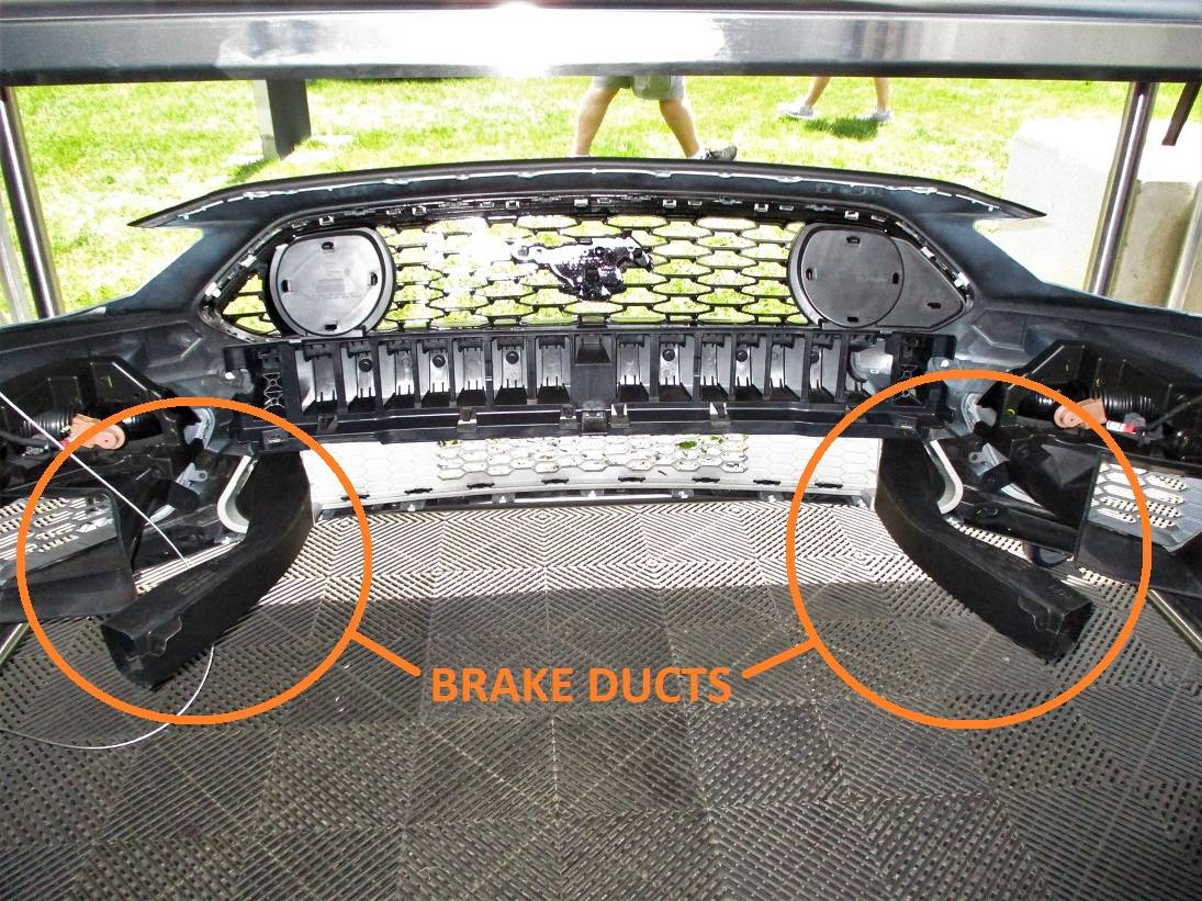

Bill- attached below are two photos, the first one i took two summers ago at the Ford Nationals M1 display and the second one from your current post; i gather there are two sets of ducts drawing cool air to the R&L front brakes? -C

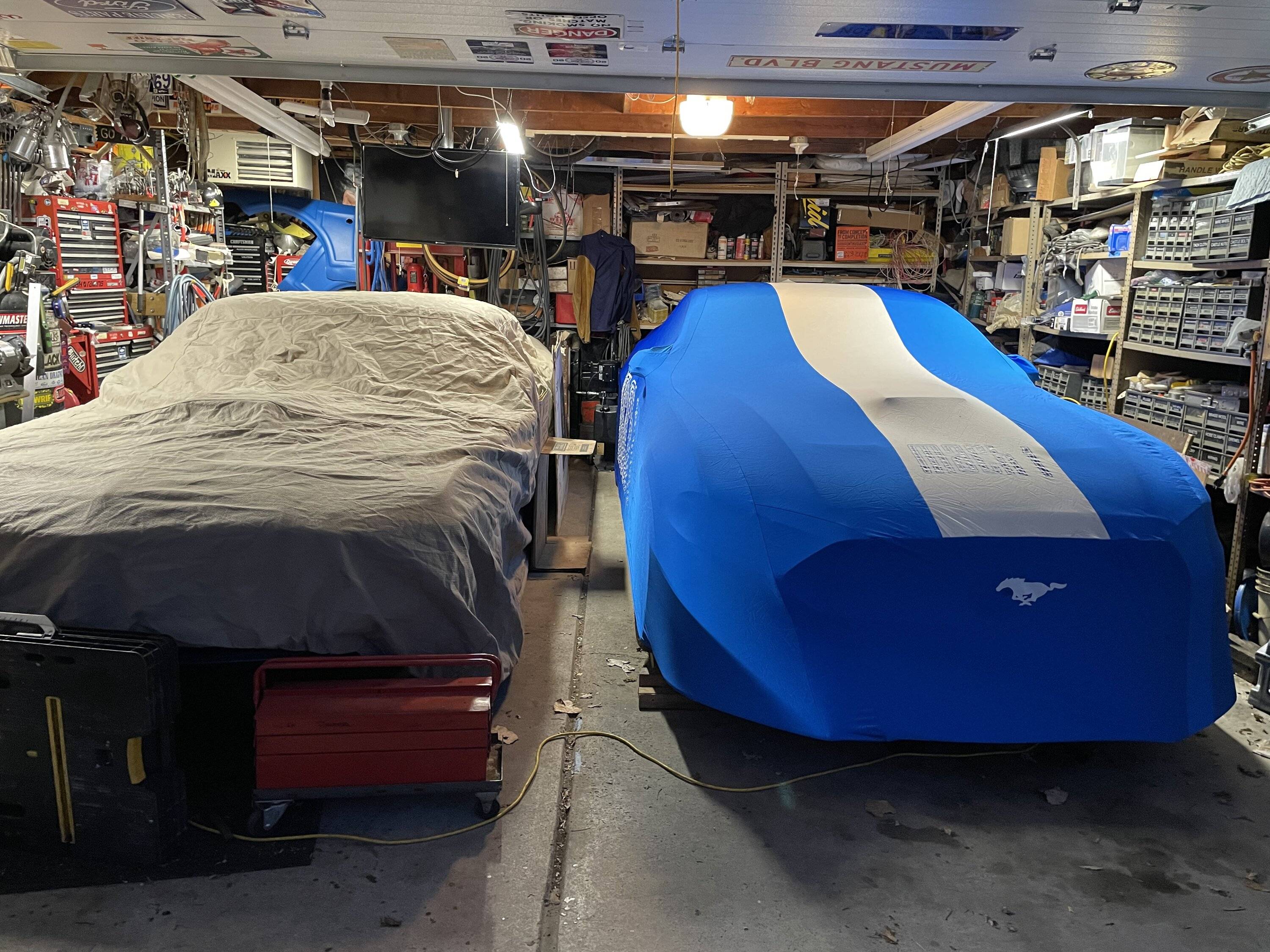

It’s that time of the year in Michigan mustang get a deep sleep.
So quiet with the snow on the ground, you can hear the Chevy's rusting. Sweet dreams, see you in Spring!

I know about 1 picture duct but not 2 pictures thanks.

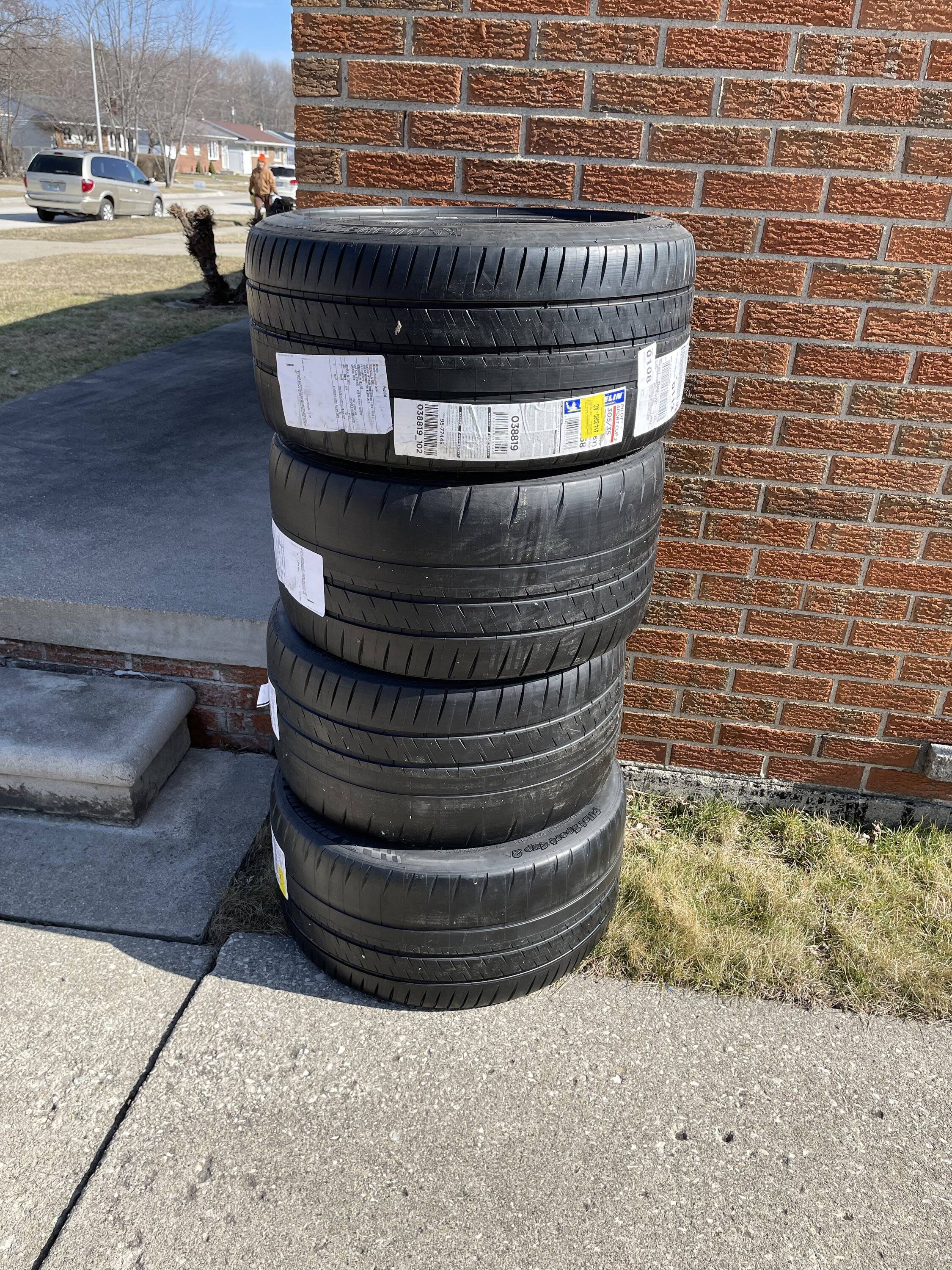

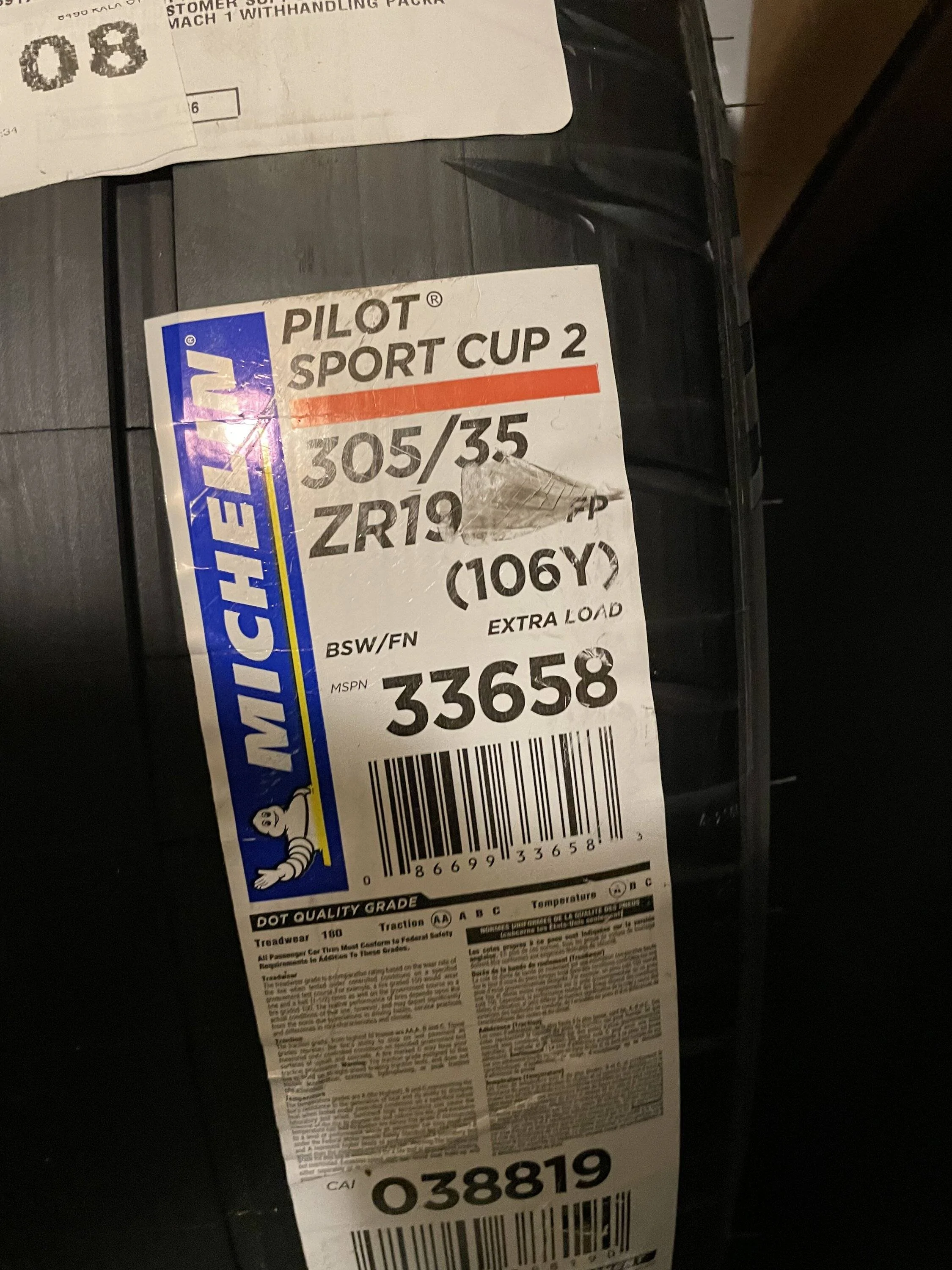

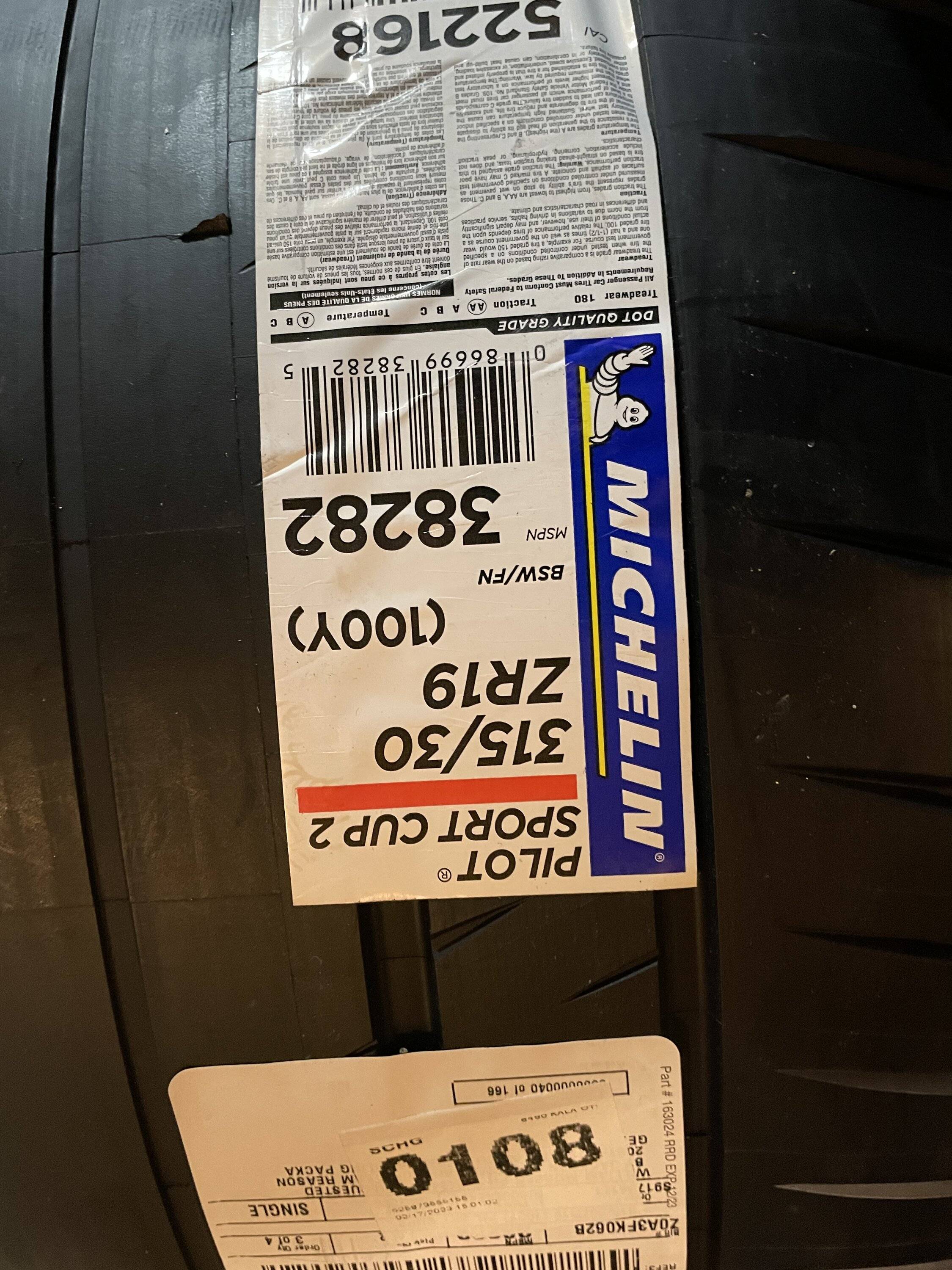

What are the sizes of your new tires?

Damn. Those are bald before you put them on..
That's the idea. Less pesky grooves to decrease the amount of rubber on the road. Great on track, horrible on street.
