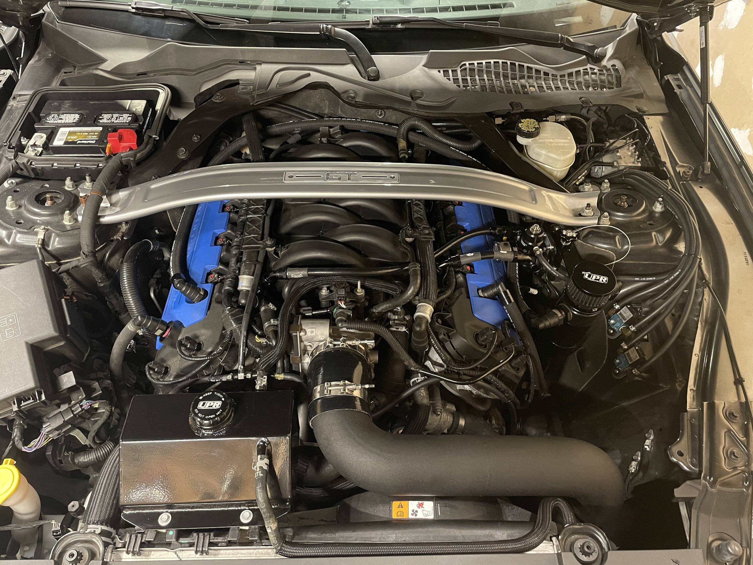

Hello all,
Figured I’d start a thread about my build, I’m still in the process of installing everything. As I’m moving along with the project I will have some questions to pick everyones brain with and appreciate Any positive feed back. This forum has been a great help so far with this project and I appreciate the knowledge and support.
Car: 2015 mustang GTPP
Engine/drivetrain mods:
• Hellion street sleeper 6266 BB turbos HLX screamer inlets.
• Hellion 4-1 turbo manifolds
• gt350 manifold with gt350 throttle body.
• thermal R&D catback.
• turbosmart E boost 2
• SCT x4 (for now)
• lethal stage 2 full return fuel system running twin TI 465 pumps with VMP billet rails
• ID 1050x injectors
• boundry oil pump assembly, black gears, billet gear vane ported, Martin ware treated, with billet back plate.
• boundary billet CS sprocket
• MMR oil pick up tube
• MMR water pump pulley
• T56 magnum XL 2.97 ratio with McLeod RXT clutch, MGW shifter
• GT350 axles
Suspension:
• Ford racing rear control arm bearings
• steeda billet vertical links poly bushing.
• ford racing track suspension kit with steeda ultralight linear springs
• BMR cradle lock out CB005B
• BMR cradle centering sleeves
• Steeda rear toe links
• BMR poly diff bushing lock outs.
I’m probably forgetting a bunch of stuff but that’s the basic rundown.

Question all, while Na I had my gt350 manifold charge motion control valves operational and they worked flawlessly. Is it a necessity to lock these out to run with the turbo kit or is that up to my tuner. Appreciate any advice I will have a lot of little questions like this come up throughout my build.

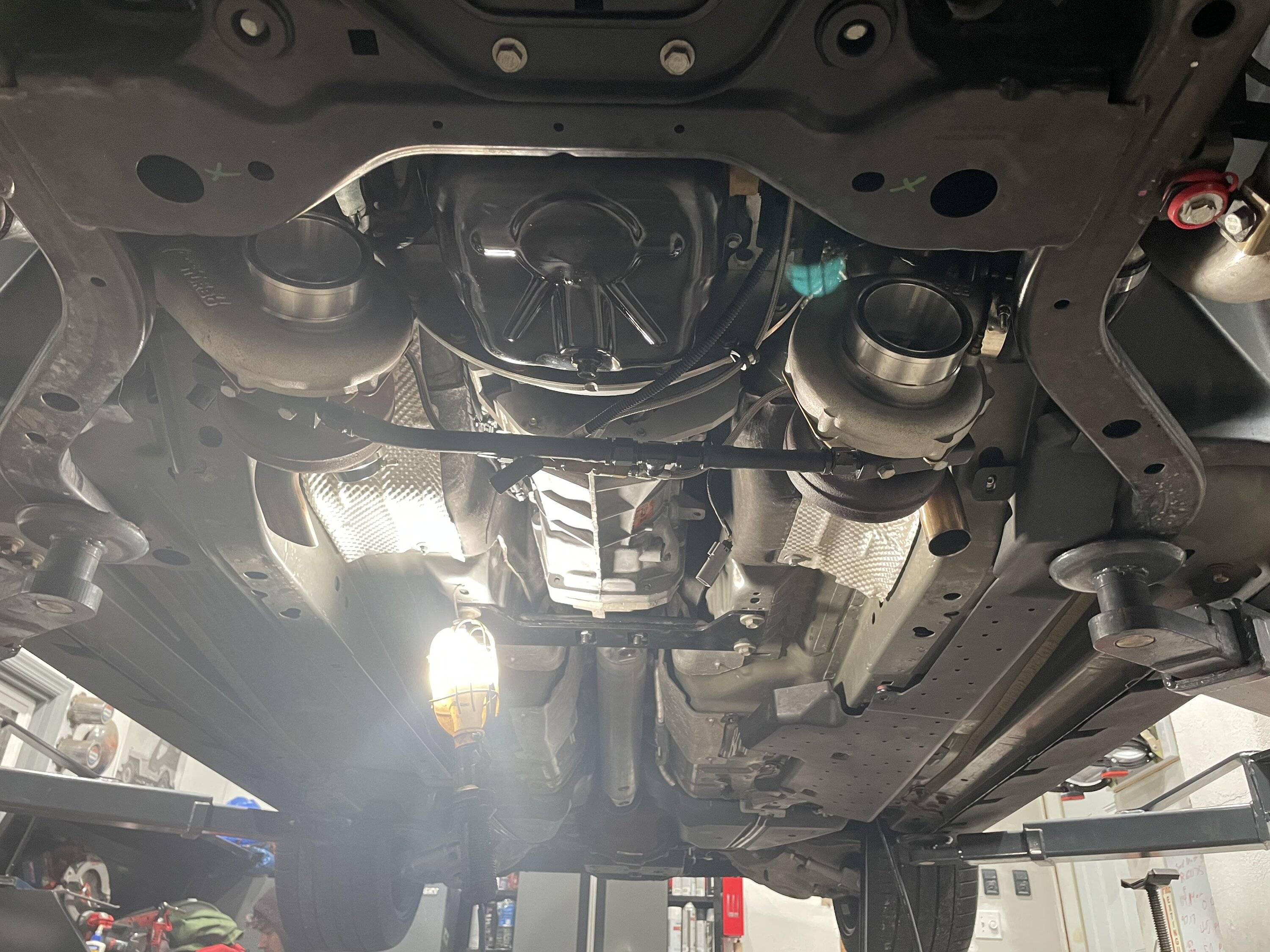

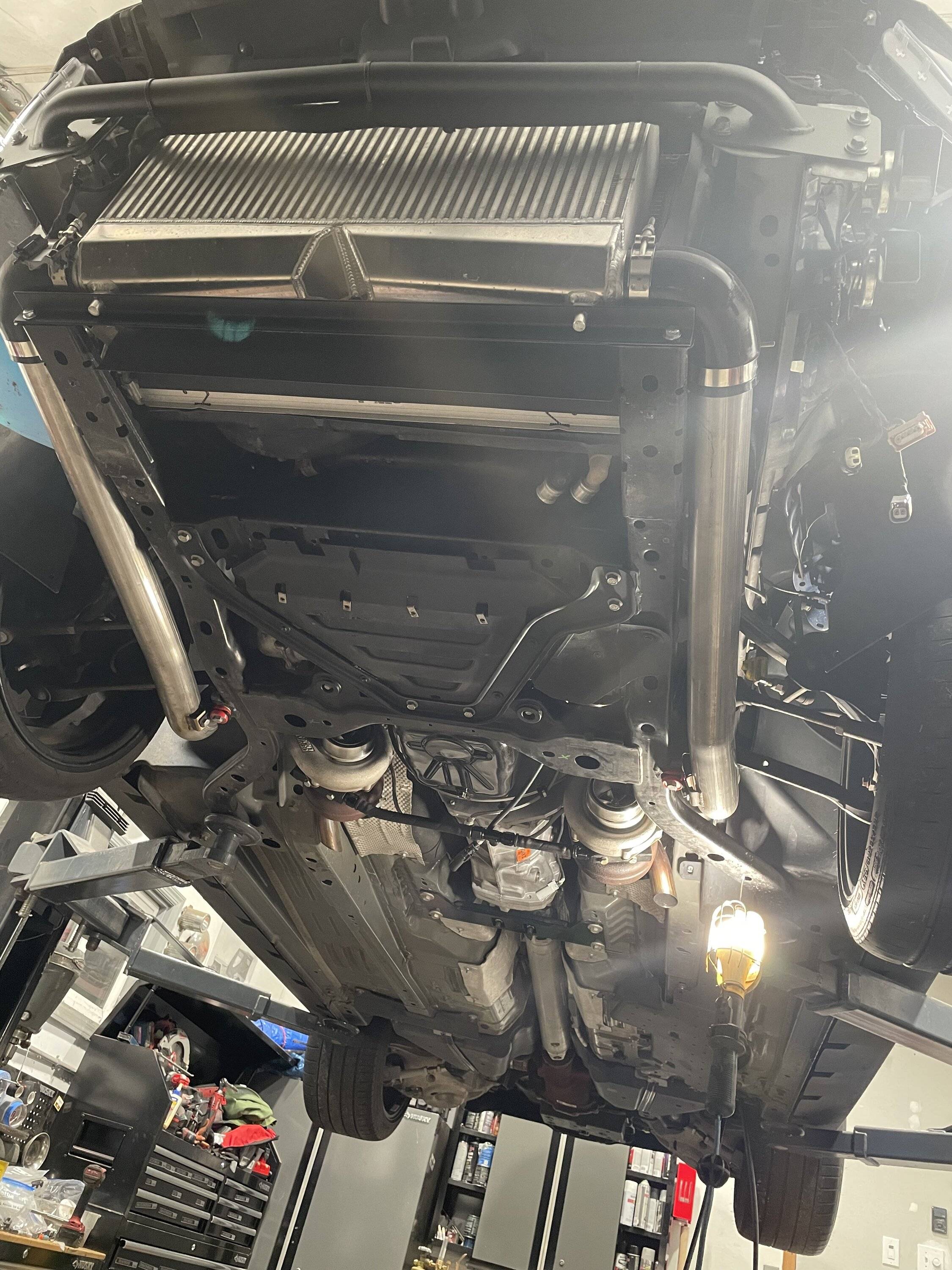

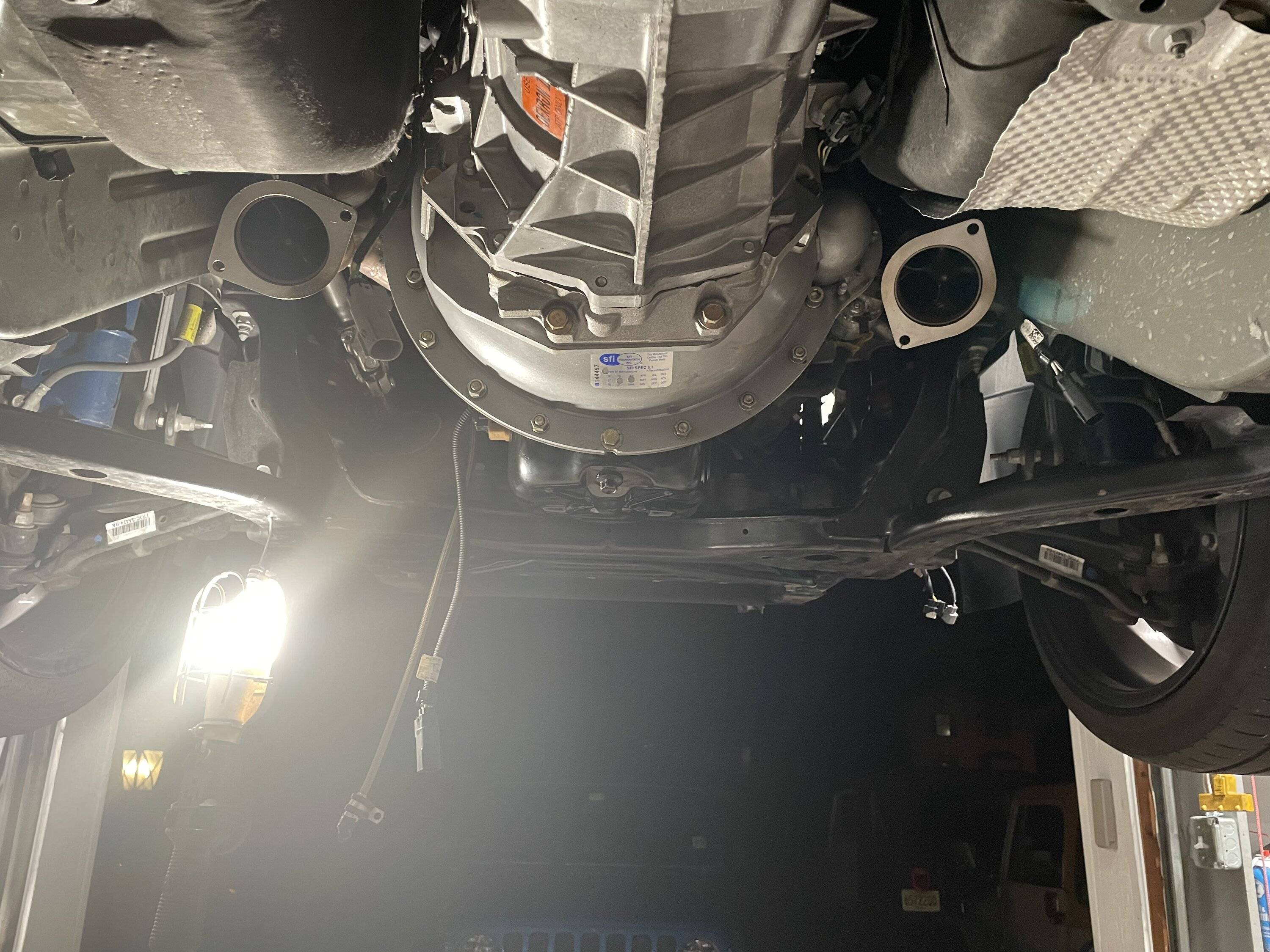

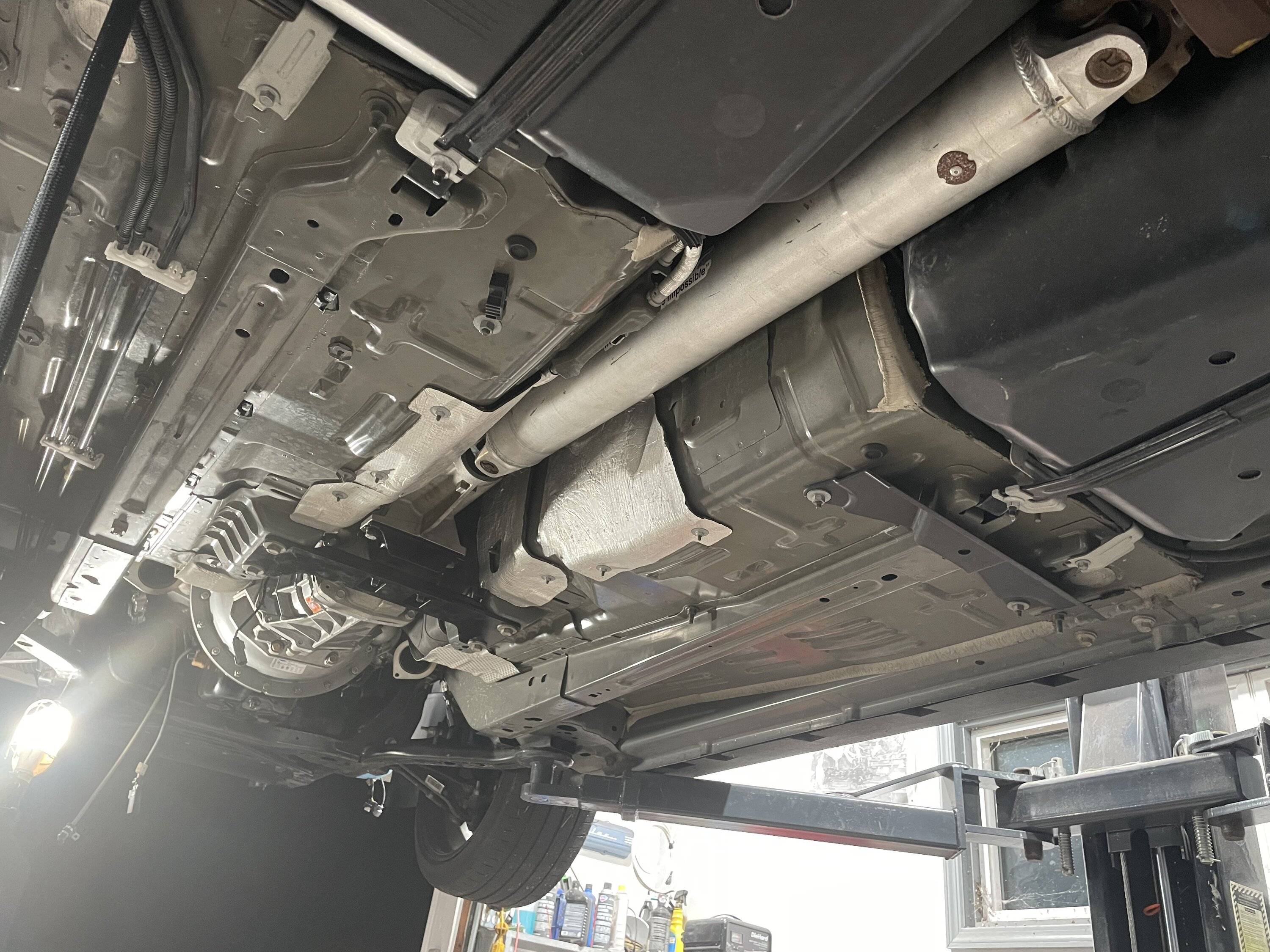

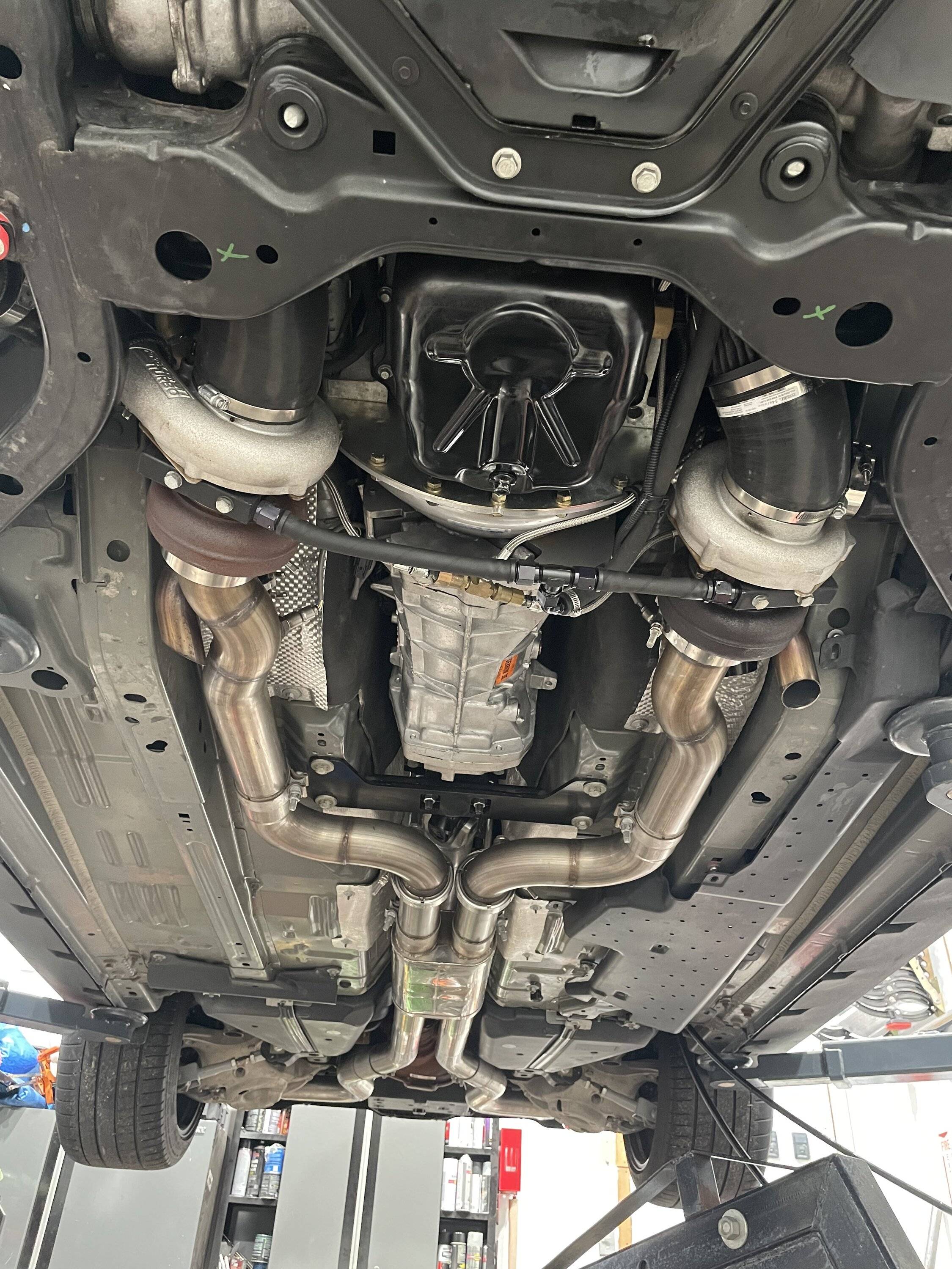

Update. Trans swap, manifolds, turbo and Intercooler piping complete. Trying to Figuring out what I’m going to do for my driveshaft loop situation as JPC discontinued their s550 t56 magnum XL swap driveshaft loop. Going to have to modify or fab something up. Please chime in if anyone has any ideas or solutions. Started on install of fuel return system. Dision X top hat with dual pumps completed started running rest of the fuel lines.
Sorry you didn't get any replies to this. Almost everyone locks out the IMRC's when they go boosted, me included. My Hellion setup runs great with them locked out.
I am no help with the d/s loop with a sitck. As far as the fuel lines, most of us are running the lines under the black plastic cover under the driver side right along with the factory fuel line. If your lines are pre-cut you may need to reach out to the vendor to see how they want you to run them.
