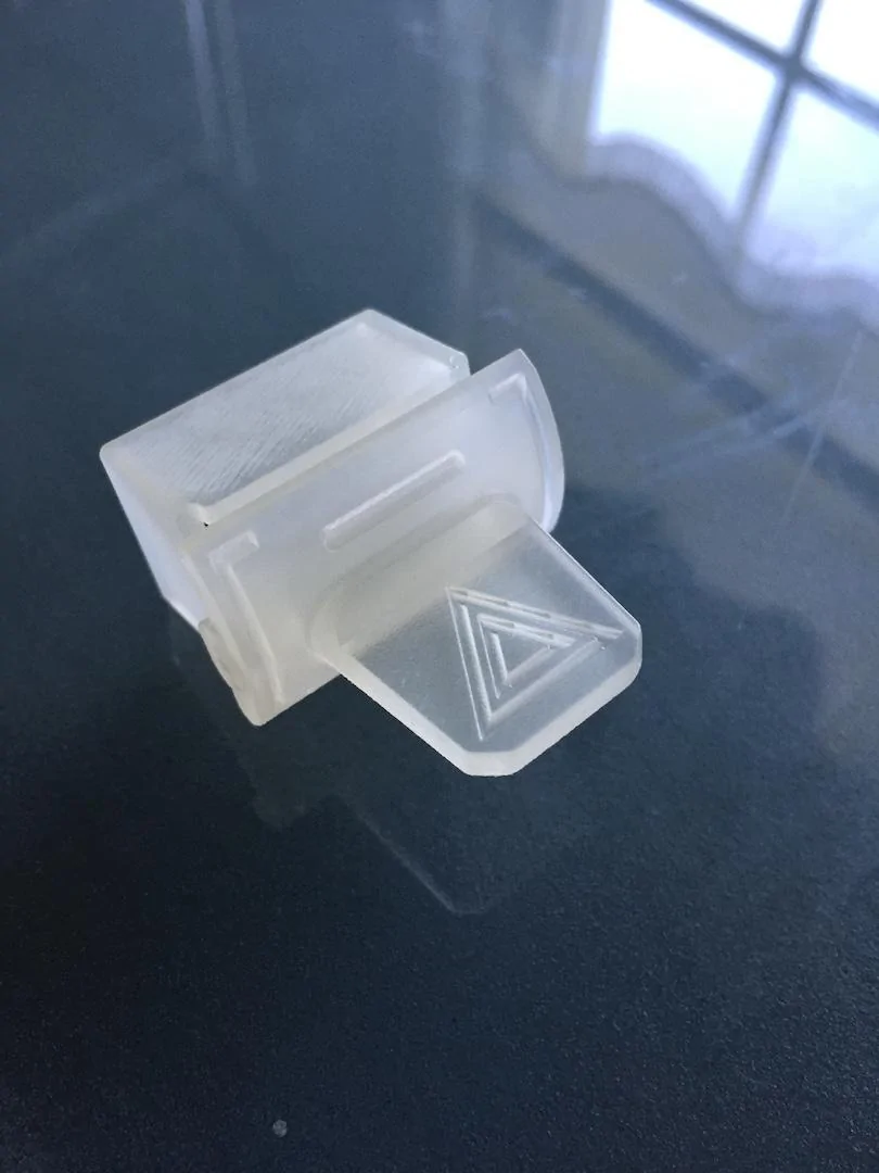

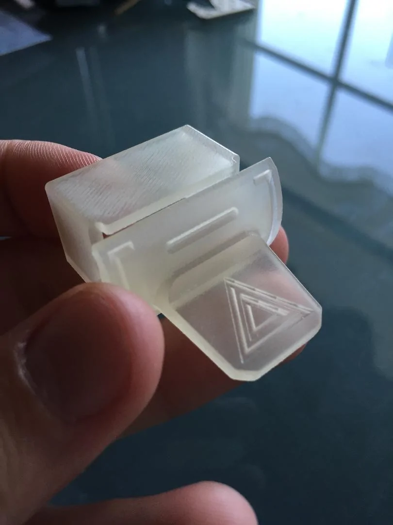

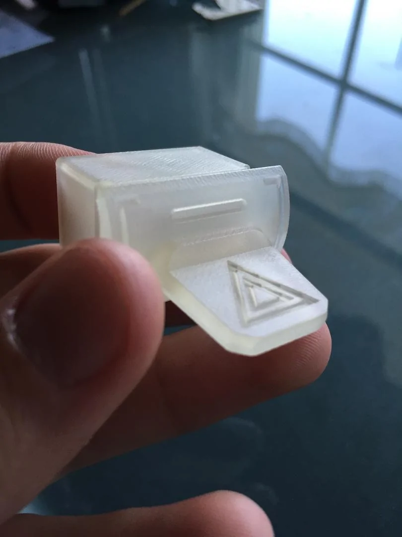

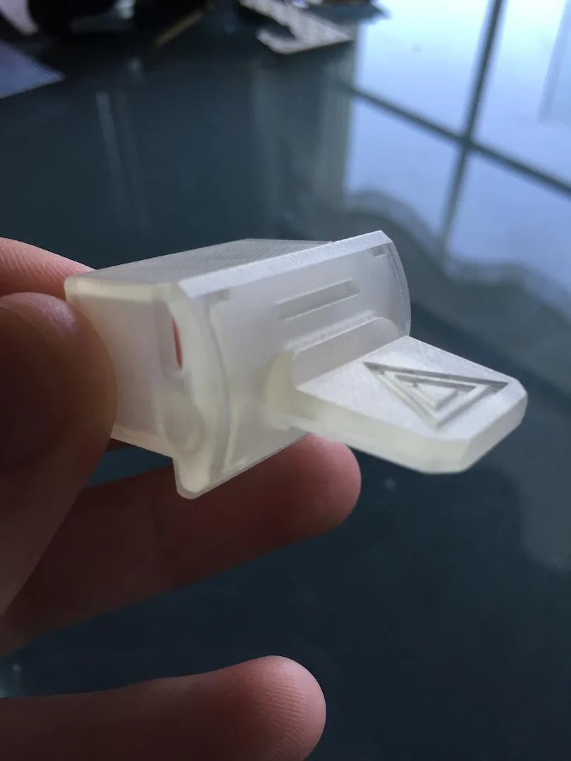

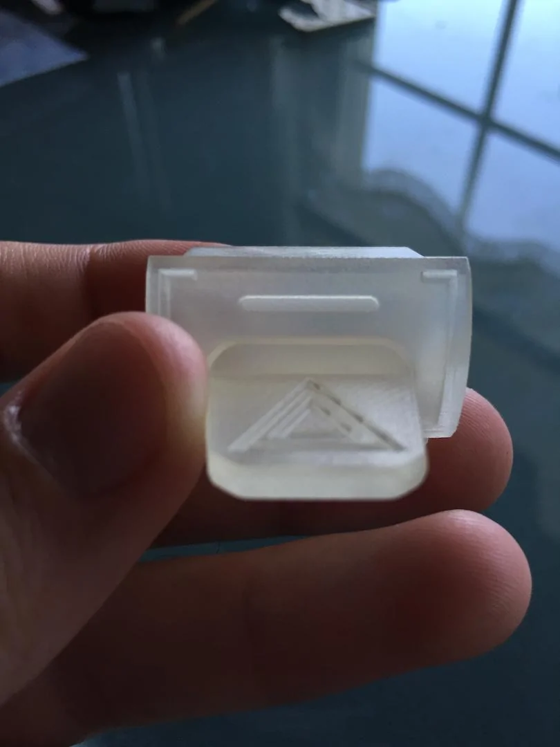

Well guys here is a tier 2 toggle! This one is unfortunately not functional because of the tolerances being to tight... Modified tolerances and ordered another for a functional test!
Voodoo
Elite Member
Oct 18, 2013
713
230
Earth
A Car
What material was used?
zackmd1
zackmd1
Oct 1, 2013
140
5,279
3,407
Maryland
Zack
1970 Mustang, 1965 AC Cobra, 2023 Ford Bronco 2Dr
Frosted Ultra Detail. (transparent acrylic)
There is even a step up in quality called Frosted Extreme Detail. :headbang:
