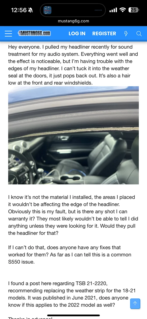

Hello everyone, I was having an issue with the headliner on my 2020 Mustang—it was coming loose on the driver-side door. I brought it to a Ford dealership, and they performed the TSB repair by replacing the weatherstrip. Unfortunately, the issue came back within 48 hours.
When I returned to the dealer, they told me there was basically nothing else they could do and that I’d need an entirely new headliner, quoting me $1,500 to replace it. I wasn’t willing to spend that much to fix it, so I tried the other methods I found on the forums, like using credit cards and a rubber mallet, but none of them worked. Eventually, I grabbed some thin double-sided 3M tape and applied it to all the exposed edges of the headliner. I let it sit for ten minutes with the backing still on, then tucked it into the weatherstrip, peeled the backing off while it was in place, and pressed the edge of the headliner onto the pinch weld in the roof and held it for a few minutes. This is the only method that has worked for me.

Images? I didn't realize replacing a headliner could be that expensive.
This is the issue I didnt have a pic of mine on hand so i used one on the fourms or are you asking for a picture of the qoute

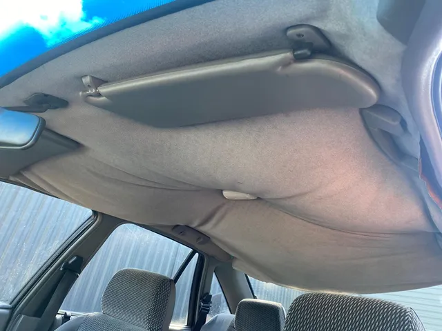

That would have been useful in the original post
When people say 'headliner sag' they usually mean this:
