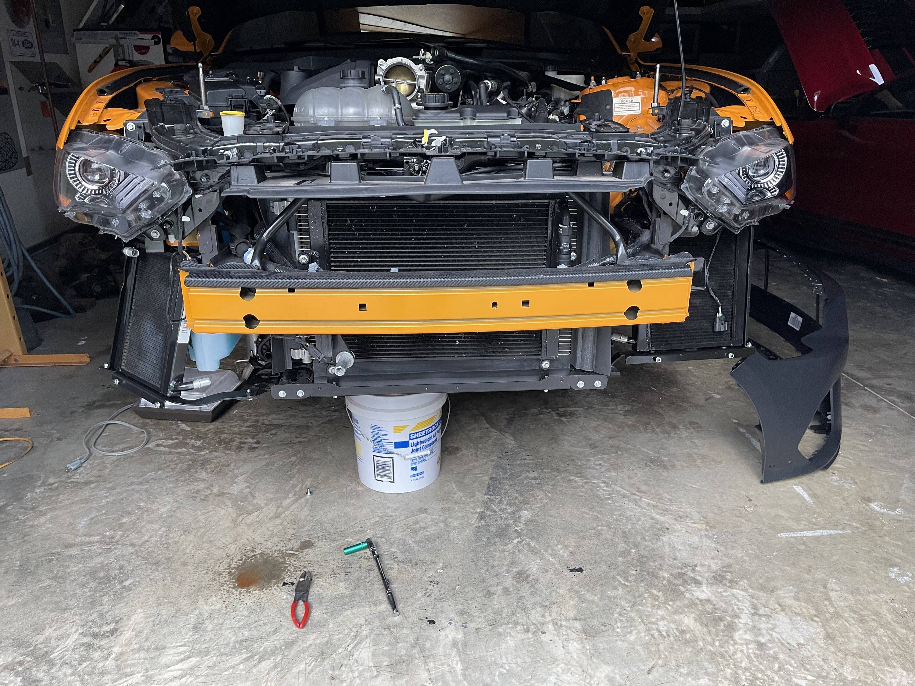

Well, no such luck today. I'm starting to be at my wit's end regarding this problem.
Got my new pump in today, a direct replacement Bosch 0392024058. Plugged it in, no power, went ahead and refilled the cooling system and ran it around for a couple of miles several times to get all the air out, but still no such luck, iat2 still 180+.
Wiggled any hose I could find to help air escape, the intercooler hoses, and the pump hose connected to the coolant reservoir by the washer fluid, but nothing. No leaks which I guess is good.
Double-checked, triple-checked voltage, 0v off, 12v on. I re-pinned the plug several times to make sure it was correct, but nothing. I even took out the pins and placed them on the pump directly, but nothing once again.
Unless I am extremely unlucky and got a dead-on-arrival Bosch pump, I'm out of ideas. As much as I love working on cars, this one has thrown me for a loop. If anyone has any insight, I would be more than happy to listen.
Most shops in OKC are 2months out for vehicle work so I'm afraid having a shop look at it may be my last resort as I do not want to wait that long.

Wanted to give everyone an update.
I double checked everything again, everything looked to be installed correctly and looked to be in good condition. I jumped the old pump from the battery and it powered on so instantly knew it was an electrical issue.
I went ahead and replaced the relay because I know that those can go bad and that ended up being my issue as well. It looked to be that the relay would switch on/off with power but couldn't hold the amperage required for the pump. So, even if your relay is switching on/off correctly and looks to be good, go ahead and replace it, most likely will be your issue.
So, now the problem is fixed. I have a spare coolant pump now for absolutely no reason which is fine. FYI for anyone curious, the VMP upgraded pump is the exact same pump put into the phase 2 Roush kits for 18+. You can find them cheaper than VMP.
