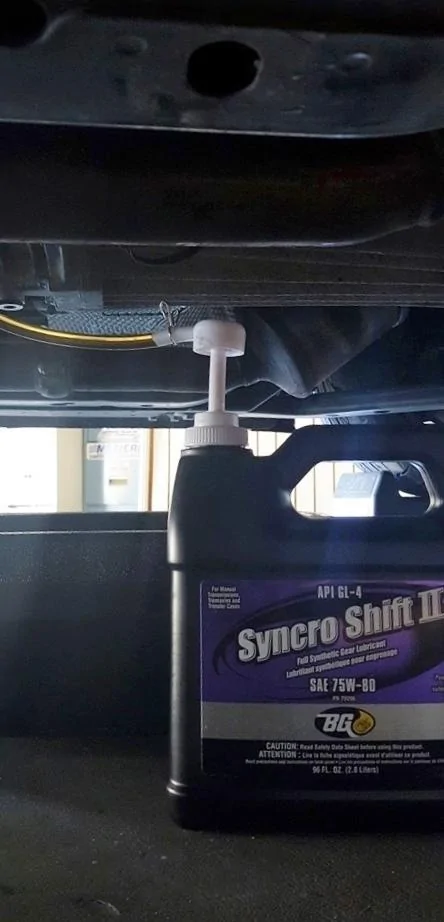

1. So many OEM dealers use BG Products it would be unlikely.
2. If they send a sample in for testing it would just come back "really good"
3. It's Amber in color so it looks like factory fluid.
