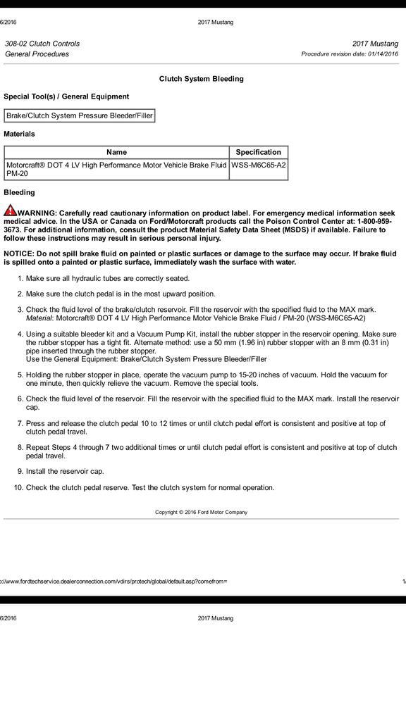

There is no bleeder on Mustang hydraulic TOB. To bleed you need to apply vacuum at the reservoir let it hold at -20" for a minute, release, pump pedal 20 times and repeat. You will feel a difference in the pedal if air was still trapped. Repeat until pedal is firm. One other issue with the Hyper single is that the bearing is nit close enough to fully release the clutch and a .025" spacer behind the TOB is needed to allow full engagement. Good luck.

Maybe this will help
