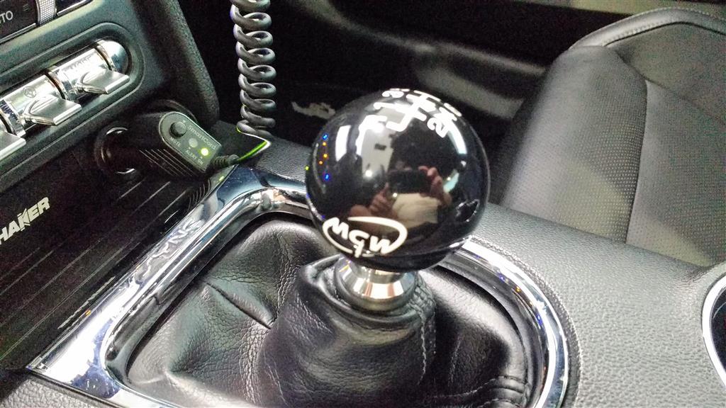

It's done. And I'm done. I mean totally spent, I can barely type. "An hour or two" my butt! Took me 9 freaking hours in my 94-degree garage. Pics or it didn't happen! One crappy cell phone pic attached.

I went for a short drive and so far, it's what I was expecting. NVH went way up vs. stock but that's to be expected from a solid-mount shifter. Now I actually feel connected to the transmission...what a concept for a sports car, right? Ford failed with the stock shifter. They went all minivan mommy with the stock shifter. Very little NVH translates to "Where the hell is 3rd gear?" in a sports car. I won't be resting my hand on the shifter anymore, that's for sure. You're not supposed to do that anyway. The stock shifter was numb, no feedback, no accuracy...it sucks. Not telling you anything you don't already know about the stock POS shifter. Also, as I had hoped, the
MGW shifts are like manipulating a bolt-action-rifle. :flag: It's a solid "snick" into gear. Definitely takes more effort to shift now.
Funny thing I didn't consider: I will have to relearn how to drive the damn car b/c now the shifts are shorter, the shift action itself, way more precise, and the knob is a different height/different material. My first few shifts were...unimpressive. LOL! I even said out loud "Holy crap, do you even know how to drive a stick?" But being that I have a long work commute, it shouldn't take but a few days to get used to it.
The actual shift action of the MGW is just laser-precise. It demands your attention and rewards you with speed and accuracy. The stock shifter says "Yeah whatever, 1-2, 4-5...it may go in, it may not but you won't feel a thing either way."
