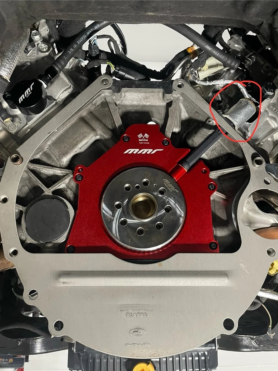

I think I paid $2300 for my Ram Pro Street cerametallic twin disc. I mentioned replacing the rear seal. I purchased the MMR billet rear seal plate and seal combo. The seal looks to be of a much higher quality than the OEM. One more thing that would be a good idea to replace while the tranny is out is the crank position sensor. You’ll see it in the pic with the billet rear seal plate at the
1 o’clock position.
