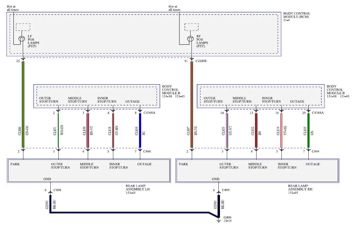

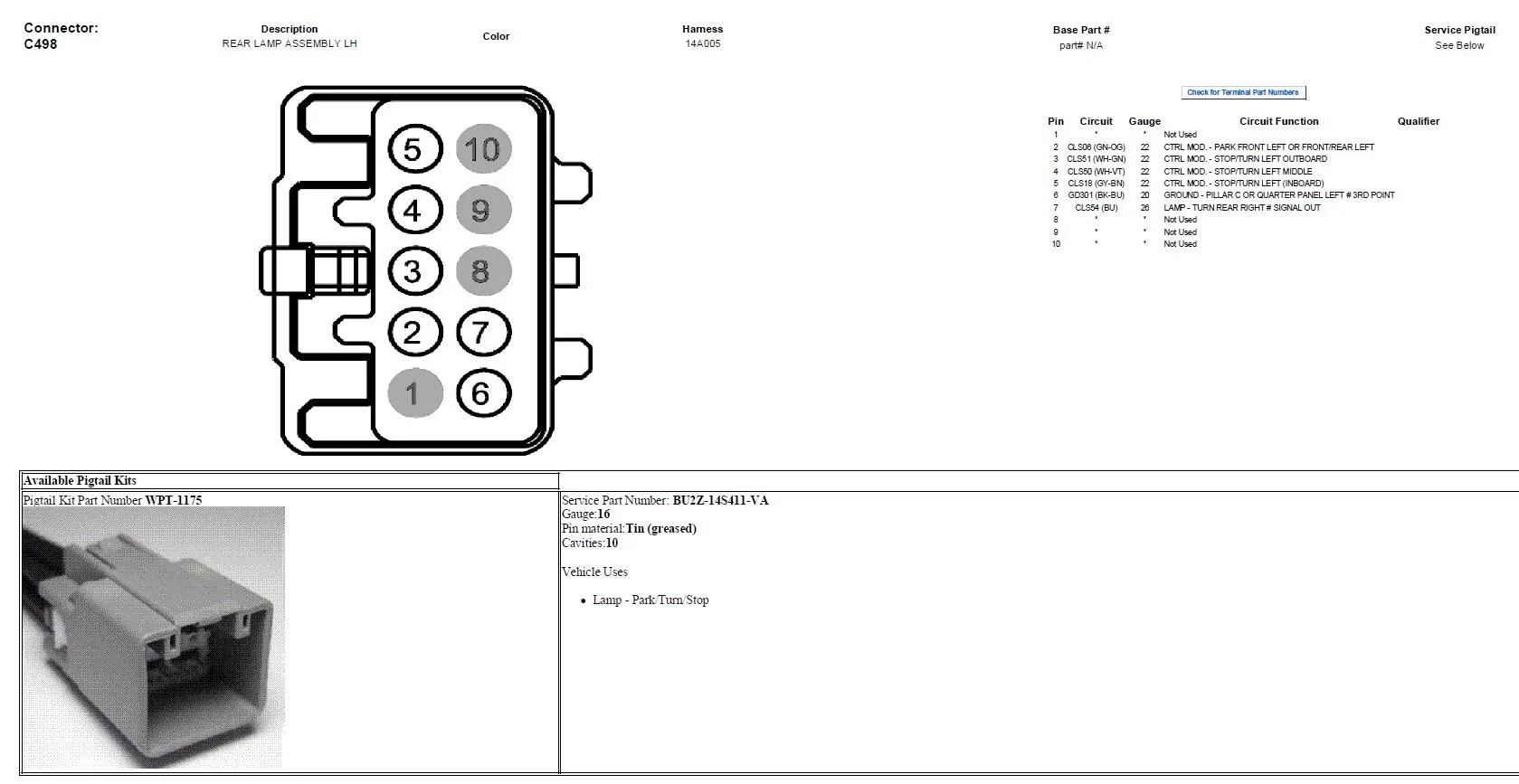

2020 Mustang tail light wiring.
Awesome, thanks!! I think I need #2 for the brake light, but any idea which one might be good for a DRL? May not even be possible so I understand. Thanks so much for the post though! Between watching the install video and matching the pins from what I could see, I might have figured out and will post what I find out.
