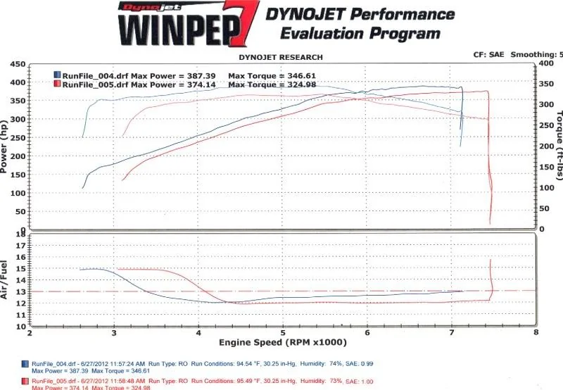

Dyno numbers Boss 302. With and without track key

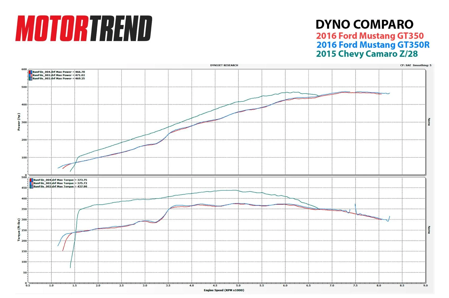

Ah, no it doesn’t, not even close. Look above at post 145 for the overlays of both engines. Who told you this?
I think the dyno plots prove my points. The Voodoo has a very wide power band. And the Voodoo makes more power at low RPM than the LS7. The LS7 power production drops off really steeply at low RPM near idle.
Yes of course at a given RPM a much smaller displacement NA motor won't make more power than a larger displacement NA motor.
However, if you pick a power level that both engines achieve and compare how wide the RPM range is that each engine makes that power or more, the Voodoo has a very broad power band - just like I said before.

Go back and study the numbers. You state that “the voodoo makes more power @ low rpms”. The LS7 is in green.
Nobody is going to lug an engine under 1500 rpms.
