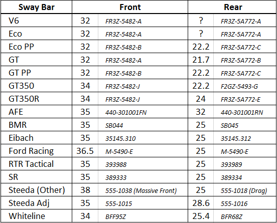

I'm trying to get a handle on the part numbers and differences. It appears that the number is the same except the suffix. From the chart I saw the size is the same so it must be something with the stiffness or some other subtle difference. A to B to C (on the rear)
Is it worth changing from a 22.2mm bar on a v6 to a gt 22.2 bar? I had planned to go ahead and buy a GT350 or GT350R bar but there is questions on the part number being different when I look for them.
Do you have any additions or changes?

Looks like the difference on the bars of the same diameter is the length of the mounting arm. I will measure my V6 bar against a GT bar I have.
The Ecoboost PP rear size is 21.7 mm...I know because I had the one that Chef gave me off of his car.
That means that the V6 and Ecoboost regular suspensions are the 20.0 mm size.
BTW...convertibles have smaller sizes for the rear bar. The standard GT rear bar is 20.0 mm. My hunch is that the other verts have the same size rear bar too.

Well the tag on the GT bar I have (rear oem) says 21.7 The number on it is FR3C-5A772 BB
The one on the car V6 is 20.0 and the number is FR3C-5A772 AB
I would say you are right about the Eco being the same.
So I think I will put the GT bar on and try it. Not sure who made the chart above but it needs to be edited.
