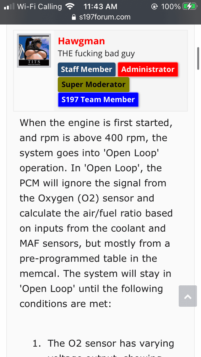

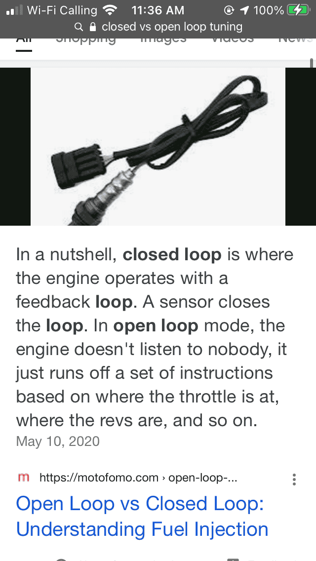

Old s197 but evidently in open loop the o2 also is ignored. Open loop happens during warming up and wot.
closed loop/open loop

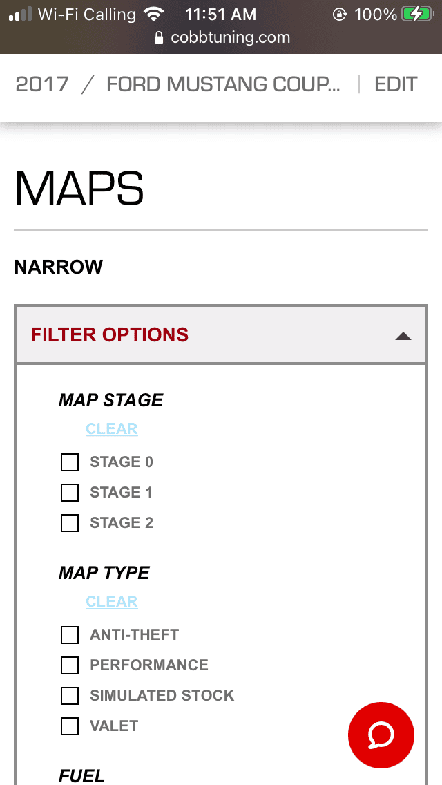

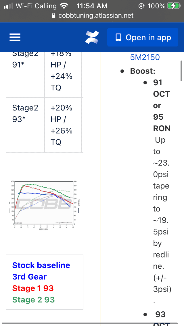

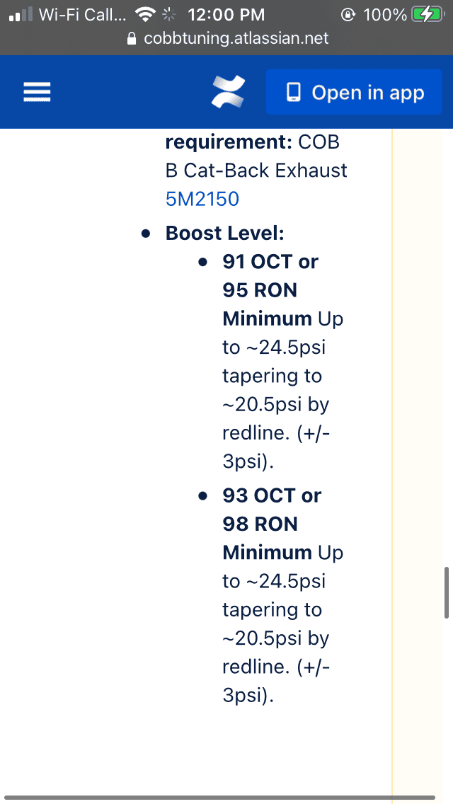

On cobbs site under maps, it shows you the psi targets etc under maps
but! I put 2017 ecoboost and I can only find 1/2 stage
stage 3 is completely removed. Trying to find thepsi targets you should be hitting I think it’s 24.5 tapering to 23

Map notes for all years, I posted the 15-17 notes above
https://cobbtuning.atlassian.net/wiki/spaces/PRS/pages/98417021/Ford+Mustang+EcoBoost+Map+Notes
I can’t find stage 3 anything... epa made them remove all the downpipe altered tunes if I had to guess,
stage 2 for 18+
24.5 psi tapering down
I've seen this before as well. The AP will show the highest and the lowest numbers on the gauge. So if it peaks at 24.5 it would say that. But it doesn't it shows 20.5 so the peak is 20.5. which is 4lbs off.
I just think this tune isn't great for the EB. Especially since they took it down.

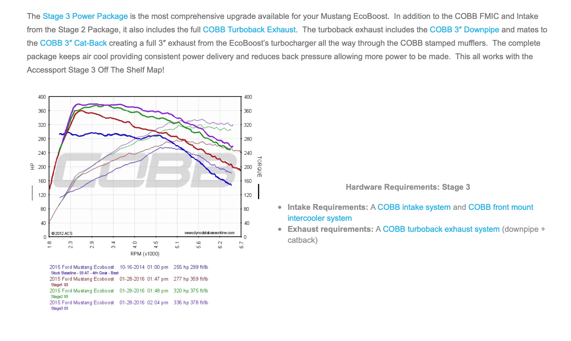

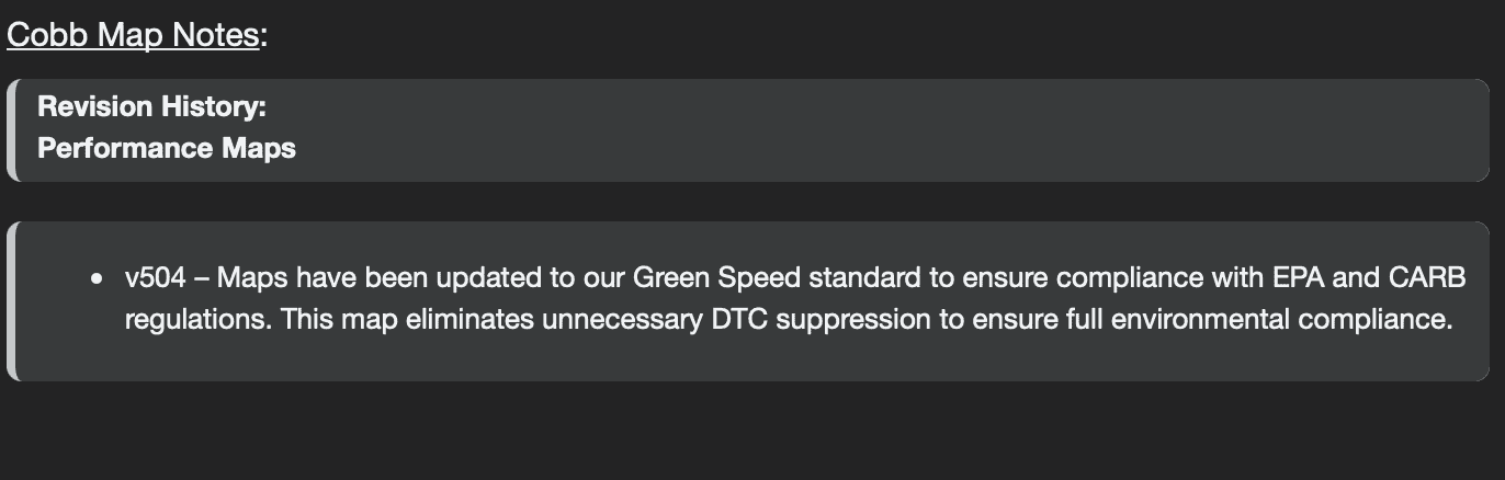

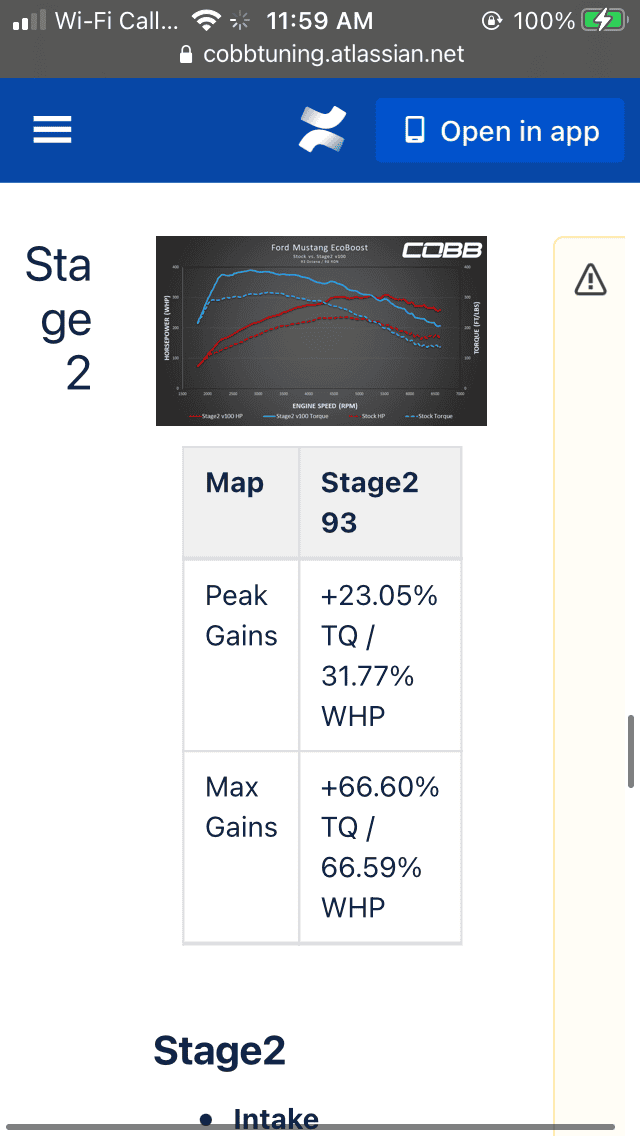

no. they've had stage 3 for years. its due to emissions, the day after the epa stuff happened with LUND etc, they ripped off stage 3, and updated Cobb with "new epa" compliant maps.
stage 3 is gone for good. due to altering emissions. everyone was frantically panicking, clearancing all the hatless downpipes, pulling tunes, they changed all the tunes to "epa" compliant, on mustang ecoboost.net they was all talking about it. people feel like the new version of the tunes are possibly weaker than the old ones due to emissions.
Cobb 3 maps disappeared when this patch happened.
here was the stage 1/2/3 comparisons., there was a stage 1/2/3 for all years, now all of them are gone. they are offering only 1/2 now. guess stage 3 is going to have to be a pro tune here on out. the big boys aren't risking epa knocking on their door after lund/dieselbrothers, etc all got sued.

I'm not surprised. I figured I would have to get it pro tuned. I was already looking for tuners near me on lunch. Lol
