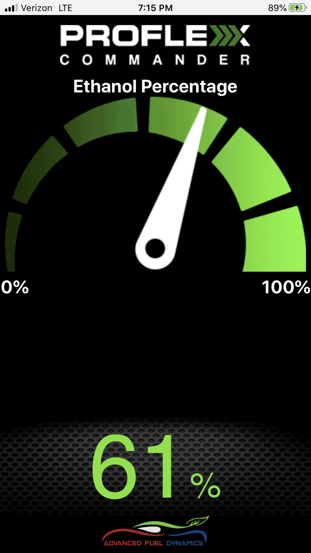

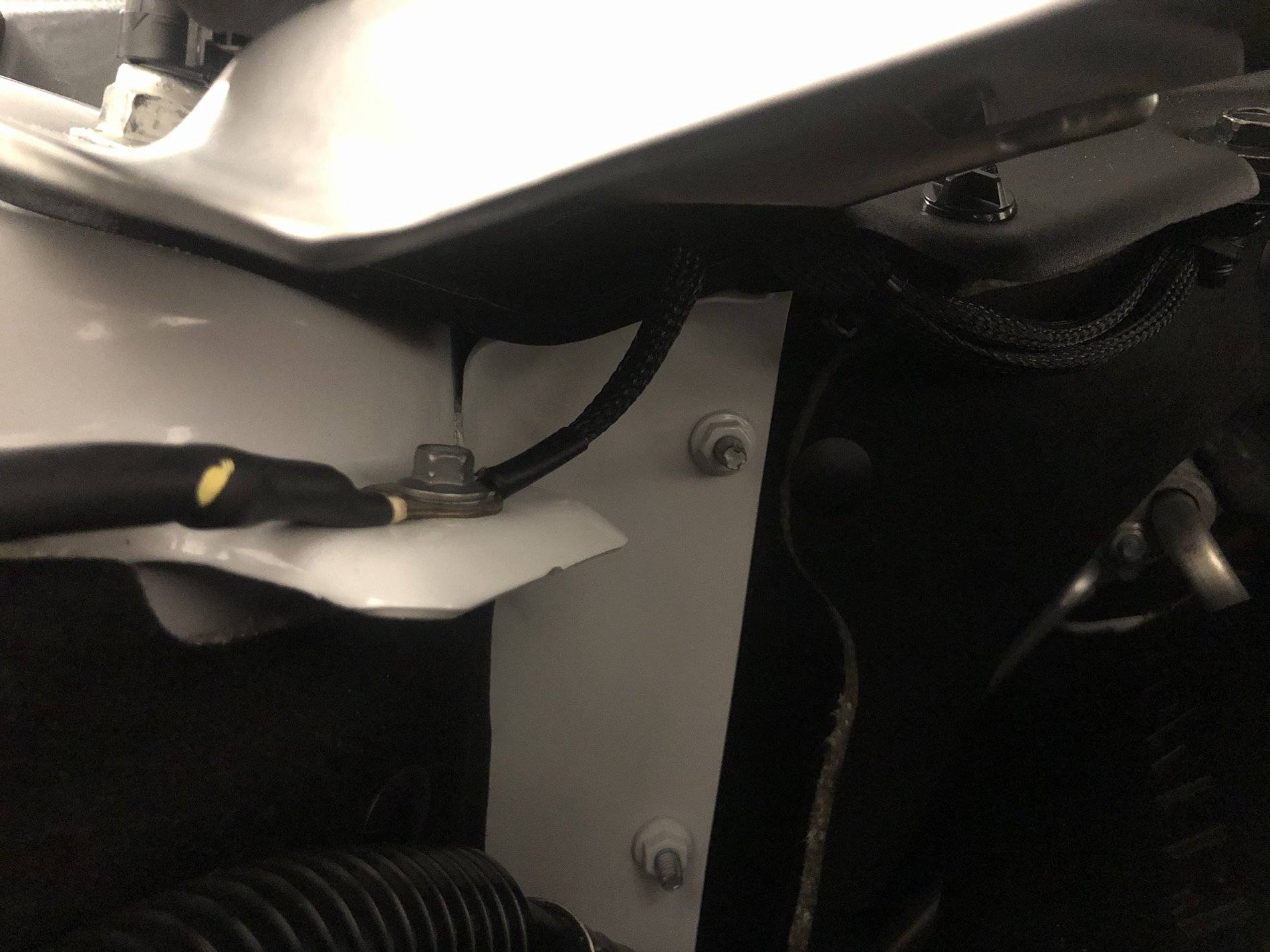

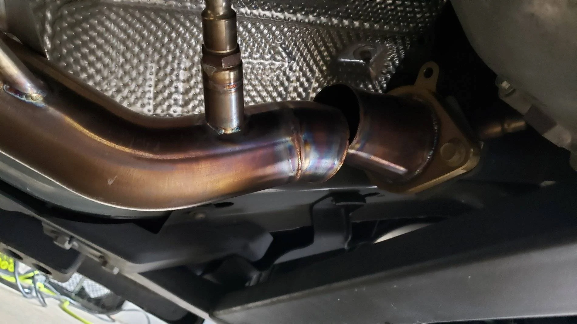

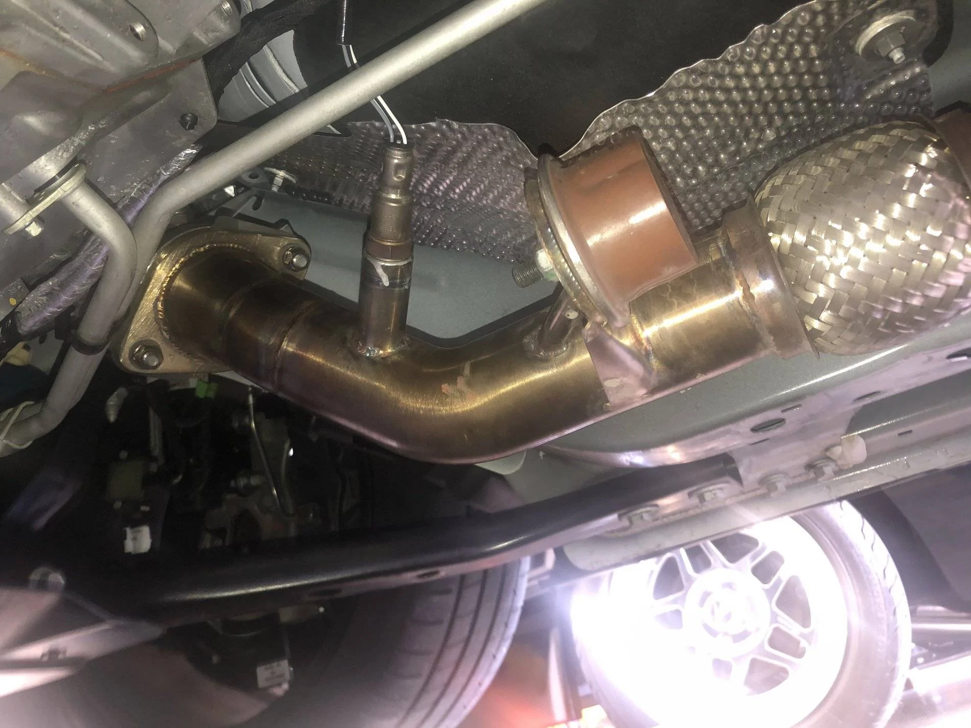

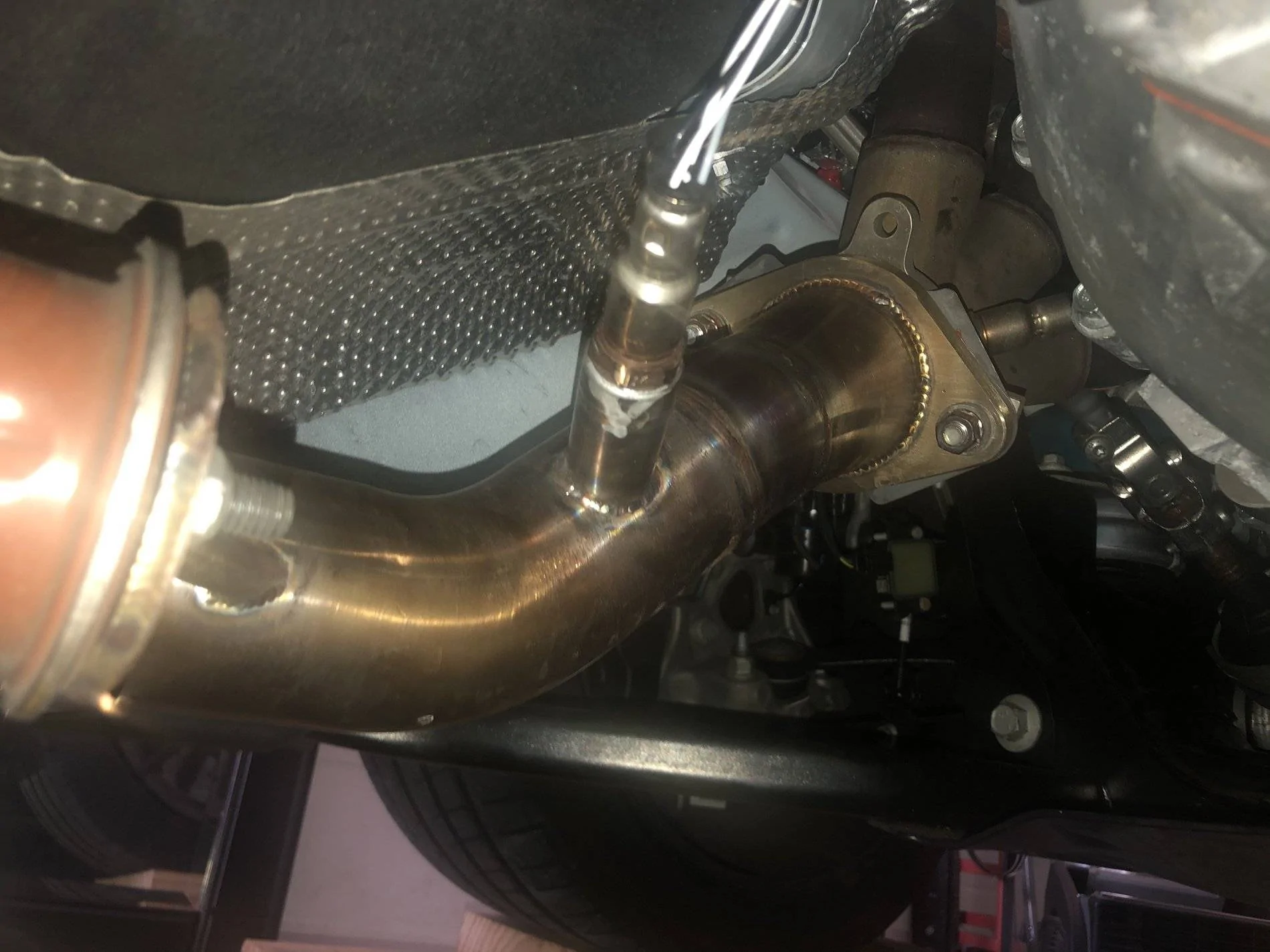

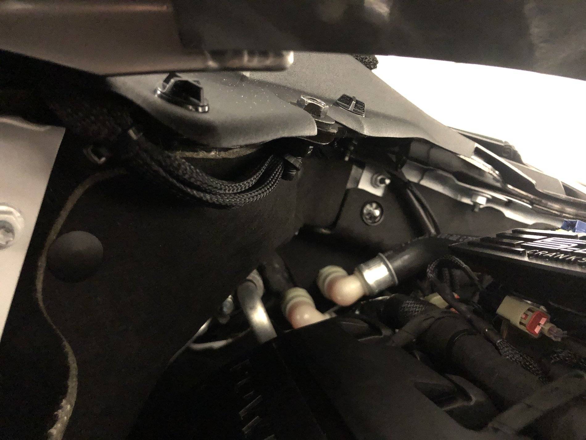

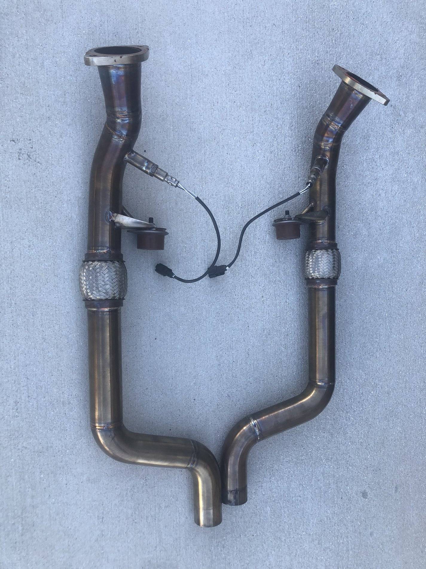

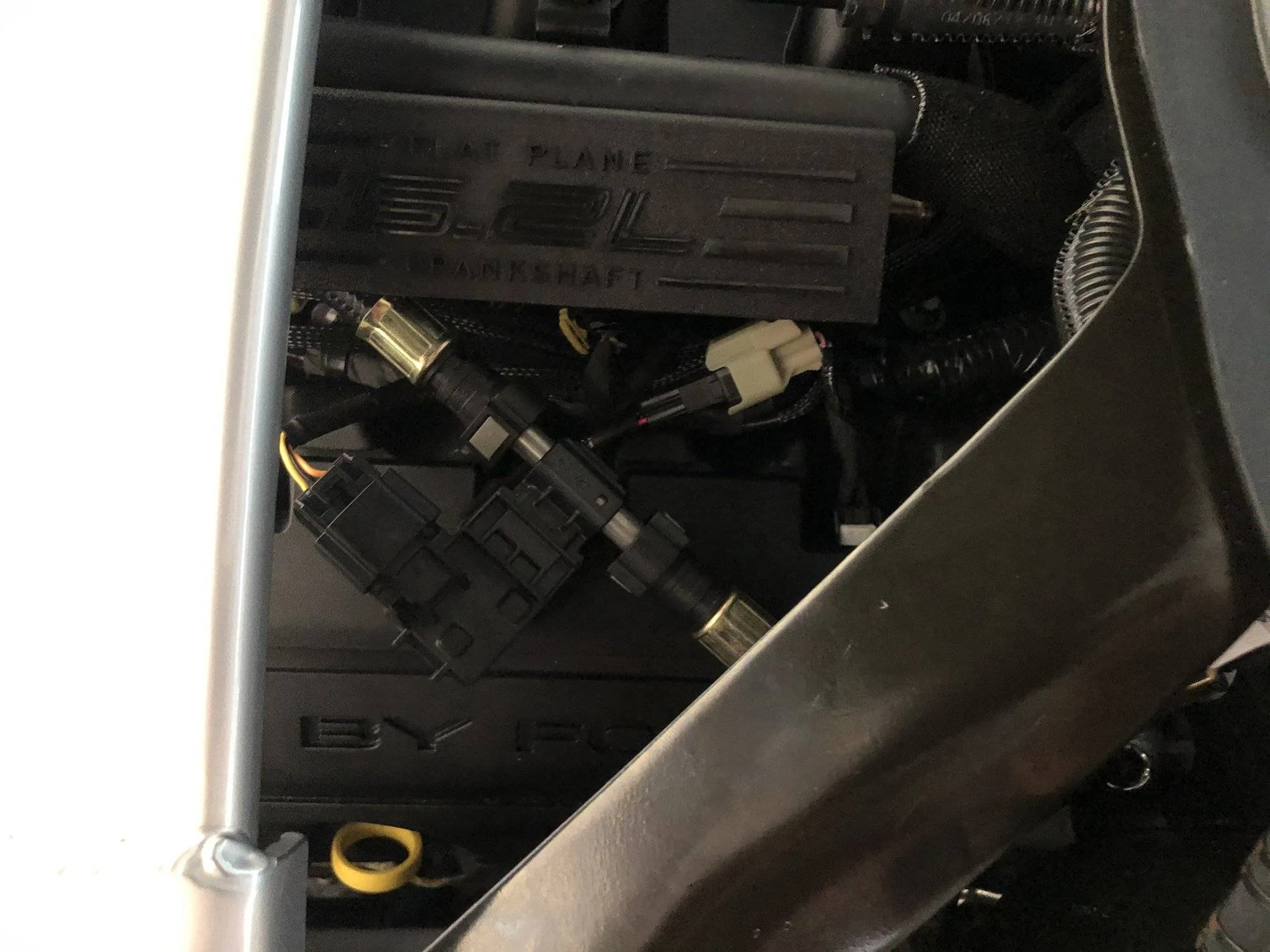

What’s up guys, picked up this 2018 GT350 couple weeks ago, had 5800 miles on it and is optioned with Recaro seats and mag ride. I already did a few ”no tune” needed mods. Also will be doing a few other mods to see what can be made on the OEM calibration. So far I Installed a Proflex Commander and BLine Cat deletes. Car feels really good. Will be putting it on a dyno soon. Car is currently at 60% ethanol and it definitely feels snappier off the rip compared to pump gas. Here are some picks of the mods. Cat deletes I found used. I tried to run the proflex wires as clean as possible. You’d never really know it was installed. Excited to have some fun with this car. It’s an amazing machine!

I have the ProFlex and B-Line cat deletes as well. Be careful though, weld on one of the cat deletes just popped last night.

I'm not too worried about it. Will cost less to have a weld shop put it back together than shipping back to Bline. Turning wrenches to put it back on is easy enough. It cracked super clean right at the weld.

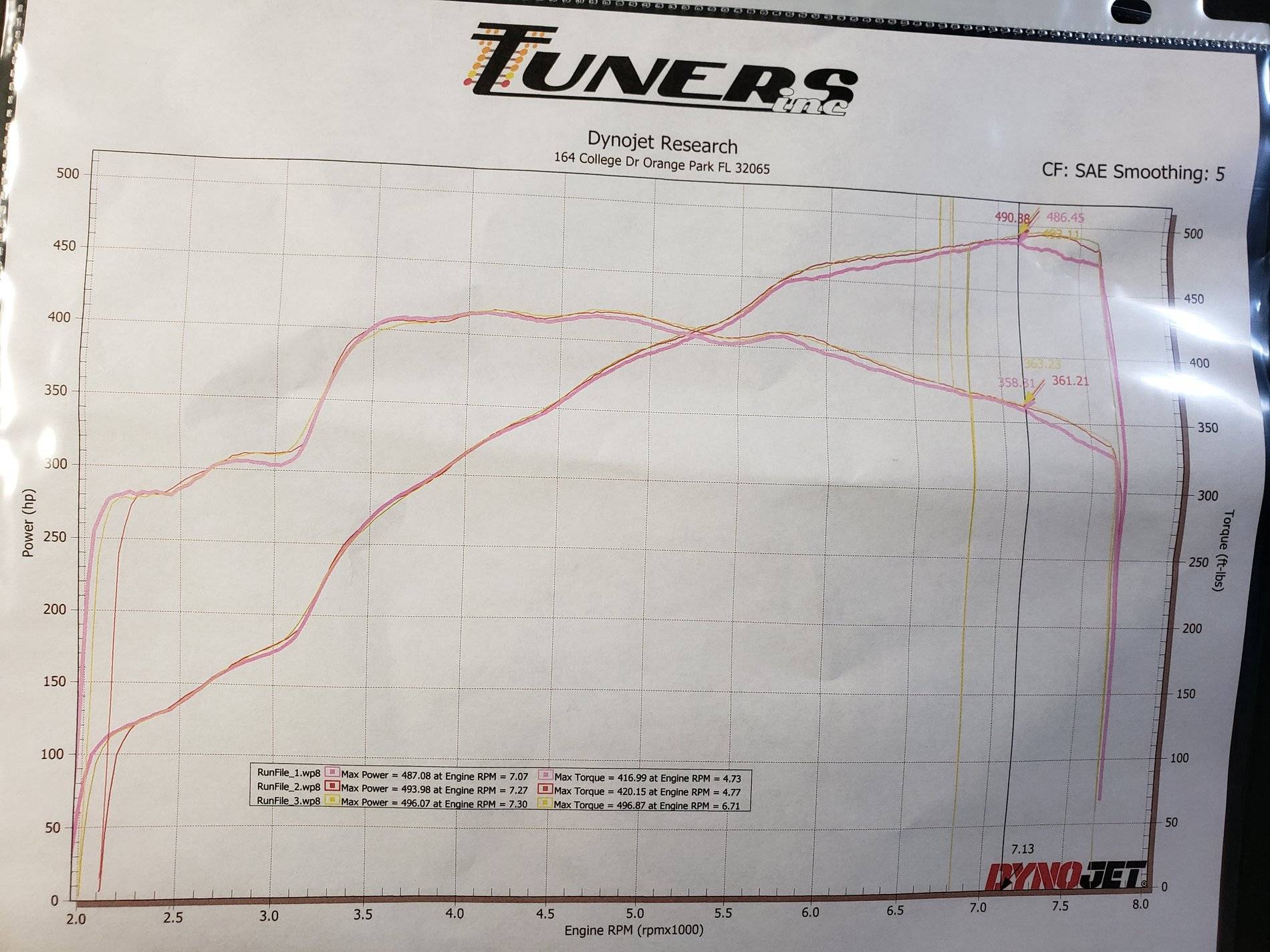

On a different note, with cat deletes and Proflex running 73% ethanol I put down 496 hp and 420 lbs torque at the wheels.
Very nice. What kind of dyno was that on?

Very nice man! Fantastic graph. Nice that it was in SAE. I’m in Florida also.
"SAE" top right of his report.
I have been purposely trying to stay at 60%-ish on my e85. Over that and i get more up-shift pops and i feel like it loses a bit of the throaty sound. I don't notice a big difference in throttle response at 60% compared to upper 70's.

btw, where did you end up putting your proflex unit? On side of battery box?

Yes I know lol. That’s was said it’s nice to see an SAE number haha
Yes it’s in the battery area up against the side of the battery container on velcro.
