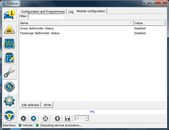

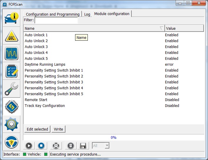

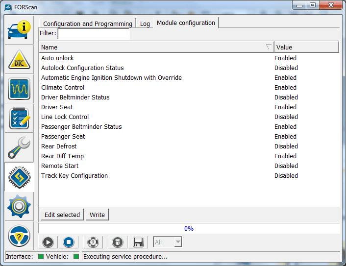

Attached is what I can see in various modules ignoring the As Built ones. Order of images is BdyCM, IPC and then RCM. I already tried enabling Line Lock. It shows up on the Track Apps menu but is greyed out. I assume I'm missing data elsewhere unless there is a particular start up sequence and drive mode you need to be in for it to work?
Diff temp was already enabled in IPC, don't see it anywhere, do the US delivered cars show that in the Engine info screen?

1. you need to be in track mode to use line lock if I remember correctly. if you for sure have the hardware, i believe it needs to be enabled in ABS as well. not sure where it is. don't have mine available, if there a non-ASBUILT config for ABS available to you? try going to track mode, and seeing if the line lock option isn't greyed out. If it is still greyed out, try enabling in ABS.
2. diff temp isn't on my car (manual). it's on gt350s I think, and can be enabled on auto cars (that have the sensor).
3. why would you want autolocking doors? mine does this and I'd love to disable it. if yours DOESN'T autolock, PM me your VIN and maybe we can figure it out. maybe in BCM or RCM. Did you see that autolock config status in the IPC?
