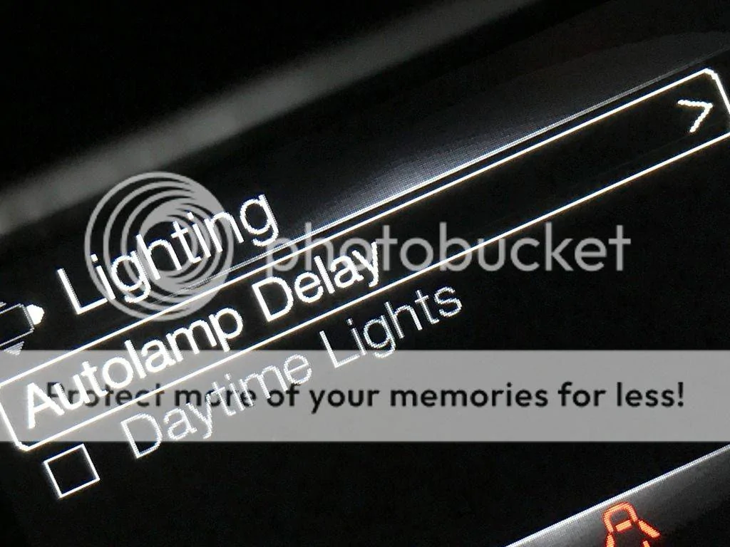

Has anyone had this happen? The Daytime Lamps setting under Lighting is grayed out and it is unchecked despite my DRLs working fine. I wouldn't mind the ability to disable/enable them from this menu.
Us spec don't have drls. Canada has fog lights as DRL and Export/EU has specific fog/drl lights setup with dedicated wiring for drl.
The US type signature led boards are wired as "constantly on parking lights" and are unable to be switched off with BCM config a dedicated way.
However, you can enable your IPC settings to switch on/off drl with a configured setup (drls: parking lights as drl, fogs, turn signals).
See https://s550.guru/shop/licht/tagfahrlicht-drl-configuration/

Right, I did enable the DRLs and set them to be the fog lights and I tested the other various lights and they all worked. The Daytime Lamps option is always gray on my dash and I can't scroll to it or select it. Even though it it unchecked, the fog lights still are DRLs
Check 726-16-02 for 0101.0101.01

That was it, thanks! Unfortunately, now the DRLs don't work regardless of the IPC setting. If I revert 726-16-02 back to stock, the DRLs work again but the IPC setting gets grayed out again.
set last byte in 726-21-01 to 1 so it looks like ****.****.01**
