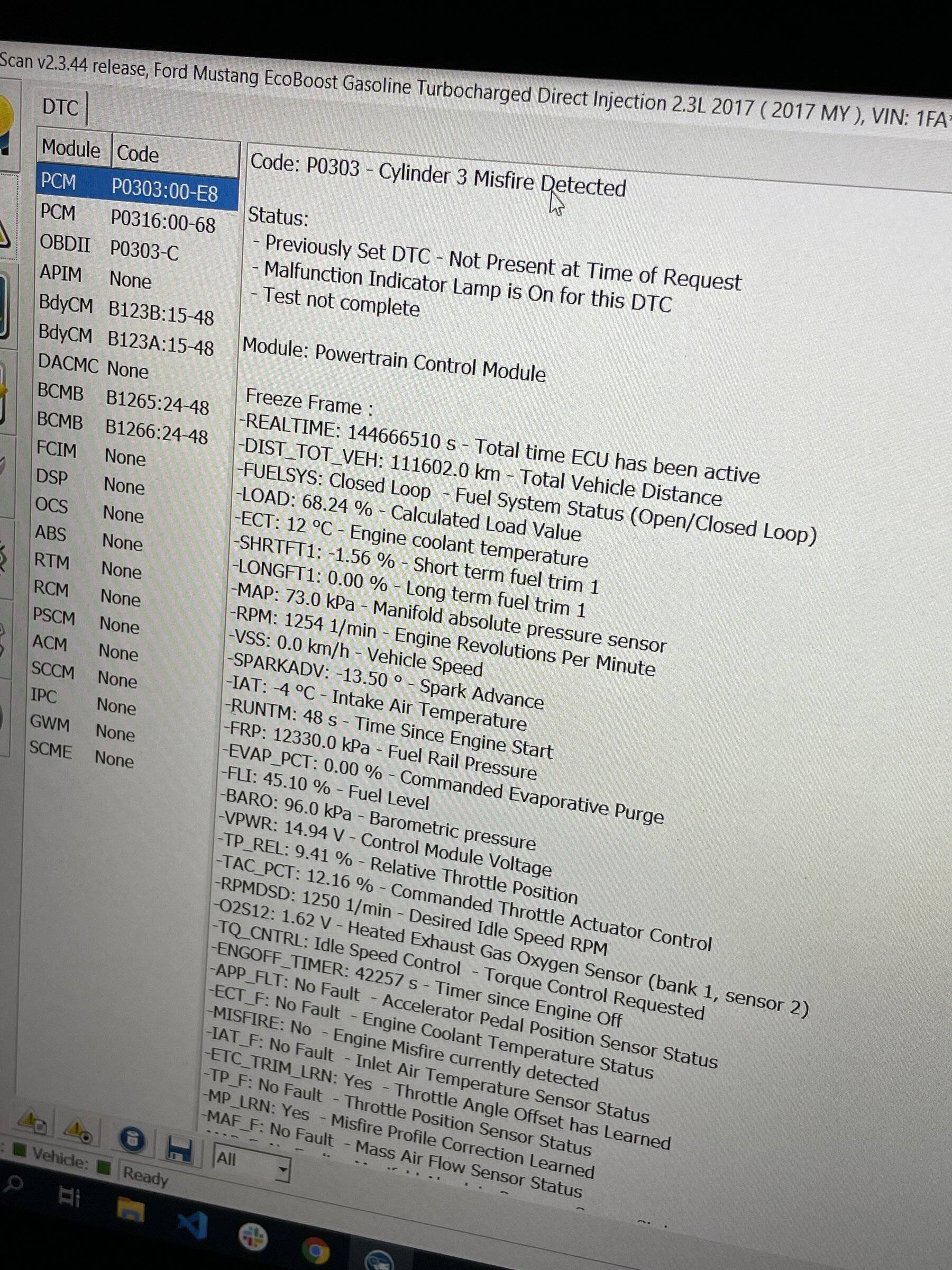

P0303 Misfire with P0316, Misfire occurred first 1000revs.

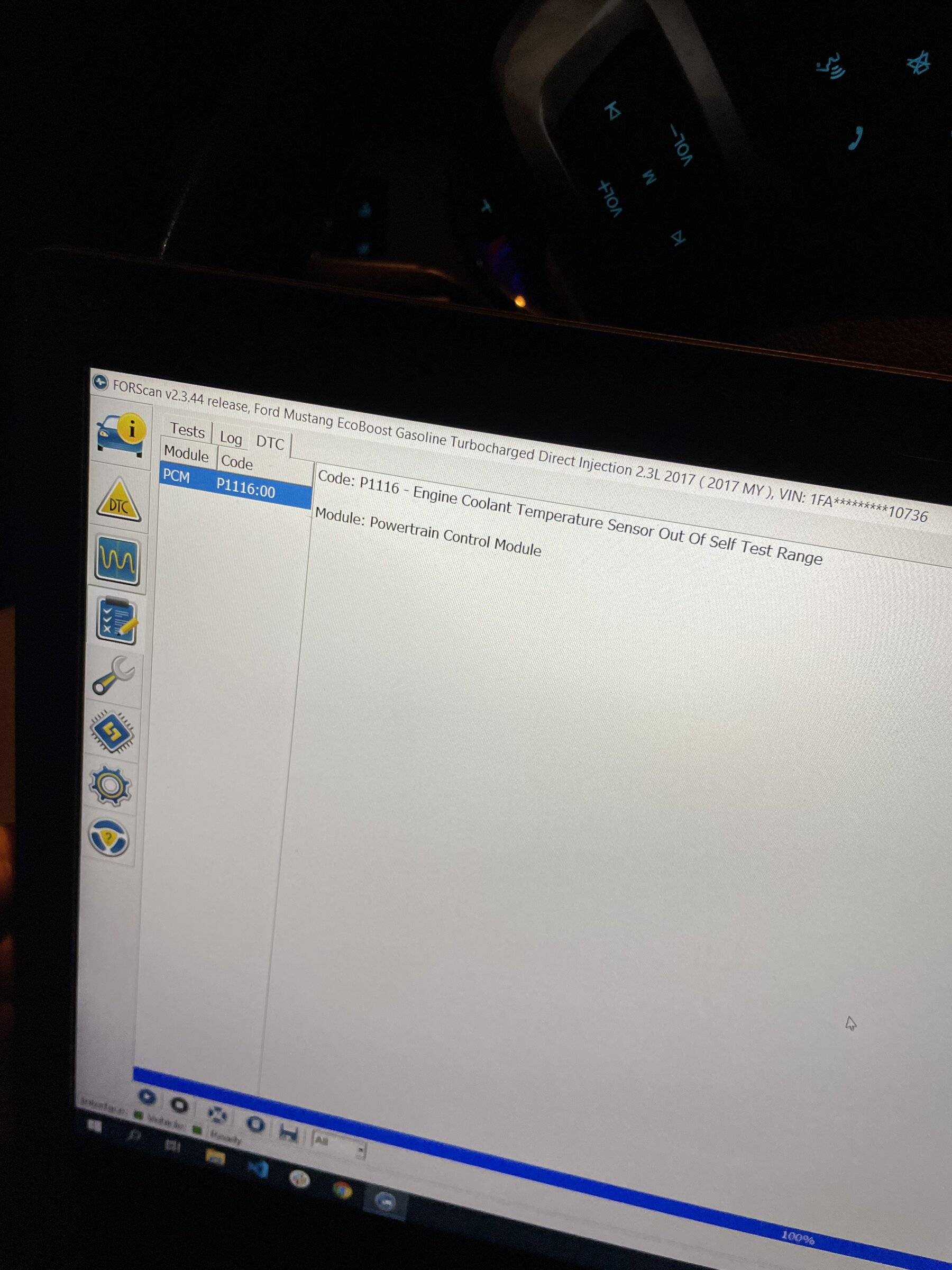

I ran engine on-demand test & get P1116 code ECT Sensor related.

Update: Head gasket blown, coonlant leaked into cylinder 3, spaces between all cylinder’s have fire traces. Maybe this helps someone in future.

Sorry, I was going to comment that based on your mileage it was most likely the issue. Cold start misfire that goes away is a pretty damning sign. Sorry about your luck, I wish this failure wasn't so common with these engines.
