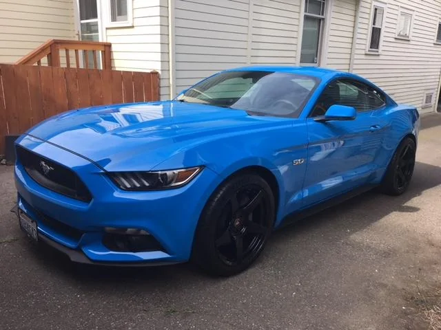

On the right wheel width and offset you can run a 285/35/19 front and 325/30/19 rear Michelin 4S
That's exactly the size of these tires on a factory suspension that I just put on yesterday evening. 19x10 with 35mm offset in the front. 19x11 with 50mm offset in the rear. I don't think a 305 would look as good, and you really do NOT notice the difference in aspect ratio between 35 and 30.
