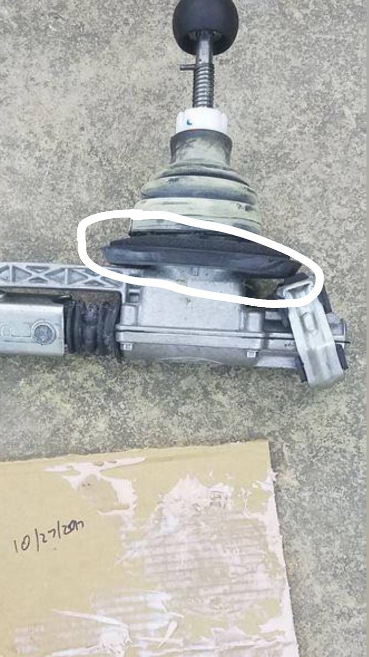

I recently installed a MGW shifter on my 2016 GT, I bought it used and it came with the upper rubber piece that isn’t circled, but didn’t have the lower piece that’s circled in the picture. Would I have to reuse that piece from my stock shifter, or does MGW send that with the shifter if ordered new?

That's the piece that some folks say is the hardest part of the install 😡, and IIRC a new one was in the box with my shifter. I think MGW's instructions/video even has tips on how to install it.

Yes, that boot was a PITA once the shifter was installed in the car. If I did it again, I'd install the shifter and verify the reverse lockout adjustment, then remove the shifter and install the boot on the bench.
The boot that MGW provides is the same that was used on the 2005-2010 Mustang GT.
I'm sure George at MGW would sell one by itself if it is needed.
