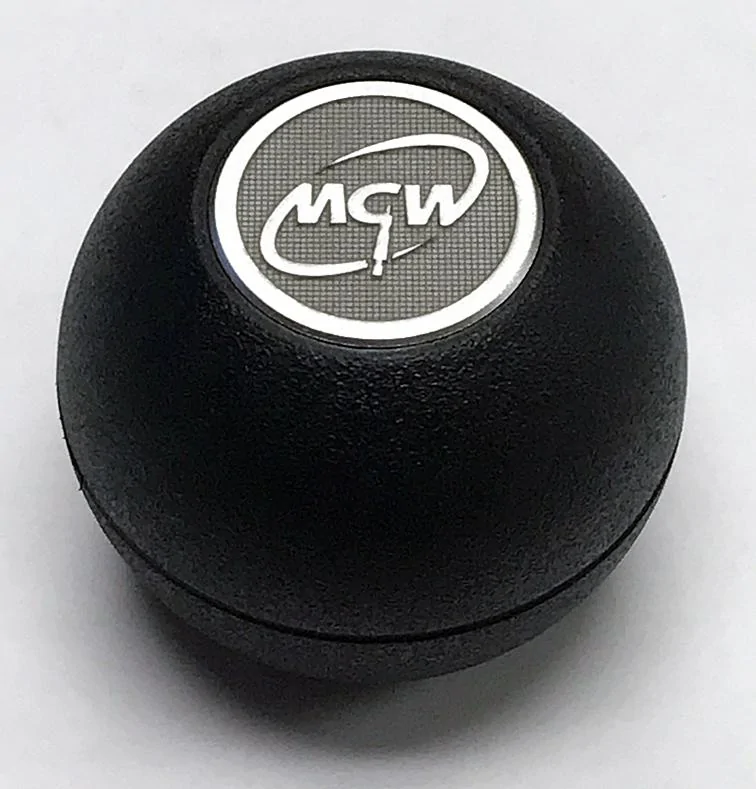

Do you guys no longer offer the gripper knobs? I didn't see them on the website. Im hoping you guys make a short version to go with the short handle. I should be placing my order next month.

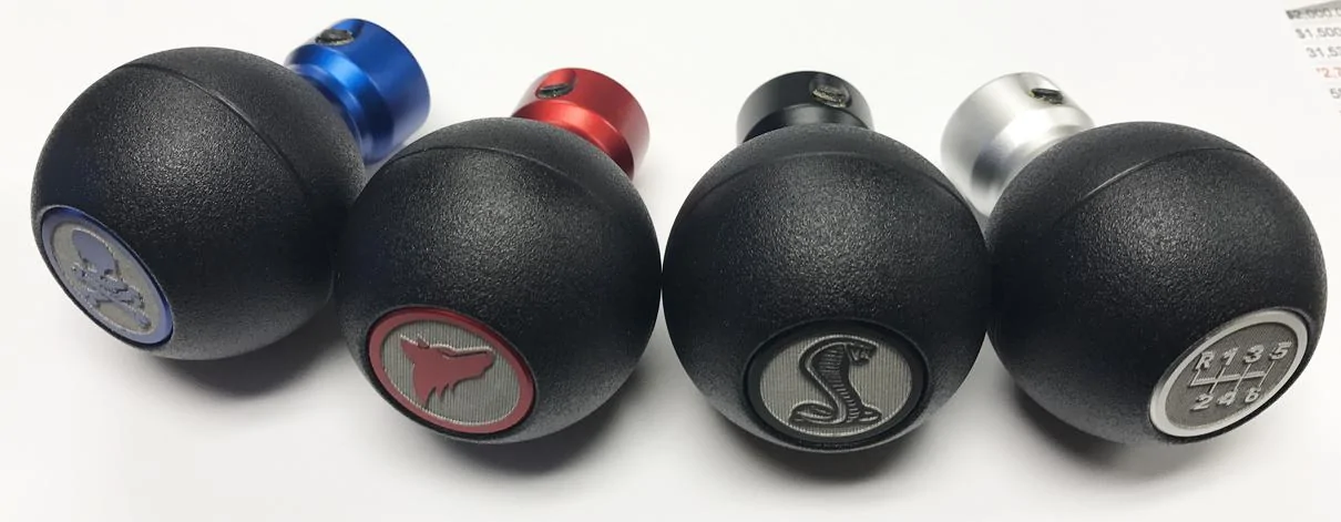

yes we removed them because we are making some new designs that are also short enough for the low handles and come in colors now!!
We will have them on the site soon. But you can call 706-793-1770 to order.

Thanks! I was starting to panic. In my opinion it is the only aftermarket knob that matches the interior and I thought I missed out. I can barely wait. I still love the feel of my MGW shifter I bought in 03!
